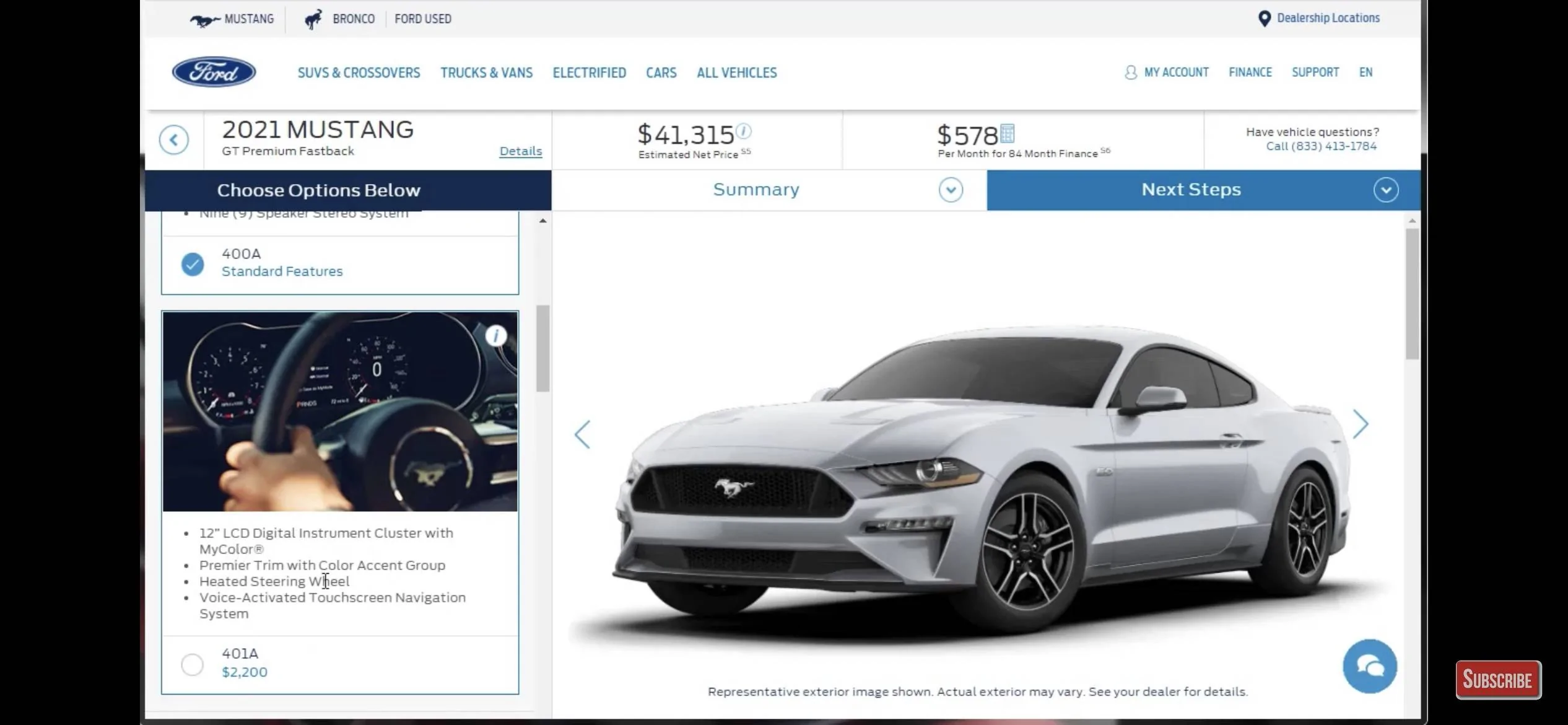

My 2021 401a GT/10speed auto car has analog gauges with centre digital mid. Also has the safe and smart with adaptive cruise, lane keep assist , auto wipers and high beams and forward emergency braking. Can't answer the retrofit question but the combo you want does exist. Digital dash is not my cup of tea either.
You must have a UNICORN. According to Ford the 12” Instrument Cluster was included in the 401A Package
You are correct. Mine is a 400a. Has leather with the cs interior suede and red stitching upgrade. Apologies.

GT Premium 400a package has analog dash. My 2022 GT Premium Coupe had 400a with analog dash. You can get 'Safe/Smart' pkg to add advanced cruise control if you want.
I didn't want the digital dash and I had no problem finding Mustangs with analog dash.
