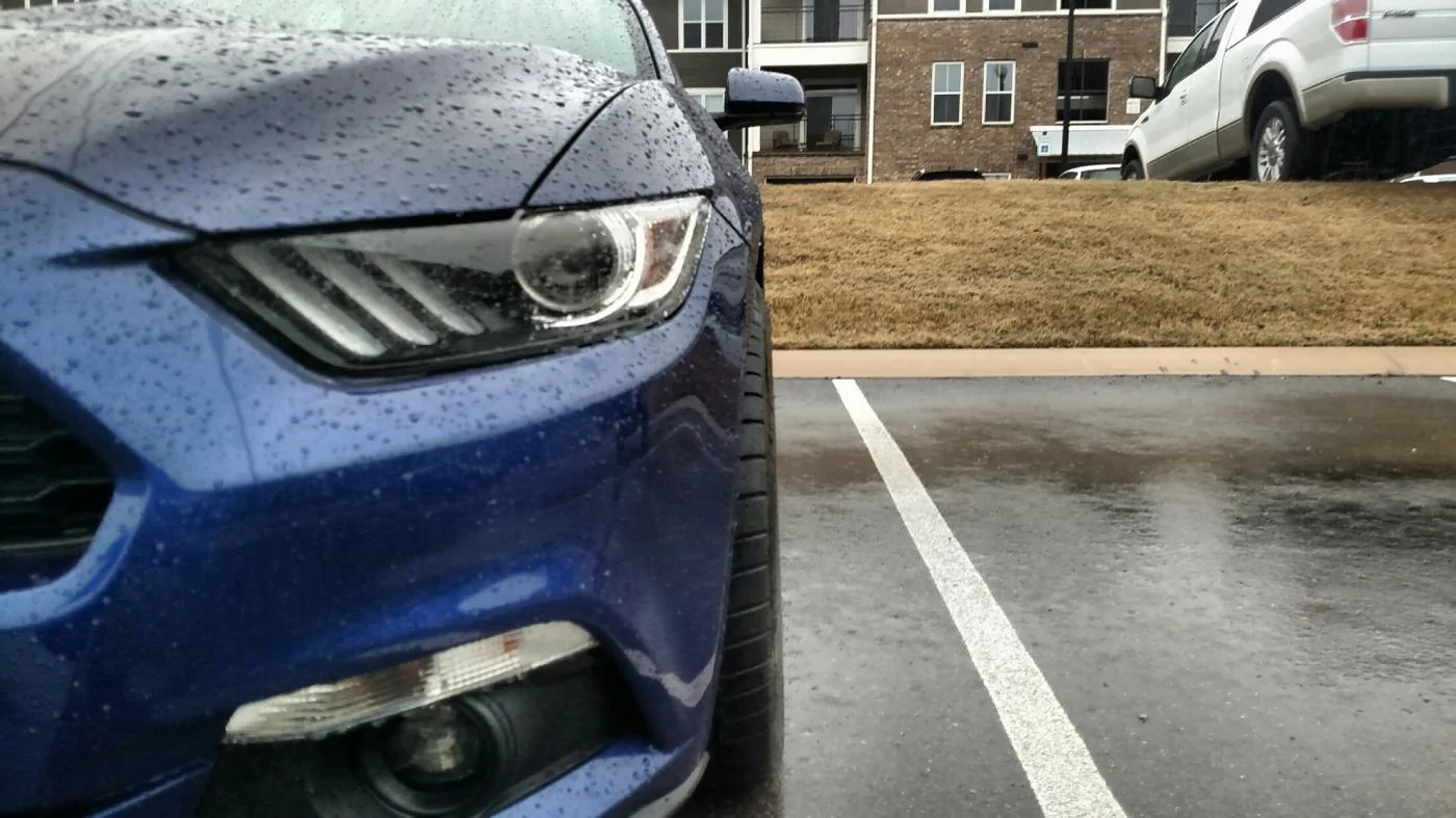

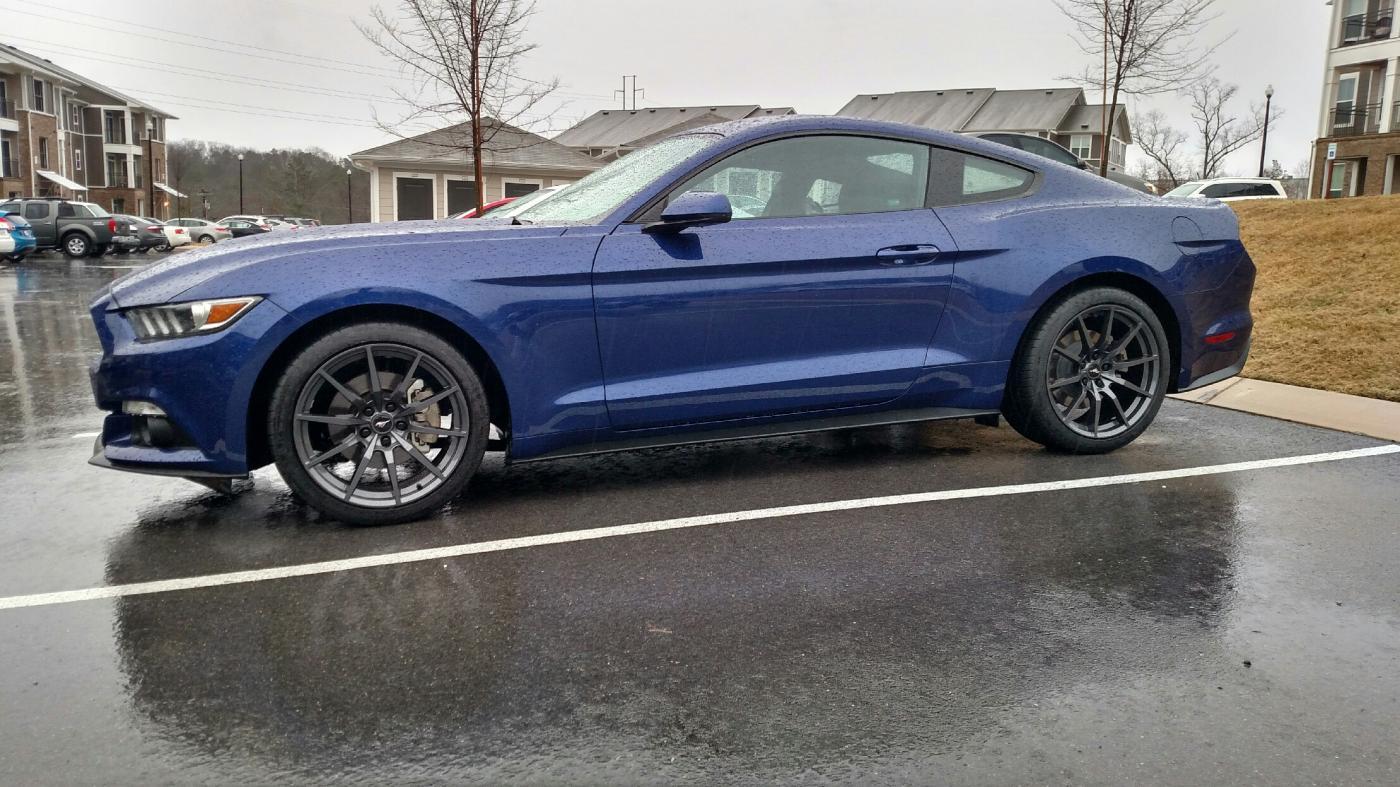

You will need new lugs (spline drive) and a 5mm spacer up front to clear the strut. BUT yes you can get them to fit. I just got 19x10 SVE GT350 a few days ago (Michelin Pilot Super Sport 275x35x19). Crappy/rainy pic below for reference.

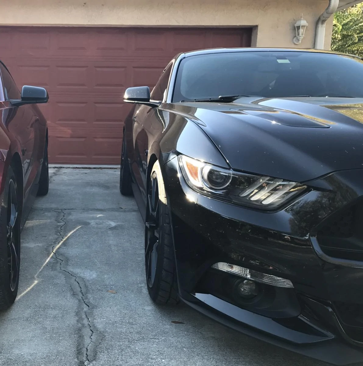

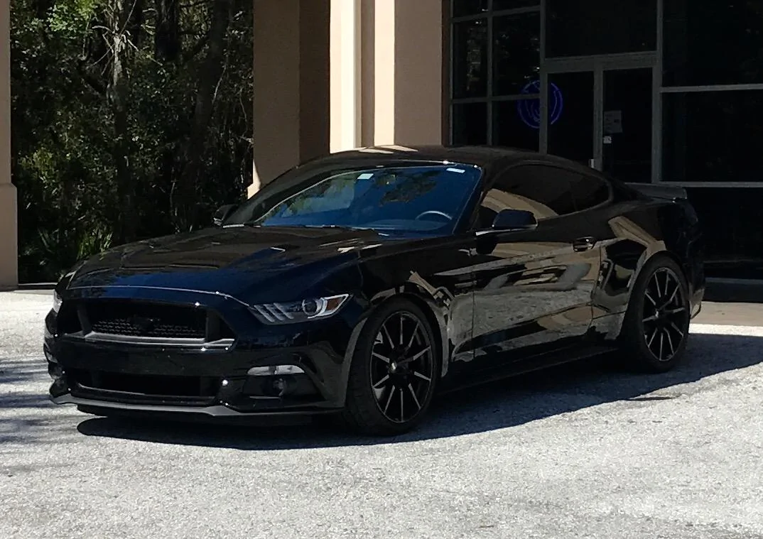

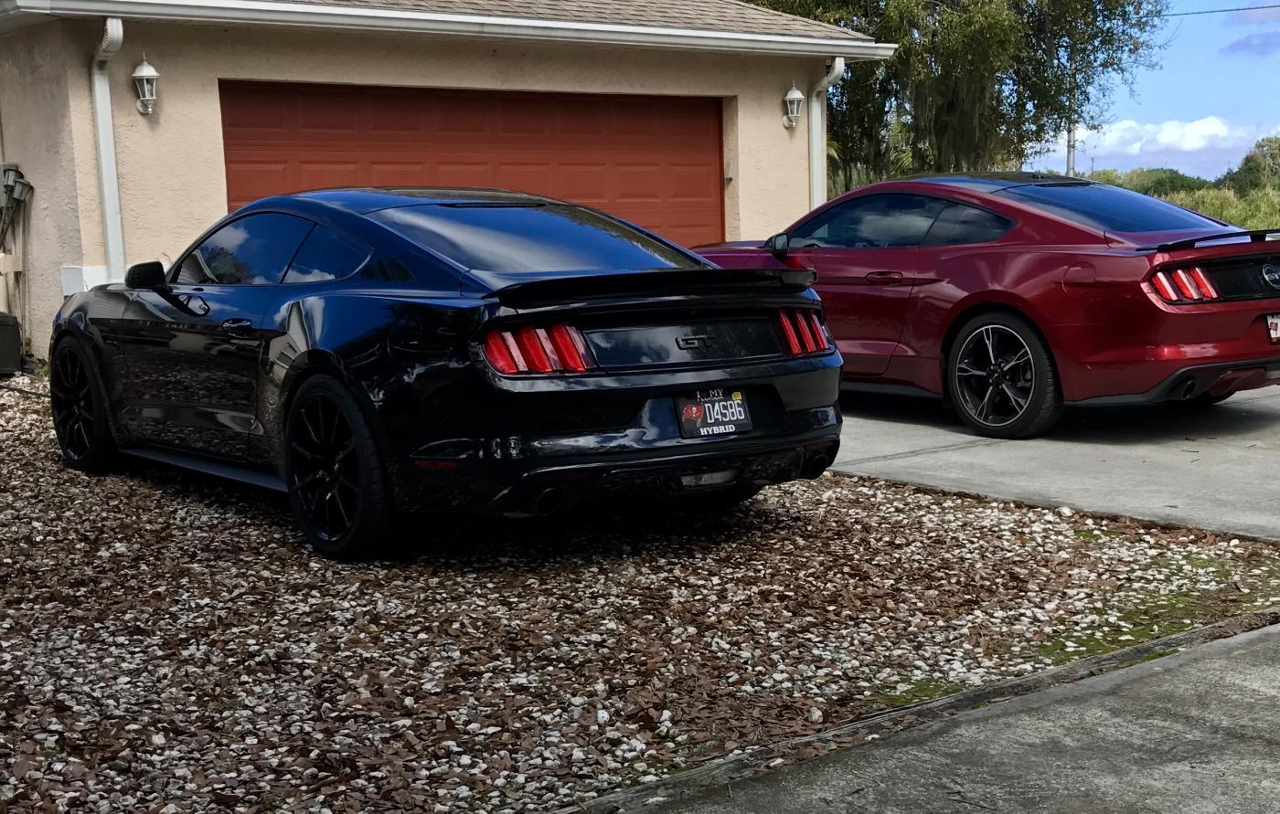

Posting some updated pics after having RTR Springs installed a couple of weeks ago
20x10 Front and Rear with a 3MM spacer in the front
275/35R20 Front and 295/35R20 Rear Nitto NT555 G2
RTR Springs claim to lower 1.1" Front and 0.8" Rear
