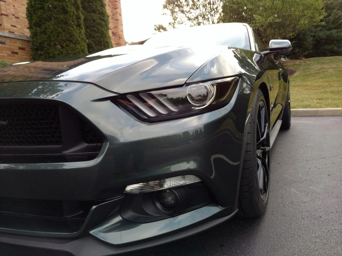

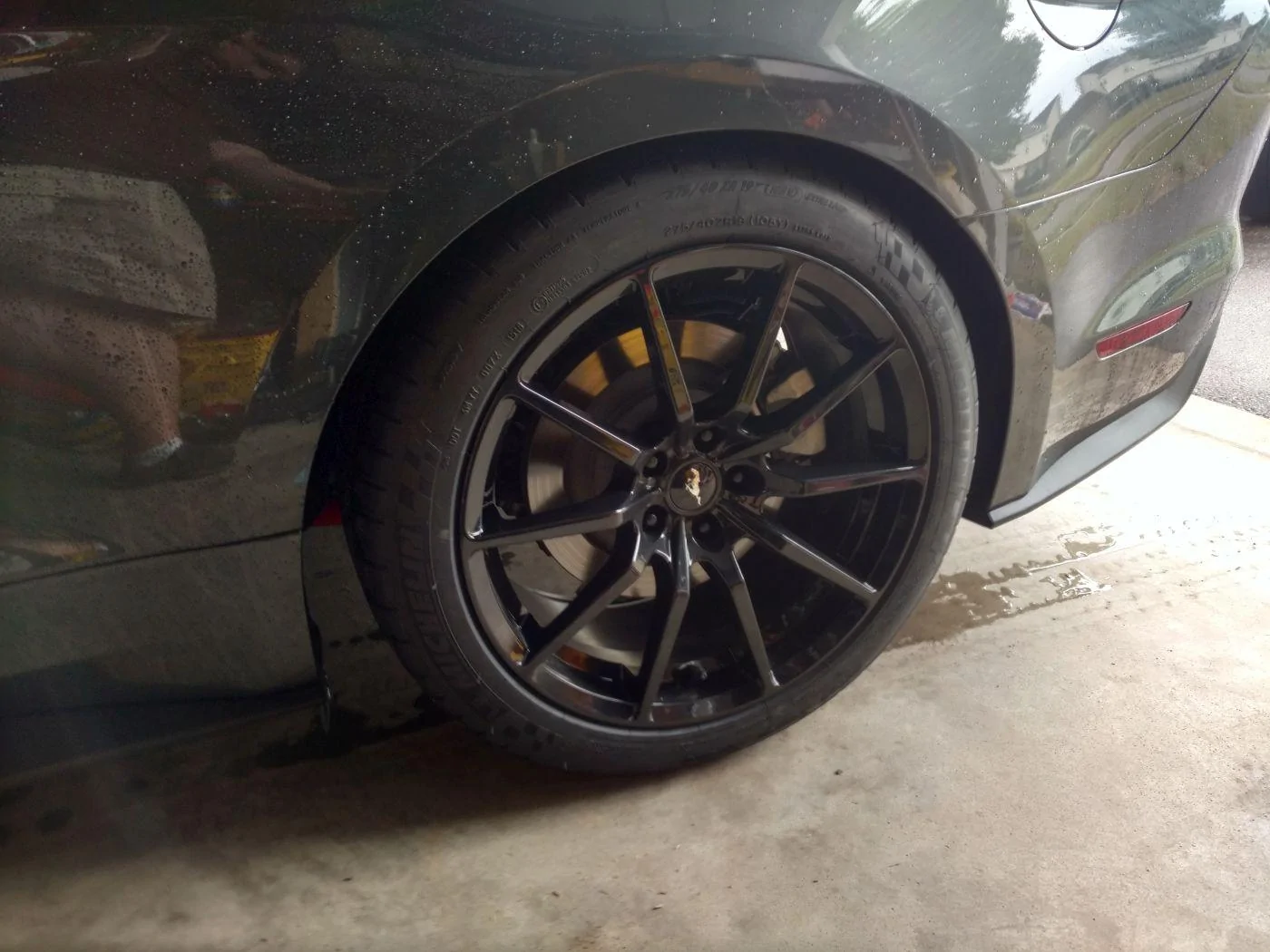

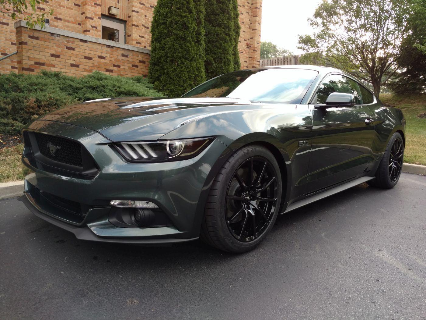

I just got my MRR M350s installed today.
I went 19x10 square with 275/40 MPSS. I'm on BMR SP089/SP082 springs. I could not have fit any wider of a tire in the front without hitting the strut. Clearance everywhere is still just fine.
I got caught in one of the worst downpours I've seen in years on the way home. :( Full pics coming later once the car is cleaned again.
