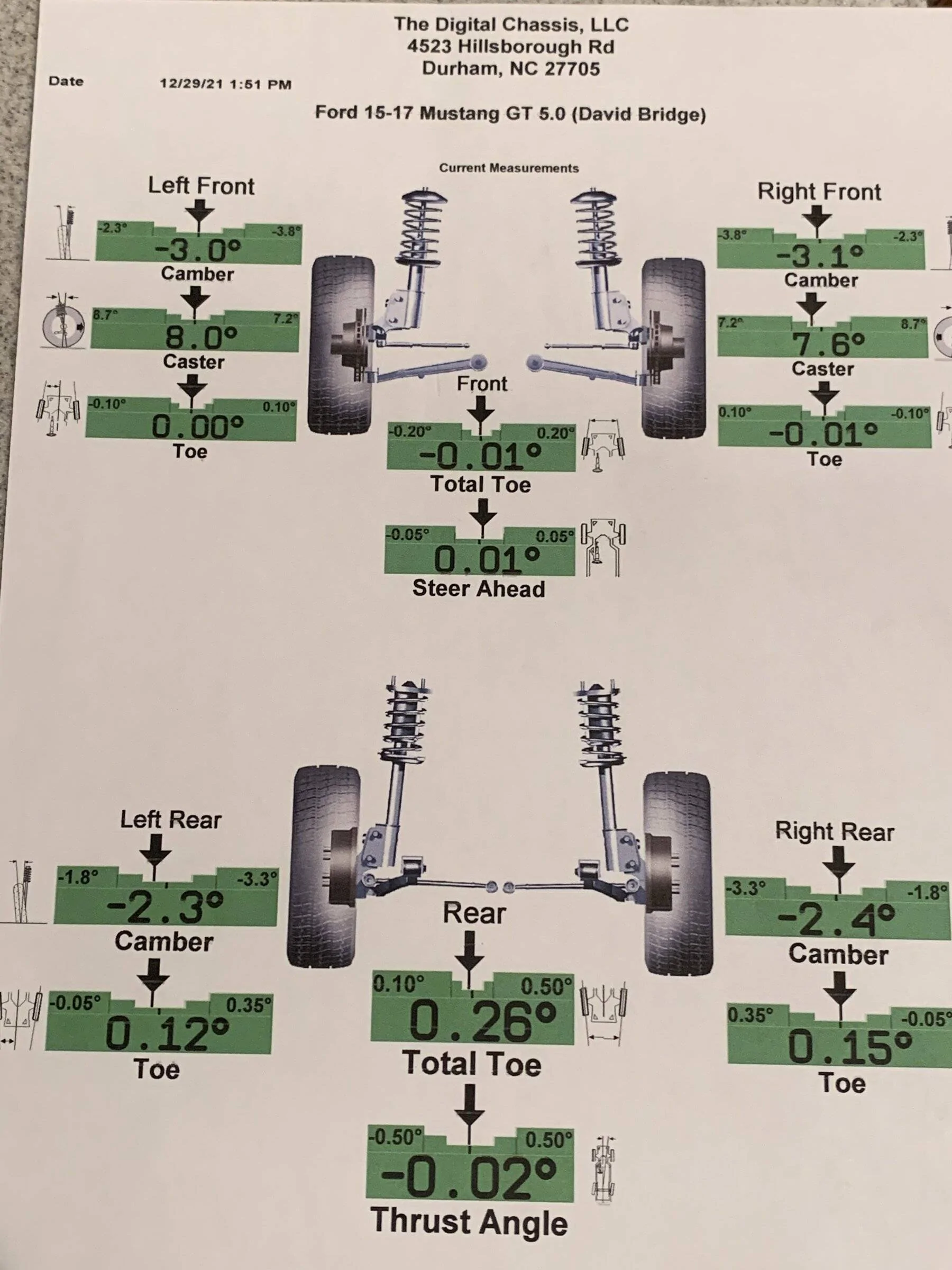

Just had my GT alignment setup.. (Aggressive)
A track focused car, although still road registered.. full adjustability front and rear achieved these numbers..
Some fast maybe stretching speed limit back road cornering on the way home from the shop, gave a precise turn in, great straight line braking from 1@@+ with no wagging tail.
Not on track until Feb at the earliest. It’s going to be a tough 6 wks.

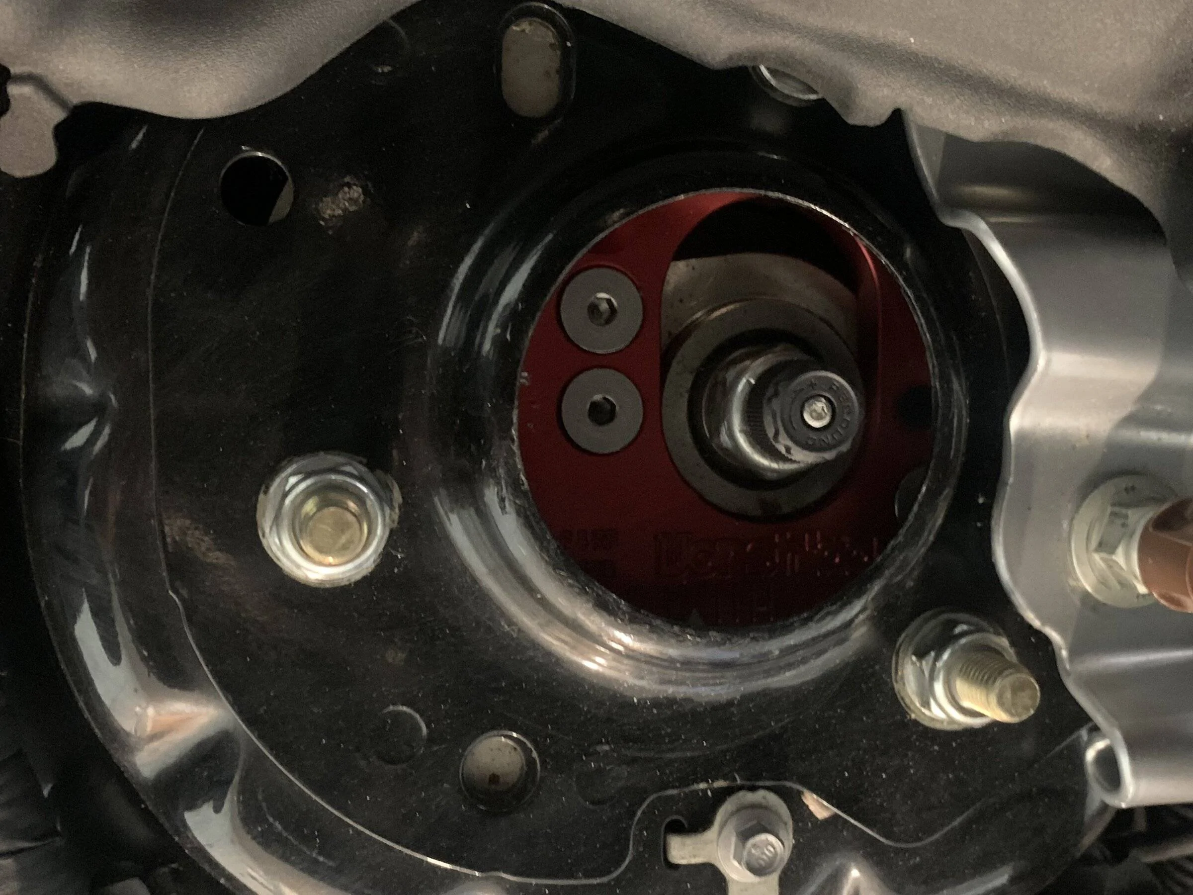

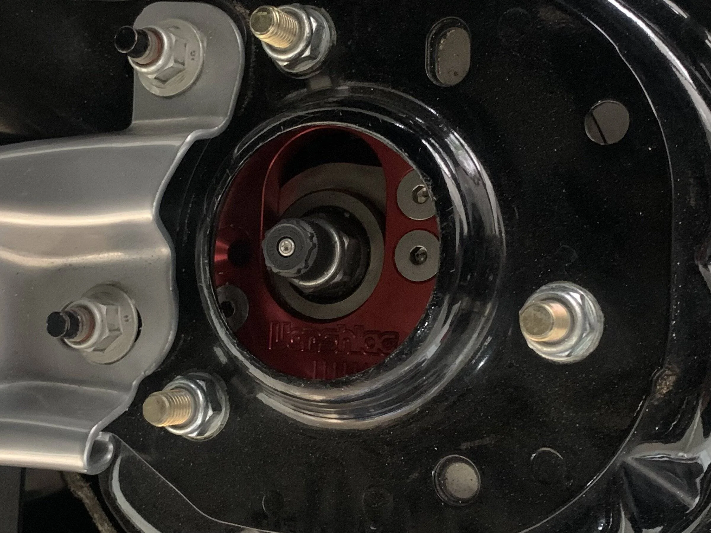

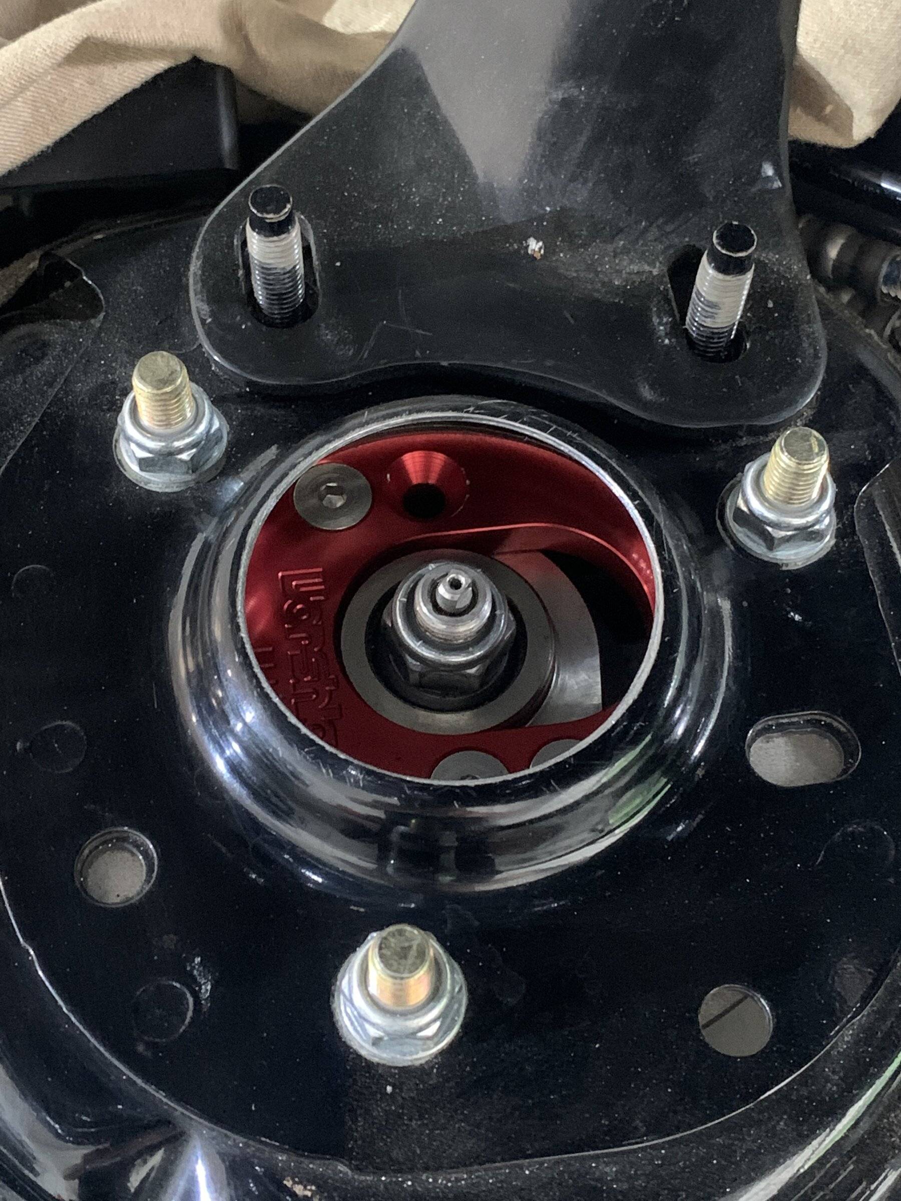

What camber plates are you running? Did you have to cut the strut tower tops for extra negative camber?
Bridgie
May 25, 2015
587
963
Raleigh, North Carolina
2015 GT fastback. PP, 50th trim, Black
I have Vorshlag plates with opened tower holes….

Are you at max neg camber? If not, what is your possible max neg?
Other question, how much toe change is there from stock (-1.5 neg) to -3.0? It should toe out a bit but wondering if you know how much (approx).
Bridgie
May 25, 2015
587
963
With the Vorshlag and SPC rear arms I hear -4 is possible.. but that’s a lot for a DE car. Maybe some extra one side for CW or CCW specific tracks..
Adjustments to get Zero Toe up front have been made during the alignment. I don’t have a preference of under or oversteer to which toe would contribute.
Now I have the laser alignment, I will calibrate my own alignment plates and devices to help with home setup.
A bit more room available..!

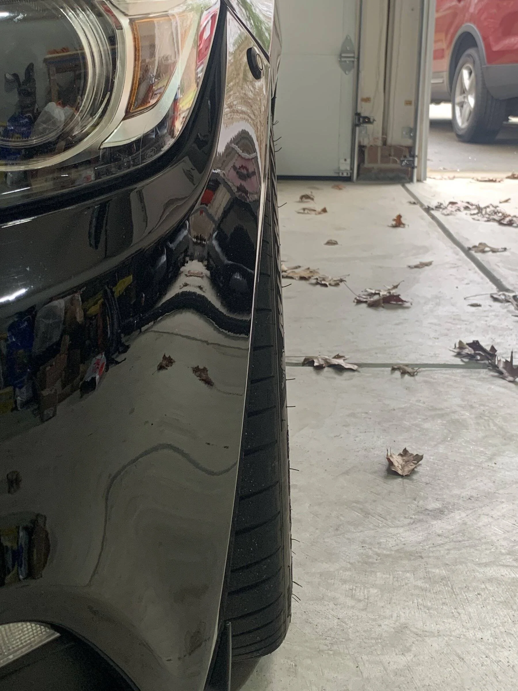

This is what -3 looks like.
