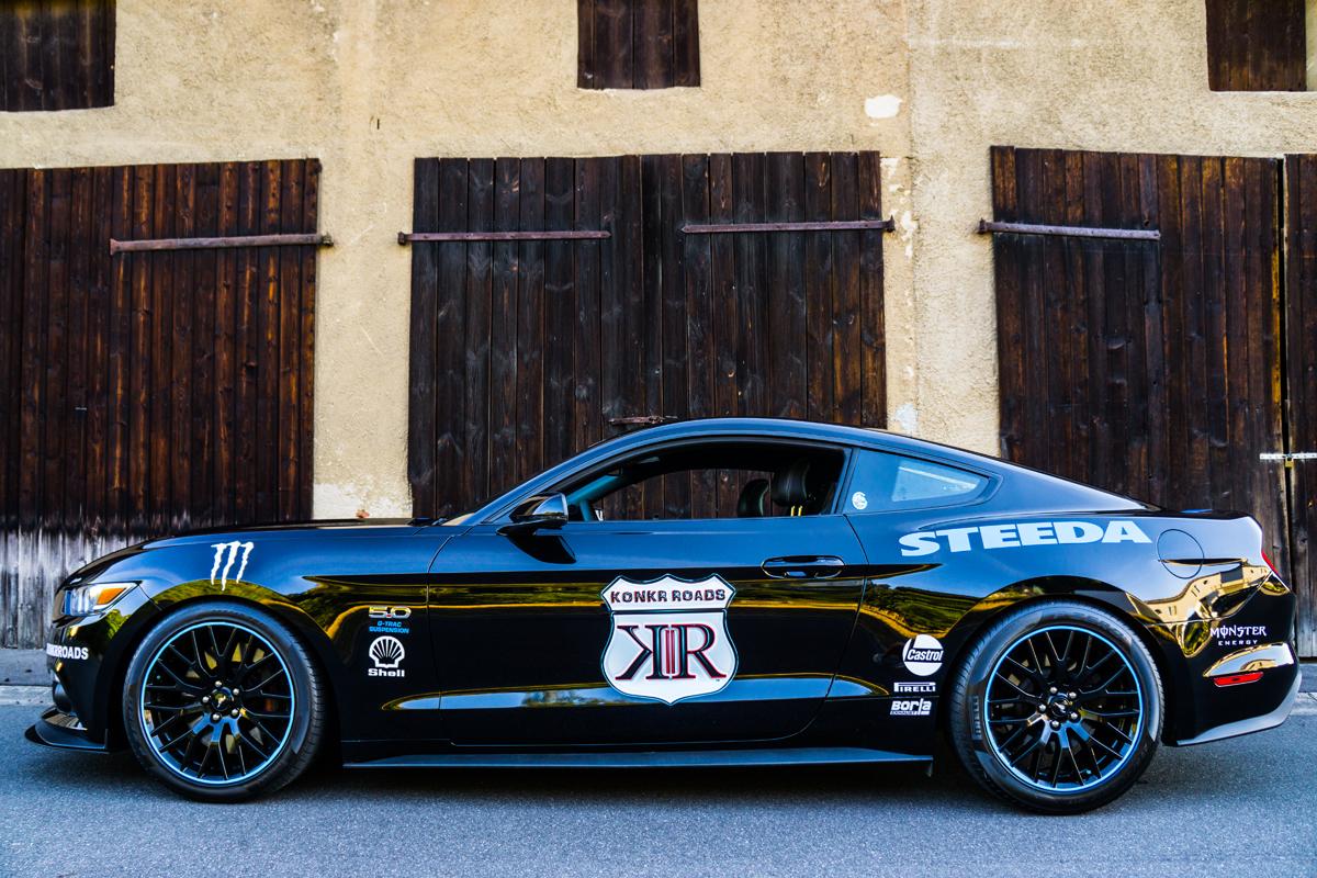

I've heard such good things about Koni over the years and so the fact that Steeda leverages a tuned version is encouraging. Not to put you out too much...would you happen to have a recommended list of parts based on my goals?
You can get all of the suspension/chassis stiffening parts in my signature for well less than $2500 as the value when choosing Steeda is incredible. You can call Steeda and have springs/dampers/camber plates all pre-assembled as well.
As far as springs, I love my Ultrailte Linears. The handling is aggressively refined (225 front/880 rear) and the "stance" is just where I like it (see below).
p.s. Whichever route you choose, invest the $20 on the Steeda clutch assist spring. Best mod I've done on any car, ever.
