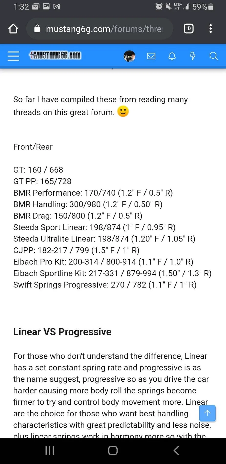

Bmr handling is 300 front 980 rear and do not drop the car an inch in rear
This is old data. BMR refreshed the handling springs years back. The front rate is now around 240, and the rear is still around 980. Drop is approximately 0.75 on all four. FWIW, I have rates at 225/880 and the rear is a bit much for me on the street.
