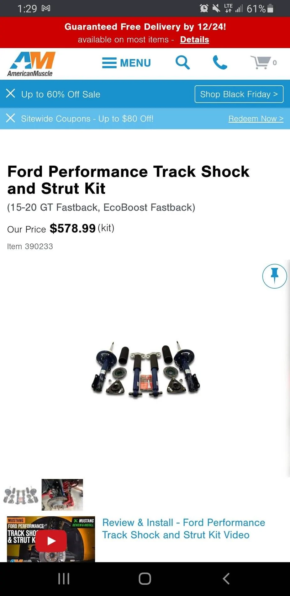

Why wait to upgrade dampers and pay for labor twice? The Steeda springs are GT350 rates in the front and halfway between GT and GT350 rates in the rear - they will be better matched to the Ford Performance dampers than the stock GT ones. BMR CB005 for the rear cradle and call it a day.
Ford Performance dampers would put me over budget. I thought Steeda minimum drop springs are better matched to the Pro-Action nonadjustables, plus they're on sale!

Ford performance track struts and shocks, with bmr handling springs is a tried and true combination, and under your budget. Should be right around 800-900ish. Id spend the little extra and get cb762 (200ish) while you are at it. These would all be things they can do while they are in there. You dont want to upgrade the springs without doing the shocks/struts, and you dont want to pay for labor twice. The cb762 will help stiffen up the rear irs and help with 90% of wheel hop. If you cant afford the 200 for bmr cb762, maybe get bmr cb010..its about $100, or do what @K4fxd earlier mentioned and get the front braces. You seem to be thinking he is talking about the strut tower brace..but he is not. Read the post he linked and you will see what he means. The parts he means are cheap, and connect from the firewall to strut tower, as well as under the car. Or spend 100$ more than ford performance track stuff and get bilstein b6 shocks and struts. Those are around 600-700..plus bmr springs will be right around 1k.
These things should be under 1k. Then add install price, and it will easily be installed in a day.
