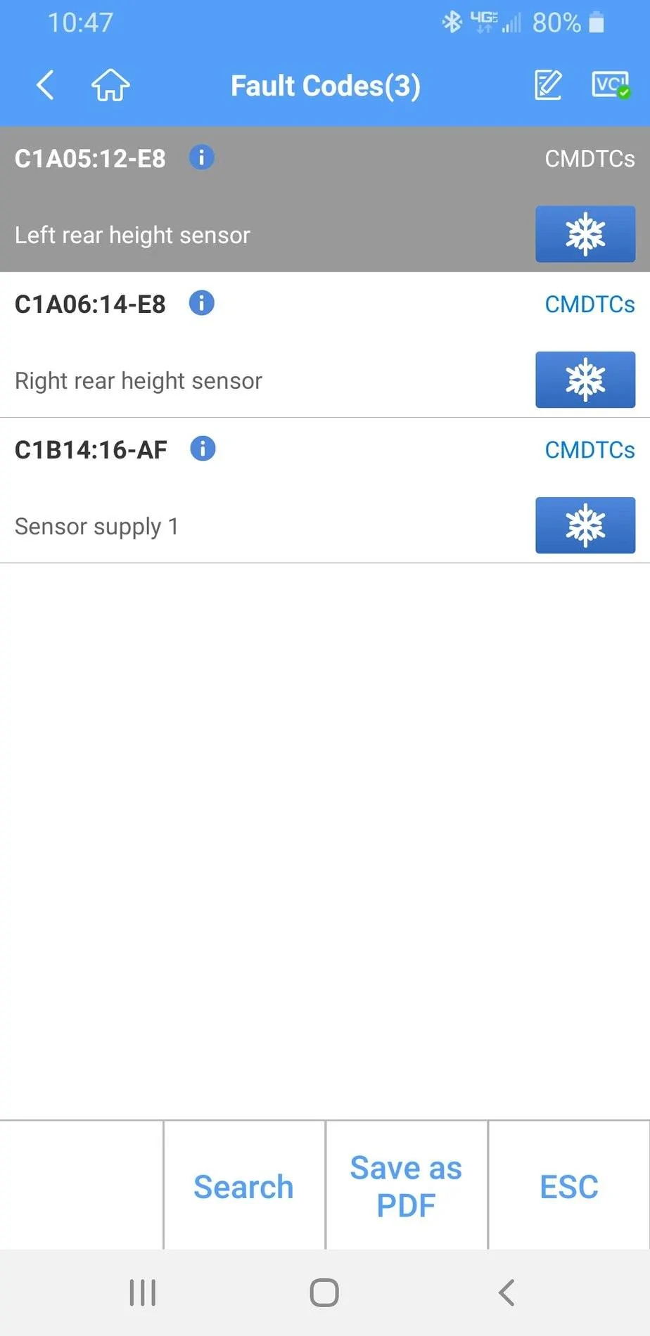

Has anyone been able to re Cal your ride height.?
I just got this error.

Yes, forscan works like a charm for recalibrating ride height. That does not mean that is going to fix this error though…

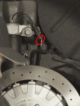

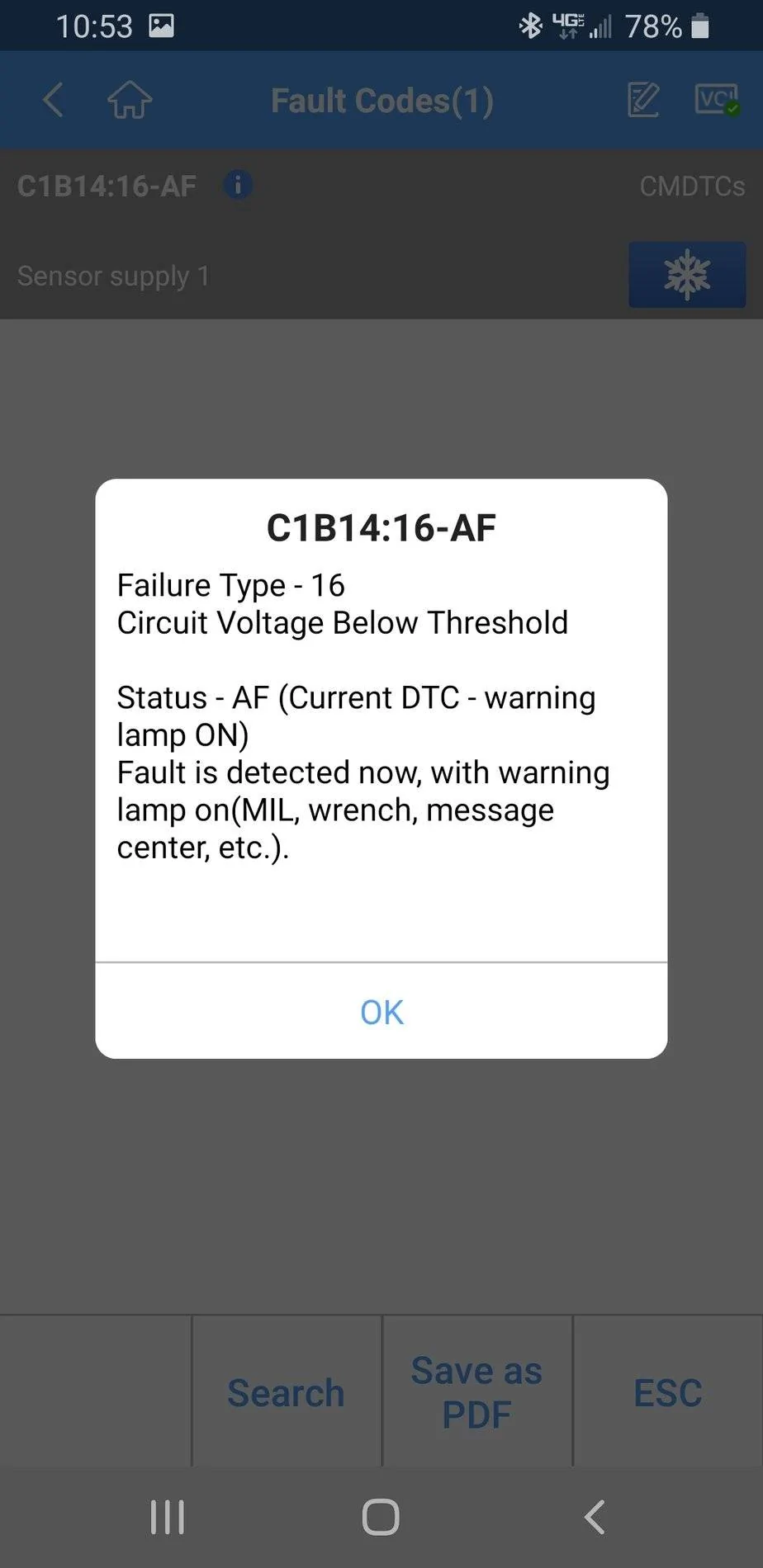

As of now, it's showing a error in each rear height sensor and a sensor supply fault. I cleared them to see if they all keep showing but now it only shows the sensor supply fault. So possibly a short somewhere in the harness, I'm assuming the fault means no power is going to the rear sensors. Can't find any pinches in the harness anywhere or anything unplugged. So gonna keep following the harness
