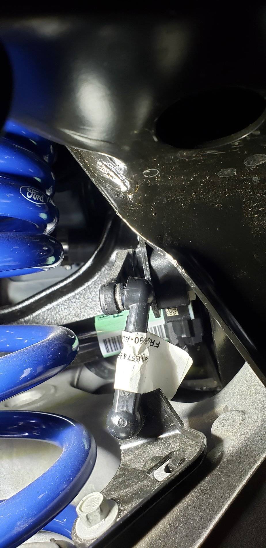

I ordered an obd hookup so I can use forscan, waiting on that to come in so I can pinpoint the issue. The only thing that caught my eye was one of the rear ride height sensors seems to be off pivot point, maybe I damaged it while doing the springs but I dont see how I would come into contact with them at all or even cause it to bend
Can you get that sensor to seat correctly? I guess it wouldn’t matter how it happened but it seems to me like an obvious culprit at this time...
The arm is seated fine, and everything is in tact, it just seems like the angle of pivot is off, BUT unless the control arm was physically removed while the rods were still attached, theres no way to bend that rods like that out of alignment because the whole unit is one piece

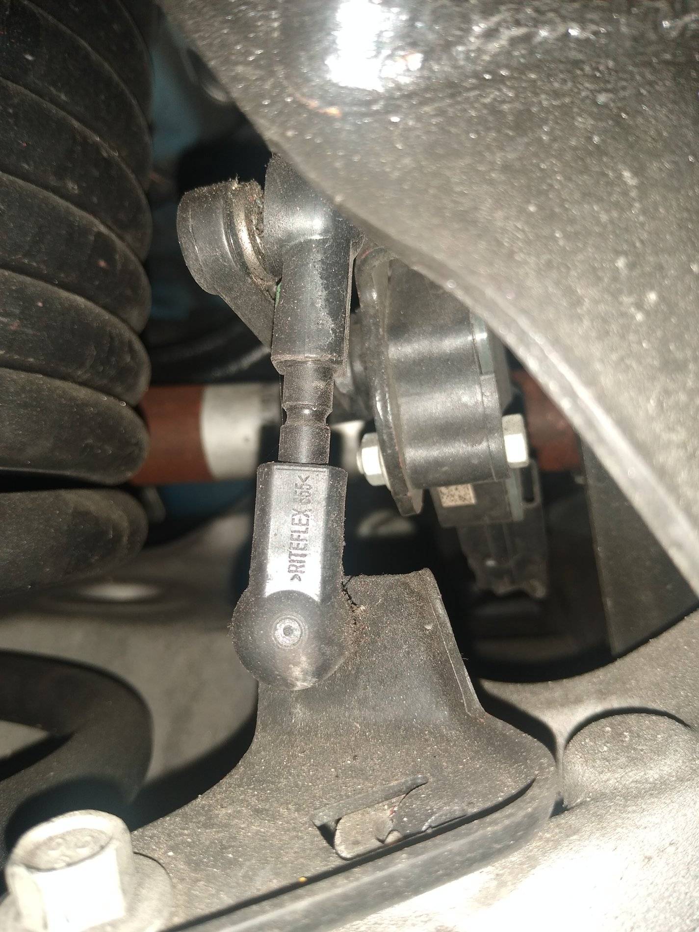

This how mine is with the car on the ground. Picture was taken from behind the exhaust on driver side.
Check if the harness on the rear shocks did not get pinched on the 18mm shock mount bolt. I managed to do that once and had to fix my wires.
Looks identical to mine, so it's just the angle of the arms then. I'll recheck the wiring
