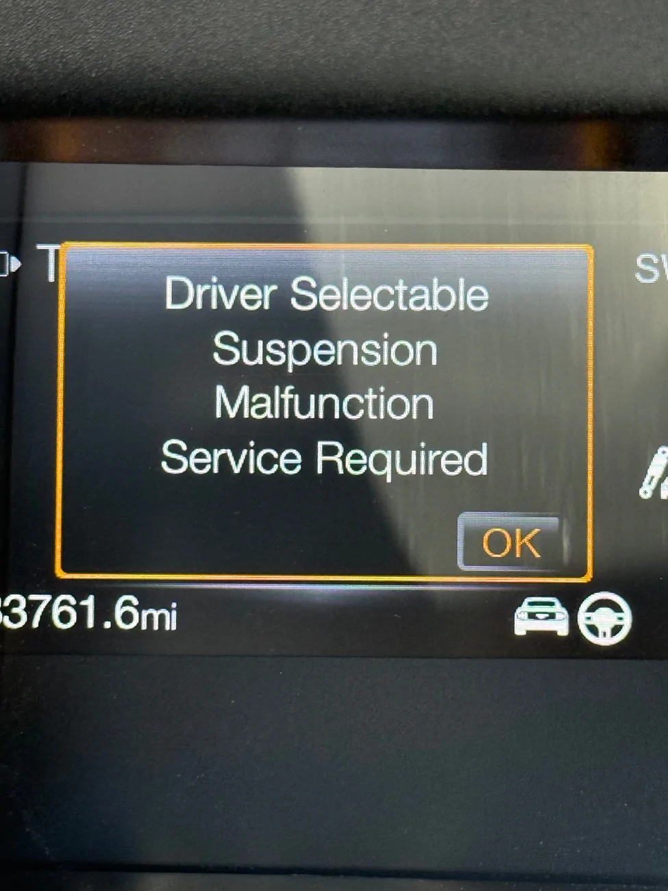

Anyone have to deal with one of these? Hopefully just a loose connector. Car’s been worry free for 6 years (knock on wood) except active exhaust issues and now this.

You'll need the code read from the VDM (Vehicle Dynamics Module) to find out what the problem is. Most likely it's a problem with one of the ride height sensors. I had to replace one last year after I started getting an intermittent error like that.
