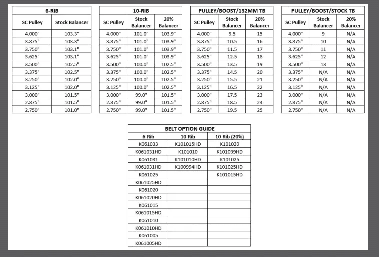

But again, you're comparing apples and oranges. Most of those dyno sheets are 3.875 pulley.
Pulley for pulley, the Whipple makes just as much torque down low.
What is the boost level for 3.875 pulley with a stock crank damper?
Edit:. We aren't comparing pulleys we are comparing boost levels... That's like saying we comparing a single turbo vs twin turbos one @11# and one @16#.... It's the boost levels that need to be the same screw the pulleys.
illtal
Nov 16, 2018
2,134
1,051
2018 Mustang GT
So a Whipple gen5 with a 3.25" can be up to 16 pounds of boost with a stock crank damper.
That's drastically different than 11# with a 3.25 pulley.
Boost for boost is a much more problematic test and you know it. There's way too much error in measurement and approach. Again, I've seen NOTHING from a scientific or engineering perspective that would suggest that a 3 liter PD blower (of any type) would produce less torque than a 2.65 liter PD blower (of any type) at the same boost levels.
