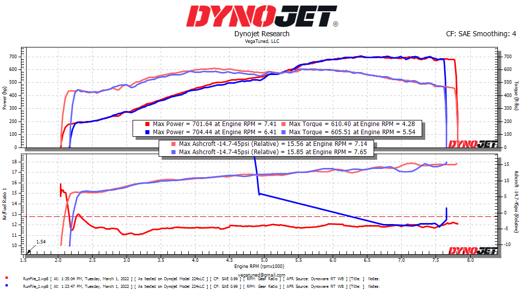

Yeah, I'm not convinced of that. It's all in the setup. My 3.0 makes over 620 rwtq (and 16 lbs) at 2850 rpm and makes almost 900 rwtq at peak (at 19 lbs). I'm skeptical a smaller PD blower would make more than that, and roots rotors vs twin screw at that.
At the lower power levels, the differences are not meaningful, but the idea that a smaller blower would make more power or torque is a bit of rose glasses/myth I think. The TVS may "SEEM" to punch more but that's probably because it falls off more up top.
Rotor design gets a vote, but it's a stretch to think that a smaller displacement would make more steam anywhere when given apples/apples comparison.
Here's a sheet, at lower rpms there is more available torque on a TVS blower than with the Whipple/centric setups, but when the torque does fall off it is still at 80% of the max towards the redline. 605 torque peak but ~ 500 where the run was shut down. That's 83% or max torque still available.
Edit. This is a 93/meth graph. 3.25" pulley, 11psi steady on the boost gauge.
The AFR line is messed up on the first run due to the active exhaust. The operator put it in the wrong top.
I haz several questions. 1) Are these two runs two different blowers? Cause the only way to back up that claim would be to install the two different blower systems and run the same pulley on them and see the curve each one creates. This appears to me to simply be the same blower on two different pulls. There's nothing here to methodically prove or suggest that the 3.0 wouldn't make those same torque values in the lower rpm range (on a 3.25 pulley).
