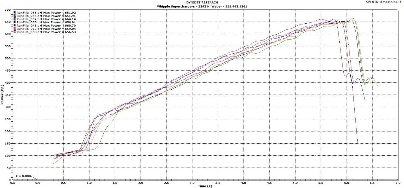

Sorry, your kit does not make 709RWHP out of the box, that's custom tuning and pulley changes.... If it did, you would advertise that. You advertise 550rwhp. Were making 730-750rwhp with 13psi. I agree the PC kit and our kit can make pretty equal power at equal boost, but be careful when your trying to slam something you know little about, as you stated, you don't "follow" us.
Our kit out of the box makes 650+rwhp, no custom tuning, no exhaust changes, no pulley changes, zero mods. Bolt on, drive away. Your stage 1 kit makes 550 (per your info) out of the box. If you want to custom tune, LT's, exhaust then sky is the limit..... We've got one that just made 723rwhp on 93 octane and LT, same everything as our knock logic is far superior and can optimize spark.
Also, the dual fans do not make more power, they hold power more consistent. You know, like how the air to air lacks from poor efficiency with limited airflow, or severely limited to ambient temp. The same concept with the LTR on a air to water, need airflow to maintain. The difference is the water takes much longer to warm up and the fans hold the temp cooler longer during aggressive driving.
As for power numbers, American Muscle, 687rwhp (on 93, not 116). Lethal 7...rwhp (article coming next week). When you run 116, power is closer to 785 as you can optimize spark with the same boost. Do you know what timing that is? We do, its not MBT.
Now as for "glory runs". Get over yourself and your crusade to persuade some from reality.....PC makes a nice system and we respect that, but your little rant has little merit.
