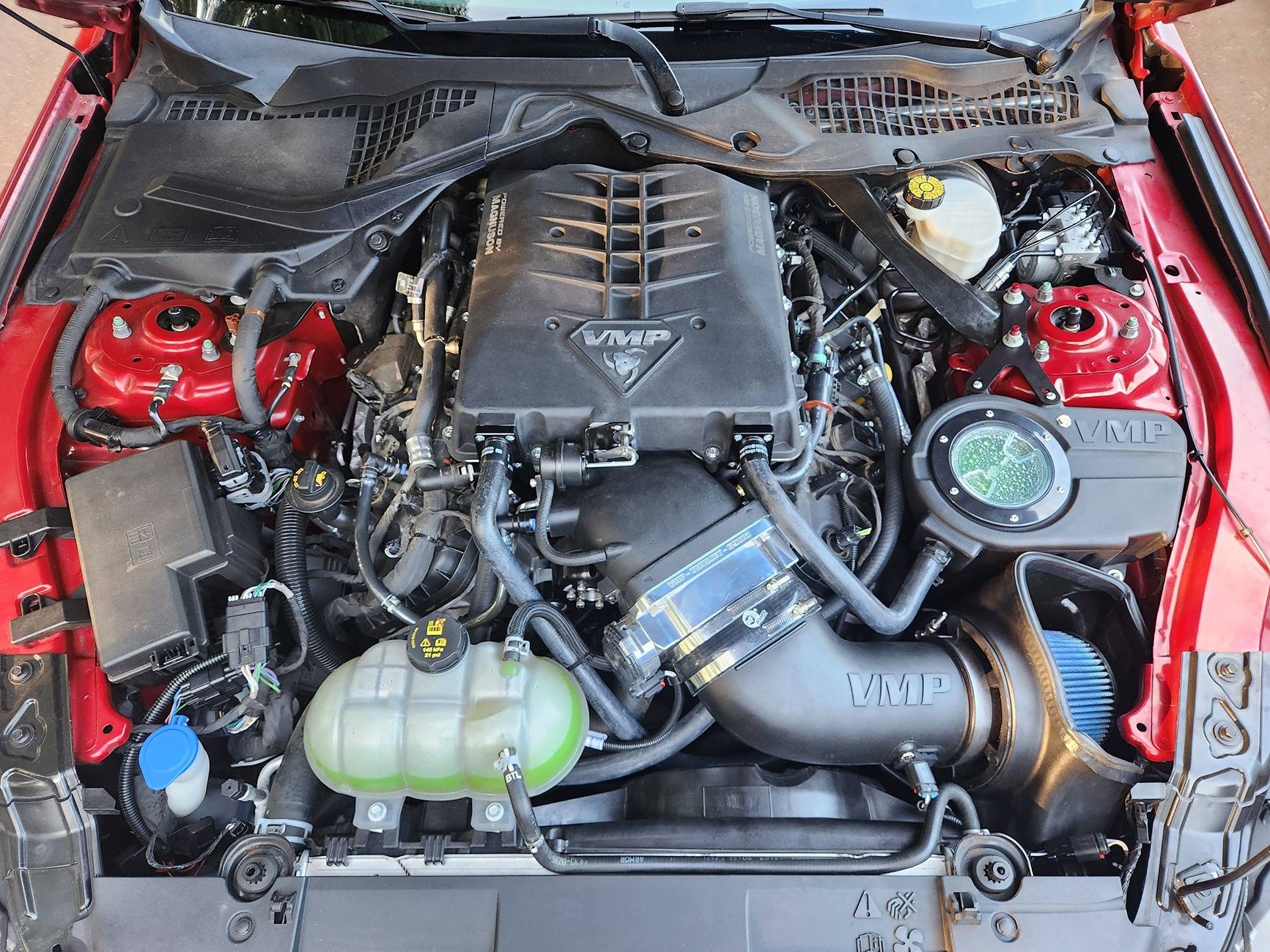

Why a tuner kit? It sounds like you're going to buy all the other pieces anyway. Why not get a complete kit? I was able to get a VMP Odin kit on sale. It comes with everything you need. The GT500 injectors, tune, tuning device, BAP, heat exchanger, etc. It's turn key. Initially it seems more expensive but by the time you piece it all together you're going to spend the same amount. The TVS rotors are what the GT500 comes with. Tried and true internals. Are you set on a Centri style vs Roots? Also I'm stock OPG & Sprocket. I was told I don't need them unless I plan on raising the red line above stock and bouncing off of it all the time. This kit should get you to your 700 WHP mark on 93. I'm in Oregon and we have 92 for some reason.
