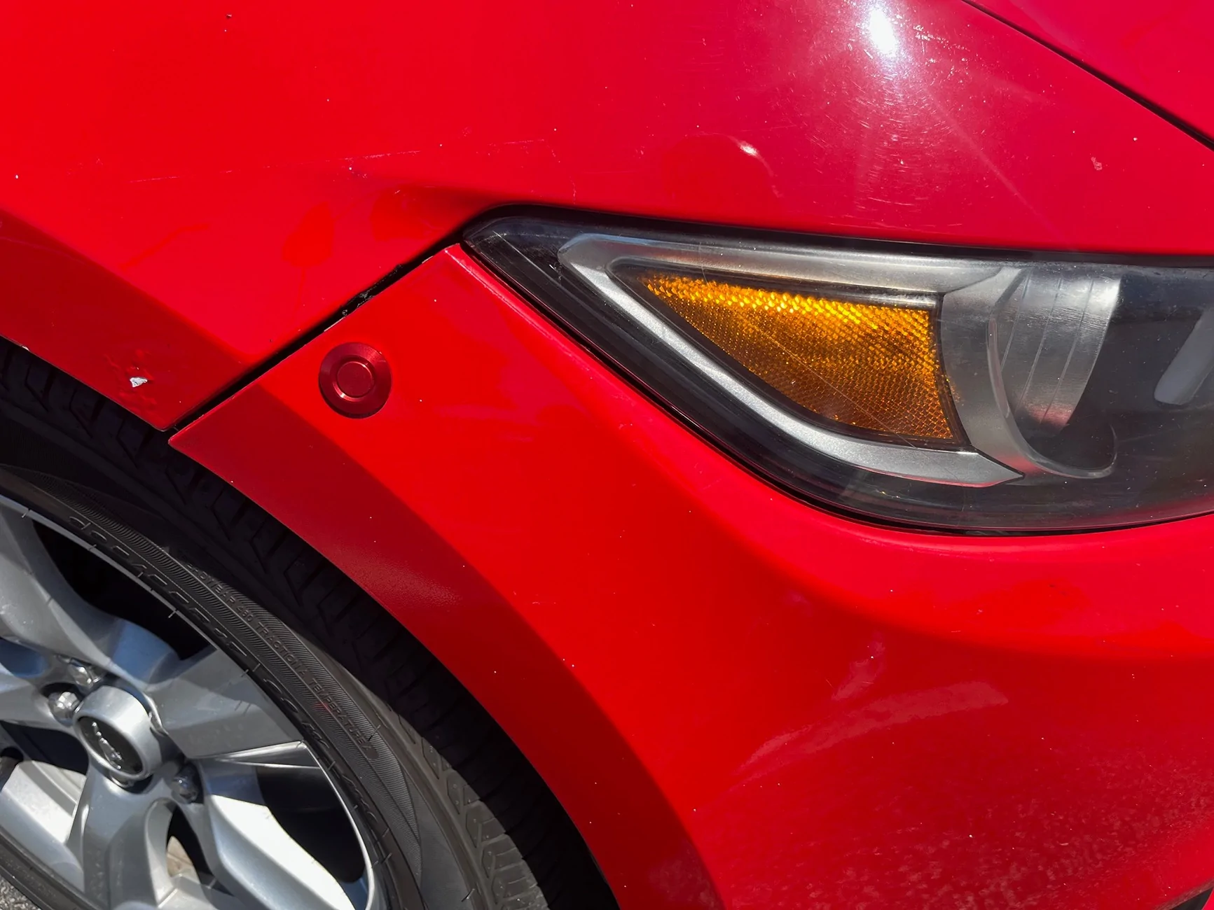

So the passenger side bumper cover where it meets the fender over wheel well has pulled about at the mount. Looks like it has done so in the past to previous owners and some kind of thick black adhesive was attempted. What kind of glue/adhesive needs to be used to reconnect the mount part to the bumper cover part (polycarbonate I think)?

There is no adhesive that is supposed to go there. The bumper cover doesn't use adhesive anywhere that I'm aware of. Where I believe you are asking about the bumper is held on with clips that are built into the cover and snap into a mounting plate.
If someone previously used adhesive then it was a hack because they didn't know how, couldn't make it work or something underlying is broken.
I'd suggest searching YouTube for videos on bumper removal and replacement for an idea of how it works. If it looks to be beyond what you are comfortable with consider taking it to a body shop.

dburgjohn
dburgjohn
Aug 14, 2025
50
30
Dyersburg, TN 38024
John
2016 Mustang Coupe V6
Most expensive dry wall screws ever... 🙈
...do a proper fix or leave it like it is.
I have another vehicle that is 34 years old. It has all correct parts and fasteners. The mostly aluminum suspension has been deburred and polished. Every surface is cleaner that the plates most people eat dinner on. It never sees a rainy day and lives in it's own garage bay (separated from the other bays by a wall and door to keep dust and dirt out). It will never receive a make do fix.
The Mustang in this post is a daily driver, have fun, teach family how to drive a stick car. While it is my first Mustang, it is not the first vehicle to have a crappy mounting system for some part. It is red and I ordered the red fasteners. I think they are functional and do look sorta cool. And outing myself as a boomer but they look much better to me than the giant wings that would likely blow off the car at speeds below what was needed for a wing to help.
And yes, I did consider drywall screws. Boomers did not invent duct tape but we perfected the use of it. BDS! Bailing wire, Duct Tape and drywall screws forever
