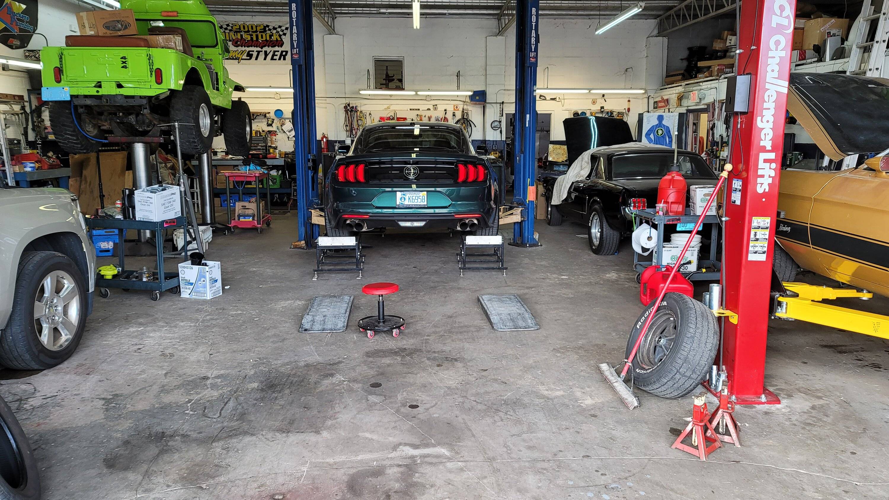

Ok, now that we have heard both the yes and no answers to your question I'll offer my 2 cents worth as I have much the same setup on my Bullitt, (plus a lot of other Steeda stuff) I did the bump steer kit at the same time as the struts, shocks, springs, camber plates and all the rear end stuff so the car only needed to have the suspension set-up (aligned, bump steer, balanced etc) once on the advice of my mechanic who specializes in performance stuff like Hot Rods, restomods, race cars and the occasional Bullitt.

I have idea, as the car went from PP1 directly to it's current setup over a year ago and I will have to find the alignment sheets to see if there is any notation or ask the man next week when I get the GT 350R oil cooler and left side catch can installed...I'm trying to build a poor boys GT 350 and so far it's making me a poor boy with a kick ass Bullitt.
