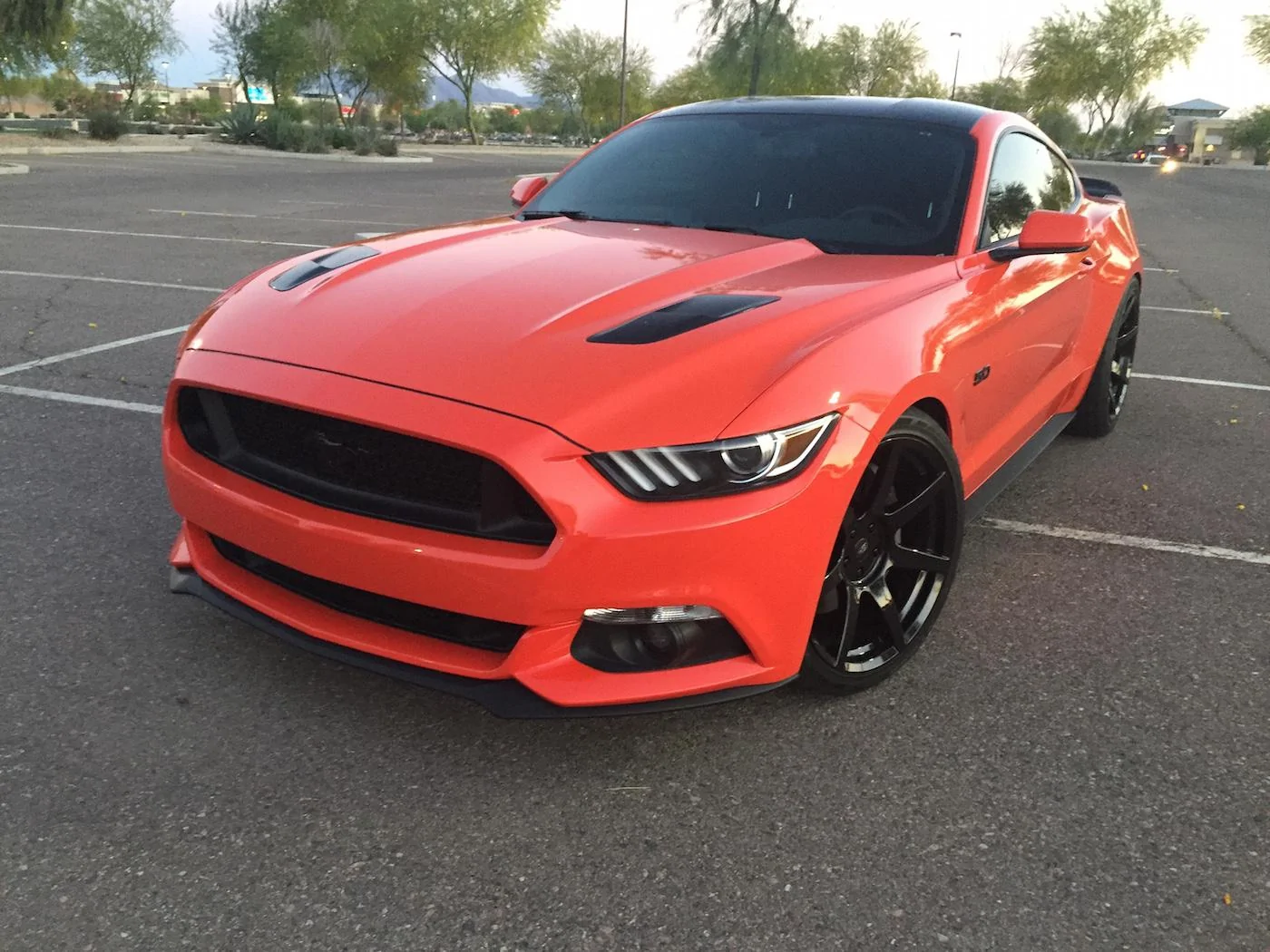

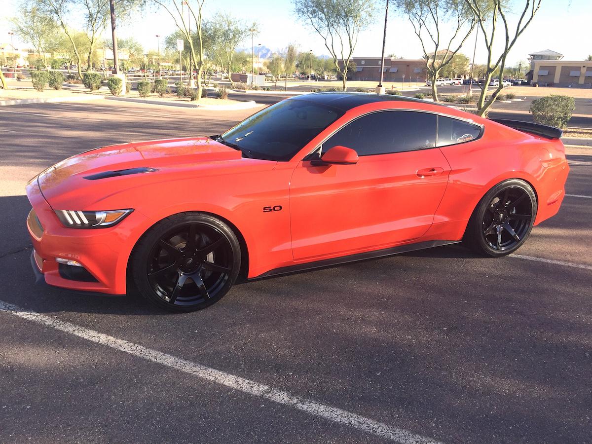

Why not just go with 275 35 20 and 305 35 20 NT555 G2s? I'm running the same setup lowered on Steeda Progressives and the fitment is perfect! The tires are pretty solid too, especially if you're just running them on the street.:headbang:

That looks perfect. NT555R in the rear? Is that factory alignment specs? And have you noticed any rubbing whatsoever?
It shouldn't rub as it sticks out about 21mm compared to the PP wheels and everybody puts 25mm spacers on those. Still curious tho.

No the backs are G2s and I have no rubbing issues whatsoever. I did get an alignment before those pics and everything was within ford spec.

I spoke with Aleksi (sp?) over the phone and he assured me factory spec alignment with the setup I want it is 150% impossible to rub even with my 1" springs, guaranteed. Unless of course my front is turned like 30 degrees and I hit something huge but a that point any wheel will rub..
Put in a deposit for a set in satin graphite wrapped in nt555 :cheers:
