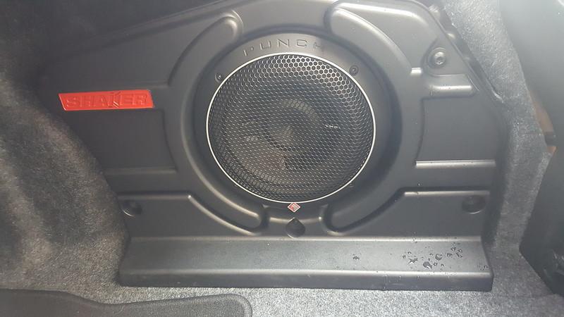

Since this post has been revived, I'll put back the pictures that were lost in the photobucket fiasco:
20170124_121128 by chefjpd, on Flickr
20170124_121226 by chefjpd, on Flickr
20161215_092540 by chefjpd, on Flickr
20161216_114942 by chefjpd, on Flickr
And the final mod:
20170411_152015 by chefjpd, on Flickr

I have the 12 speaker shaker with the sub.
Decided the sub needed some help without getting crazy. Did a similar mod on my ST.
So,
Easy install, 3 torx screws at the bottom removes the faceplate, 3 more bolts and the sub is free.
Unplug harness, remove sub.
Remove the grill and unscrew the speaker.
There is one screw in the back holding the magnet. Remove that and the sub falls out.
It's a dual voice coil, so 4 wires.
Plug that hole on that back. I used that foamy 3m tape on both sides.
Purchase:
Rockford Fosgate Punch P3SD2-8
And RF P3S 8" grill
Amazon has both for around $110.
Drop that baby in, button it up and enjoy.

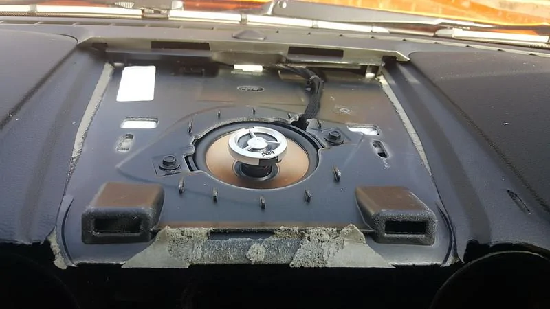

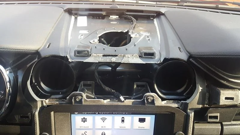

I had a request about the center speaker, so I figured I'd throw in the pic.
Its a Polk DB351, mounted from below the panel for tweeter clearance

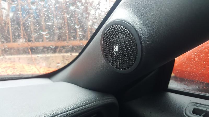

Also a tweeter request, Kicker KTS25, removed the pillar, dremeled the stock mount and installed from the front. be SURE to use the supplied crossovers.
To bad they don't sell the Kicker KTS25 tweeters anymore, I will probably just go with similar Hertz DT 24.3 tweets. and the price for the sub and grill is now over $190. Damn that inflation. I'm probably going to do these to my car if i don't trade it for a new 2021 Mach 1.

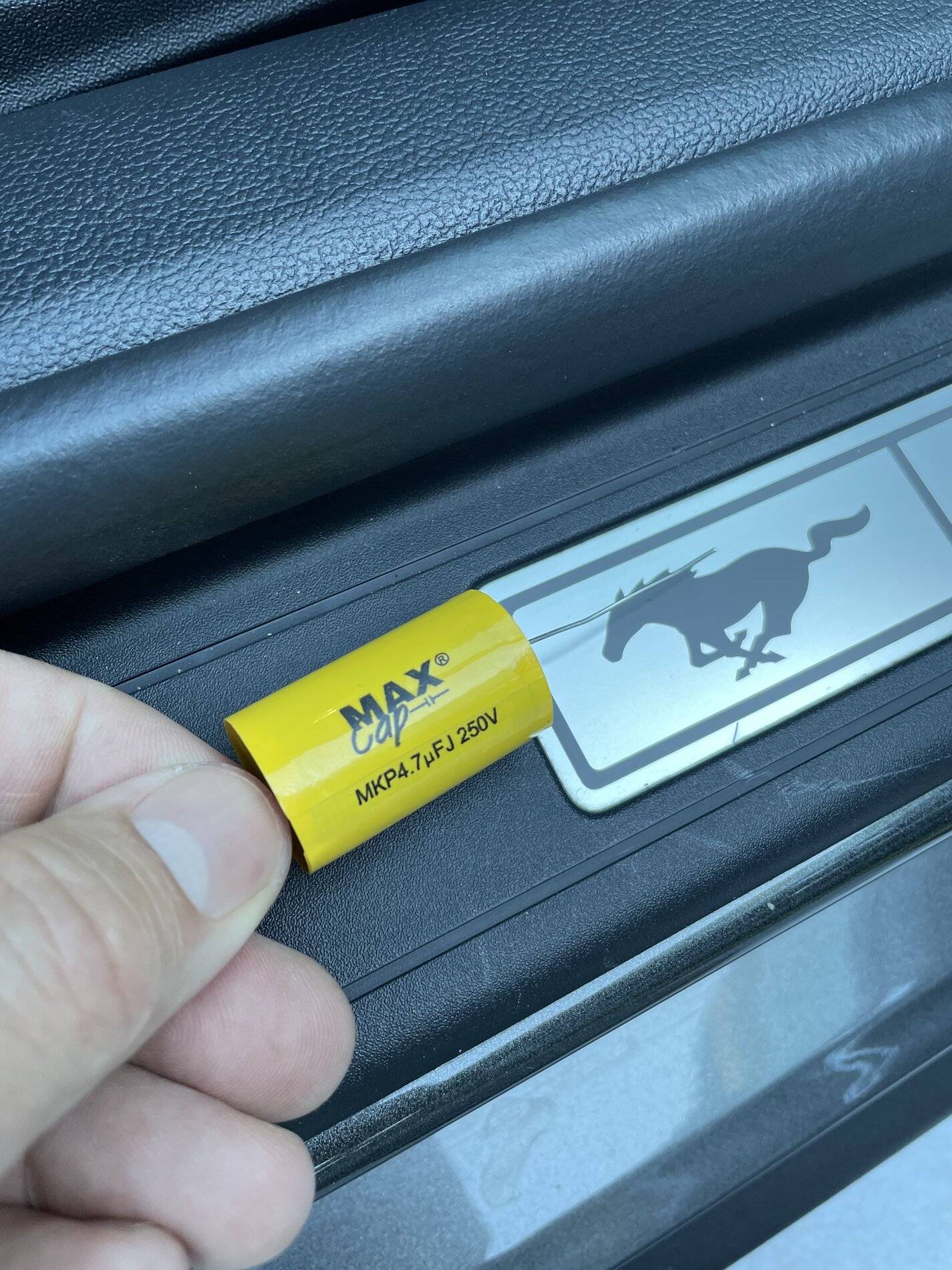

I too was very Disappointed with the Tweeter performance. A drastic improvement was made for five dollars when I shorted out the capacitor on the tweeter and installed a better capacitor on the supply wires feeding the tweeter. i can finally hear all the missing parts of the music, it is really worth it for $5
