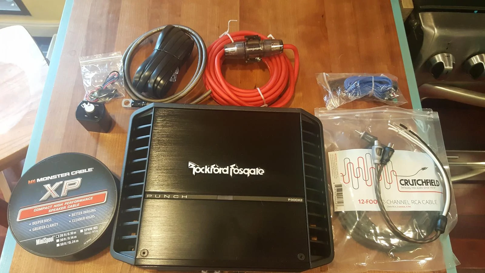

Stage 2, much bigger difference, harder hitting. I used a RF punch shallow dvc. P3SD2.

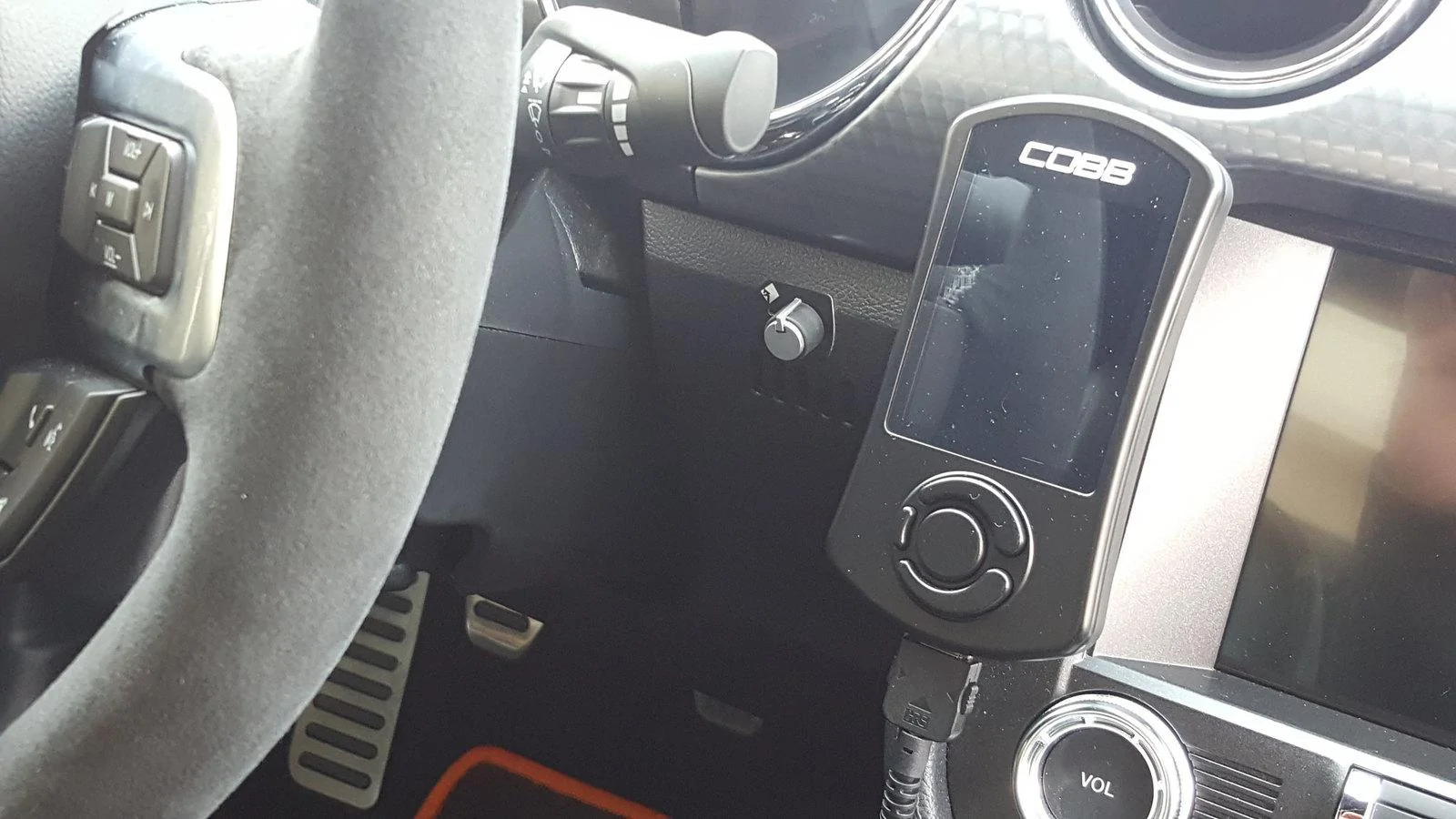

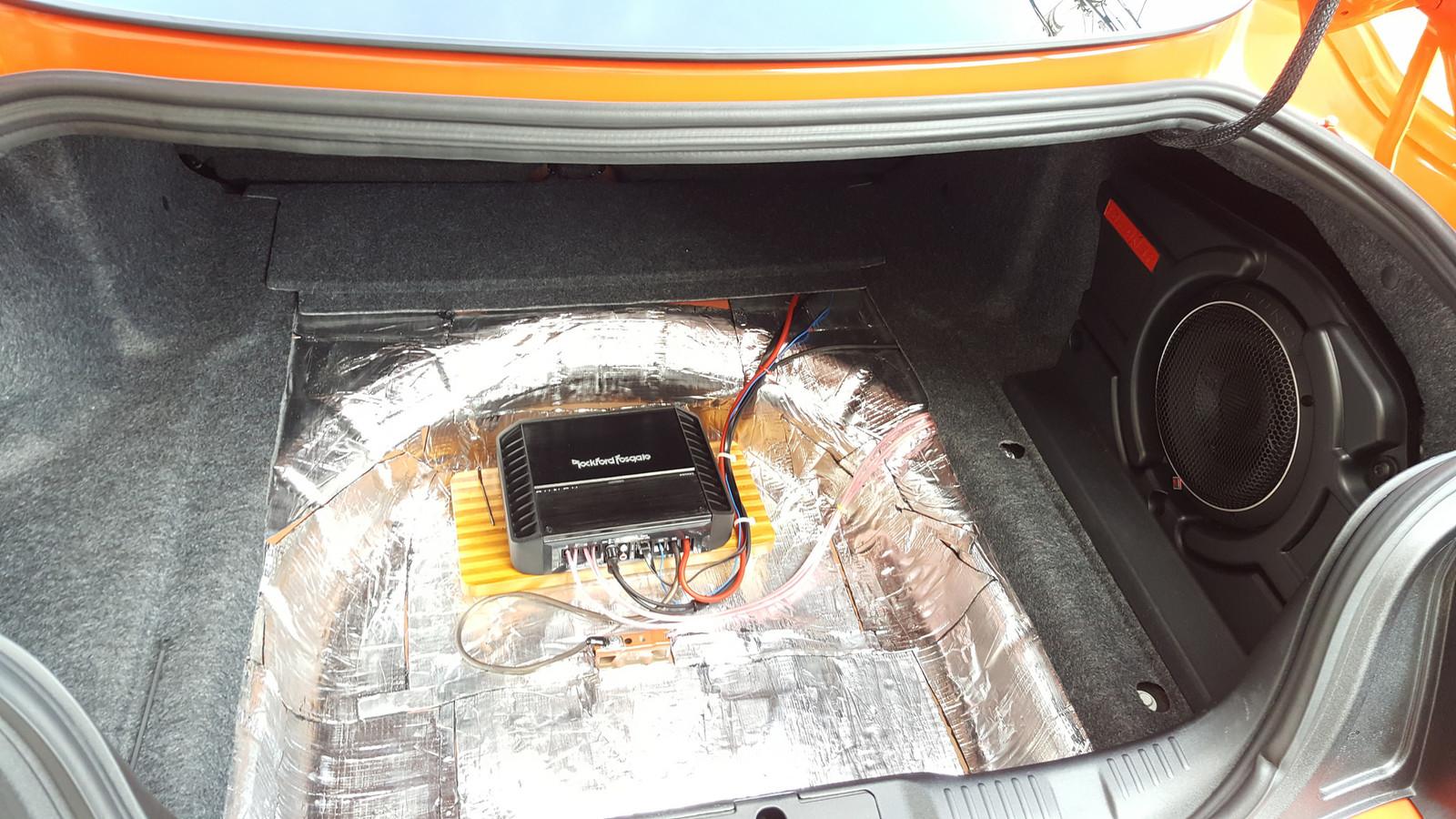

Stage 3 no question the best option, solid tight bass. Used a 300w RF amp. Combined with a remote level adjuster,
