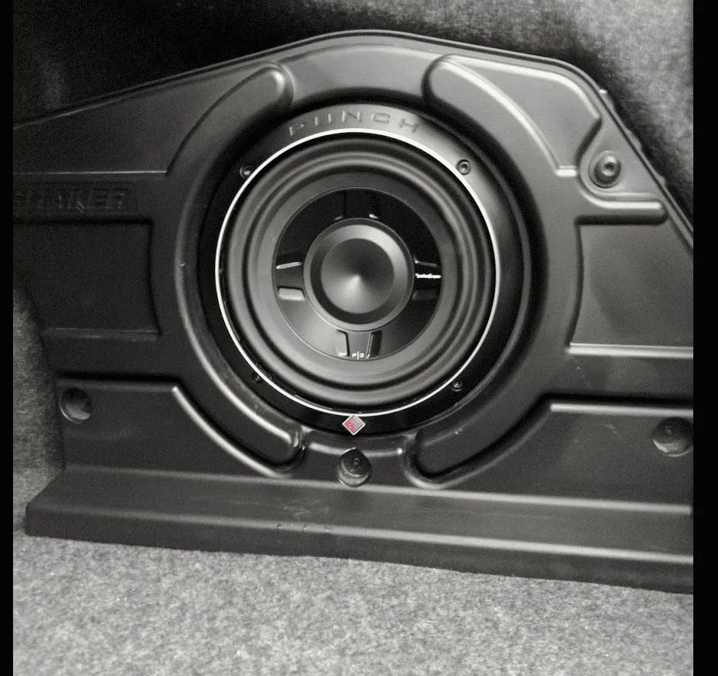

Performed the subwoofer swap today. I think it sounds great!

P3SD2-8 subwoofer.

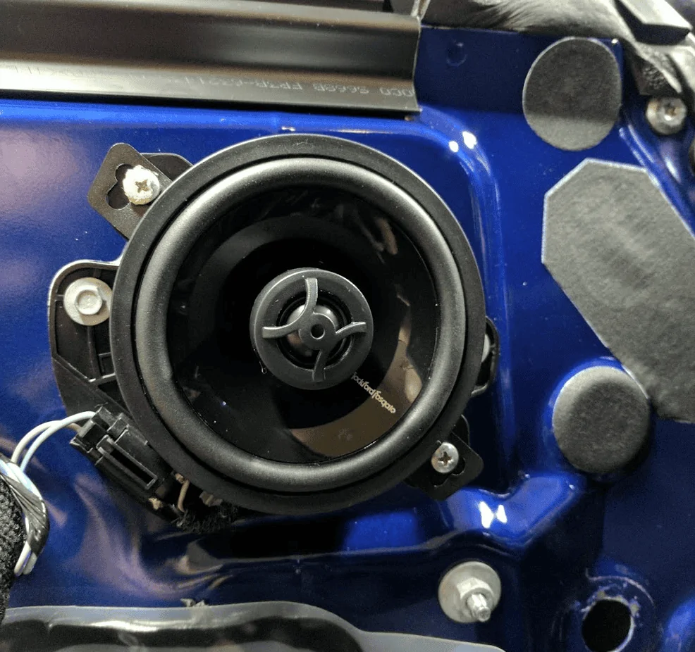

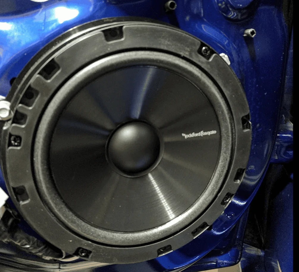

I completed everything yesterday. It took me roughly five hours, but a lot of that time was walking back and forth to my shed to get more and more tools. There is a youtube video that shows how to remove the doors and the backseat carpet. To get the pillars out it just took a firm grasp and they popped right off.
I didn't really take a lot of pictures, and the ones that I did take will need to be resized. I can try and post them later.
The door comes off relatively easy. the little cover behind the door handle requires a tool with a hook on the end. I didn't have a tool that would work. I somehow managed to get it out with a paperclip.
The 3.5" fit in the mount that came with the default 3.5 with a little work. I had to trim a small 1/8" lip out of the inner circle to make them fit. They just clear the door grill cover once installed. I soldered the wires onto the new speakers.
The 6.5" in the doors went in easy with the metra adapters. I did have to drill new holes in the adapters and break the inner tabs. I didn't list it but I also bought 2 pairs of 72-5602 Speaker Wire Adapters off of Amazon for 10.00. This made for easy connections.
I wasn't sure about the tweeters. I didn't like the idea of cutting on the pillar and found a way to avoid any cutting and using the factory grille. I took the housing of the tweeters apart and discovered they dropped right into the existing tweeter housing. I then took Gorilla Glue Epoxy and reattached the back housing and locked them into place.
The rear speakers were the same as the doors. Drilled new holes in the adapters and broke of the inner tabs. The most challenging part was crawling in the back to get everything removed. There is one screw on each speaker that is at the very back of the window. It took a 1/4" ratchet to get the screws out and even it was hitting the window.
I had installed the subwoofer the day before. It was easy after following the OP's write up. :clap2:
Overall, I think it sounds much better. Before, I had an irritating rattle that I suspected was from a passenger side speaker. I think I took care of it with the new speakers. Or maybe I couldn't hear it over the music! :headbang: I had to turn the highs down to zero just to even things out. With the old ones I had it at max. The bass is more solid hitting now. I can see how some people would probably like even more bass. I would definitely go with 10" or 12" box if much more bass is desired.
