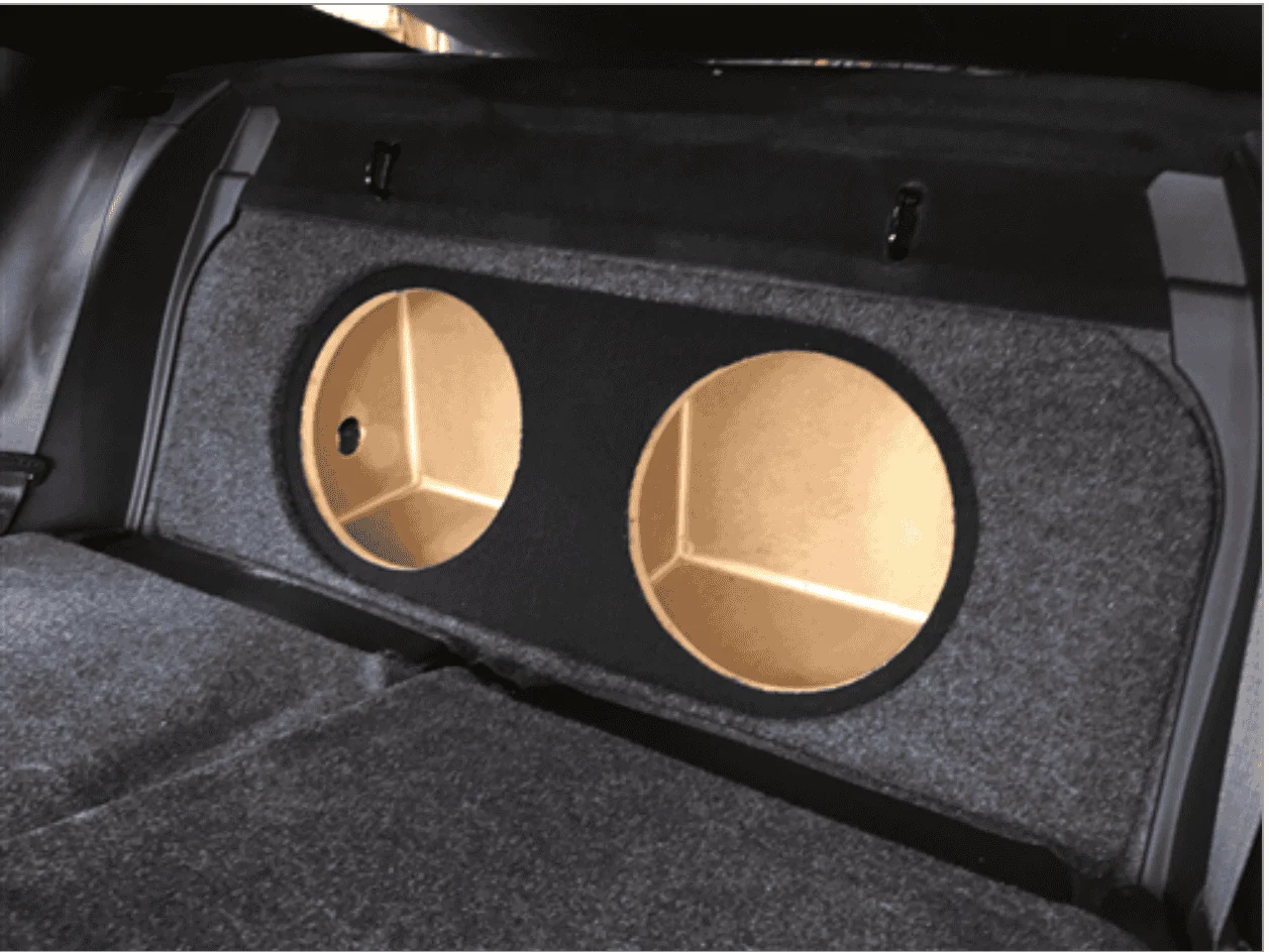

Would prefer to have a front-firing enclosure similar to the one attached below, with an upgraded amp also sitting in the enclosure.
What are the advantages and disadvantages of a double 12' vs single 14' subwoofer setup?

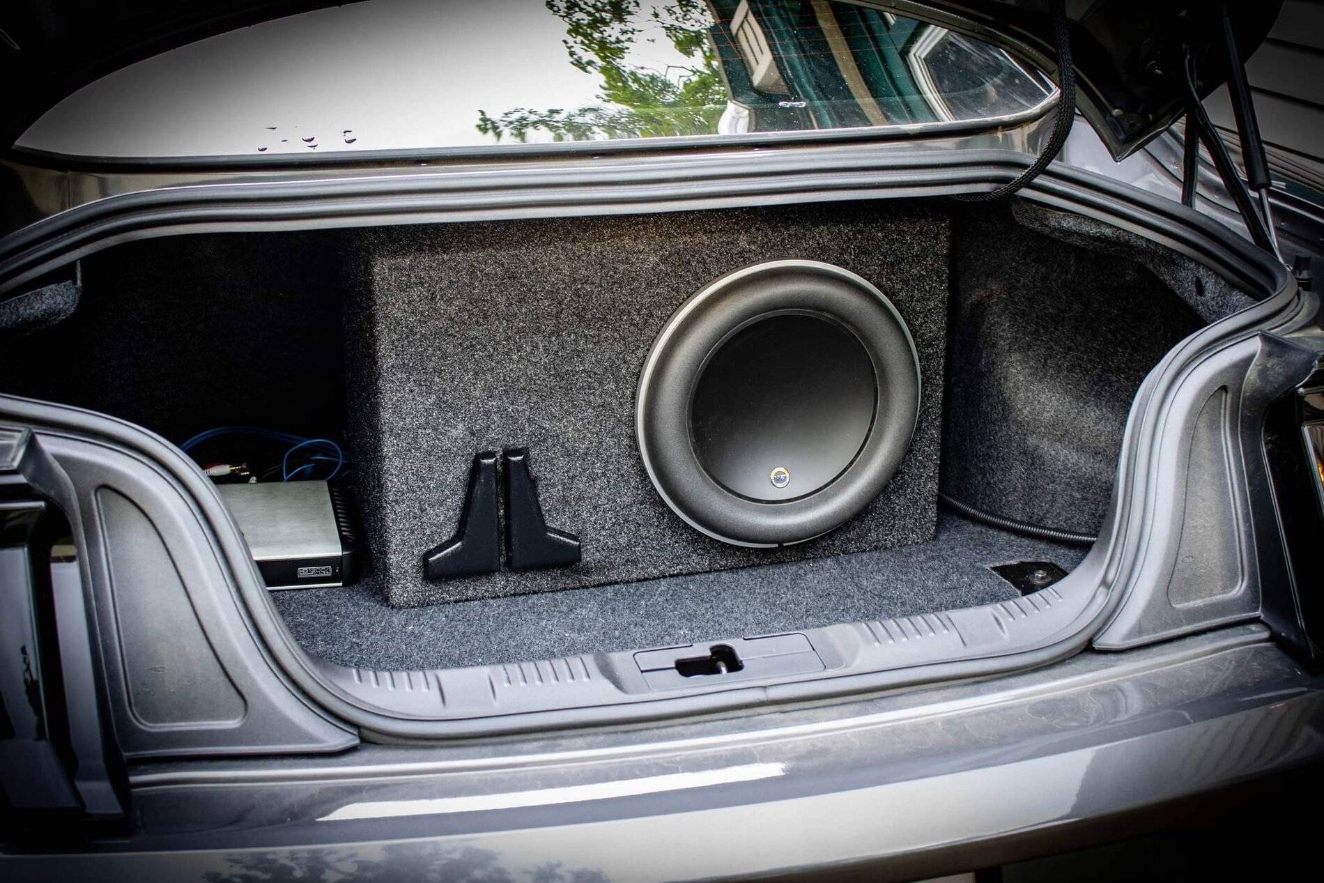

I am currently in the middle of a custom install in my '21 with the B&O. I made that temp box to check how the JL 12w7 sounds in a 1.375 cubic foot sealed enclosure off my JL HD1200. It sounds clean and gets very loud. I just used the 2 sets of high level leads going into the stock DVC sub. I ran those into an LC2i and ran 4ga power/ground. I haven't messed with disabling any factory equalization and it already sounds amazing. I'd go ported with a 12w6v3 or if you go 12w7 you could easily get away with sealed. Sealed will save more trunk space, if you care.

I have the same subwoofer and can agree with everything said....I tried two others before settling on this one.

I also didn't disable any of the factory settings and get great sound. I have the sealed JL 12w6 and it gets plenty loud; this is coming from a guy that always ran ported for the loudness. Keep in mind, going ported does get loud but eats up a lot more trunk space, which there is not much to begin with. Your 12w7 is going to hit hard in both a ported and sealed enclosure.
