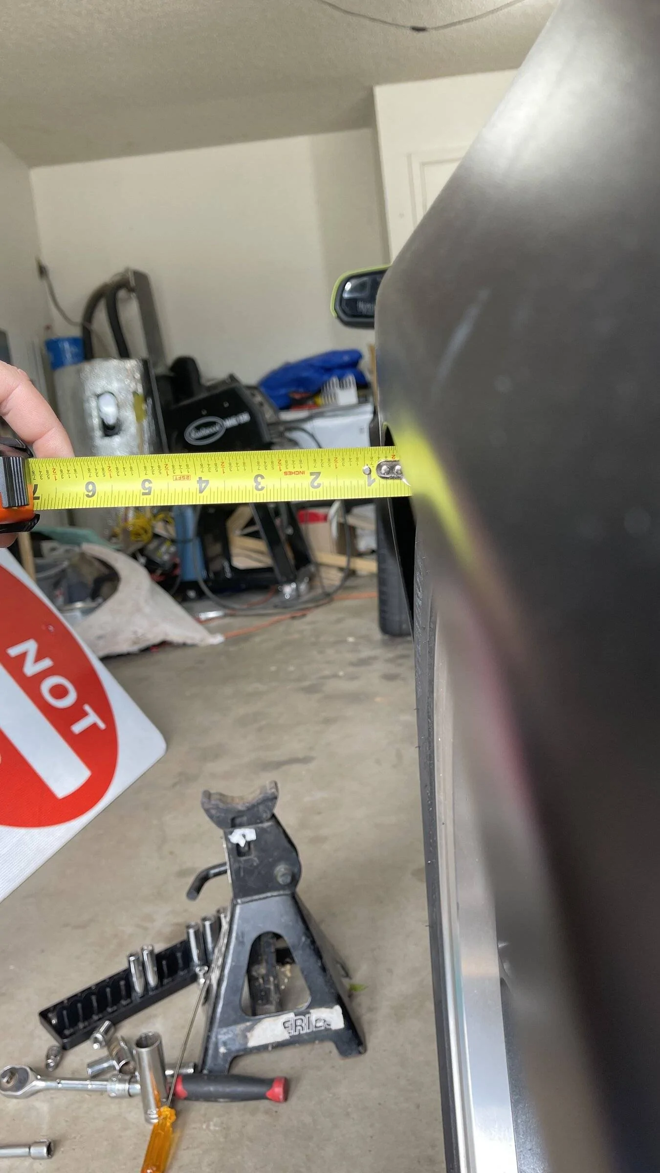

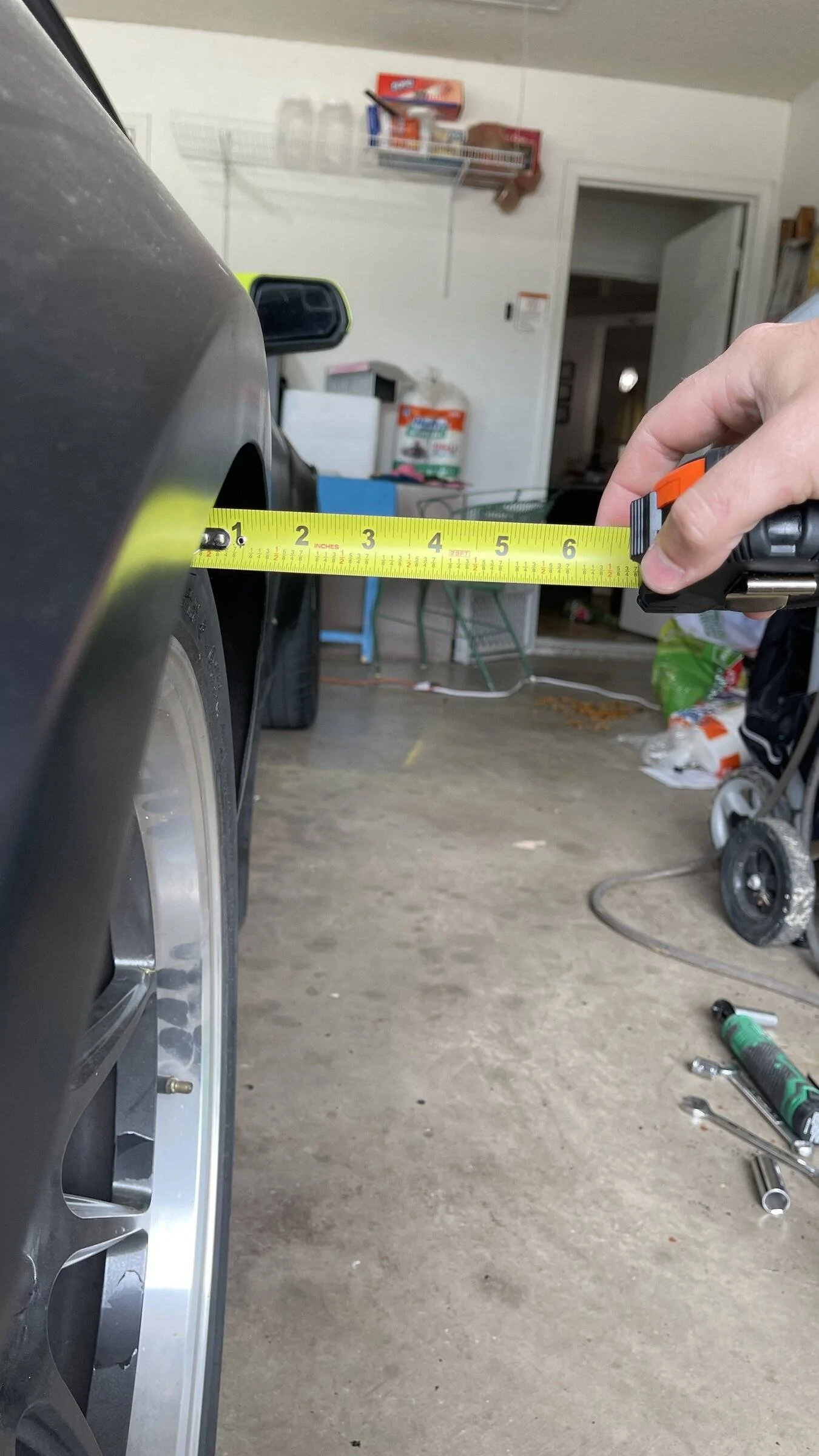

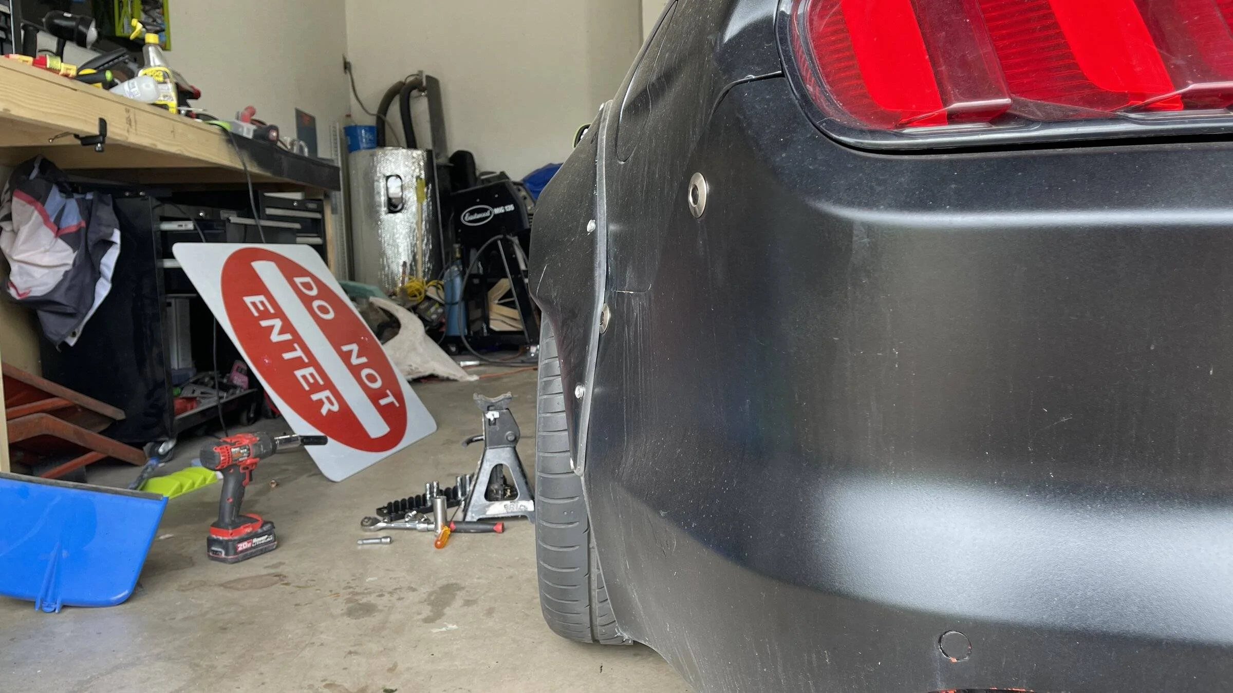

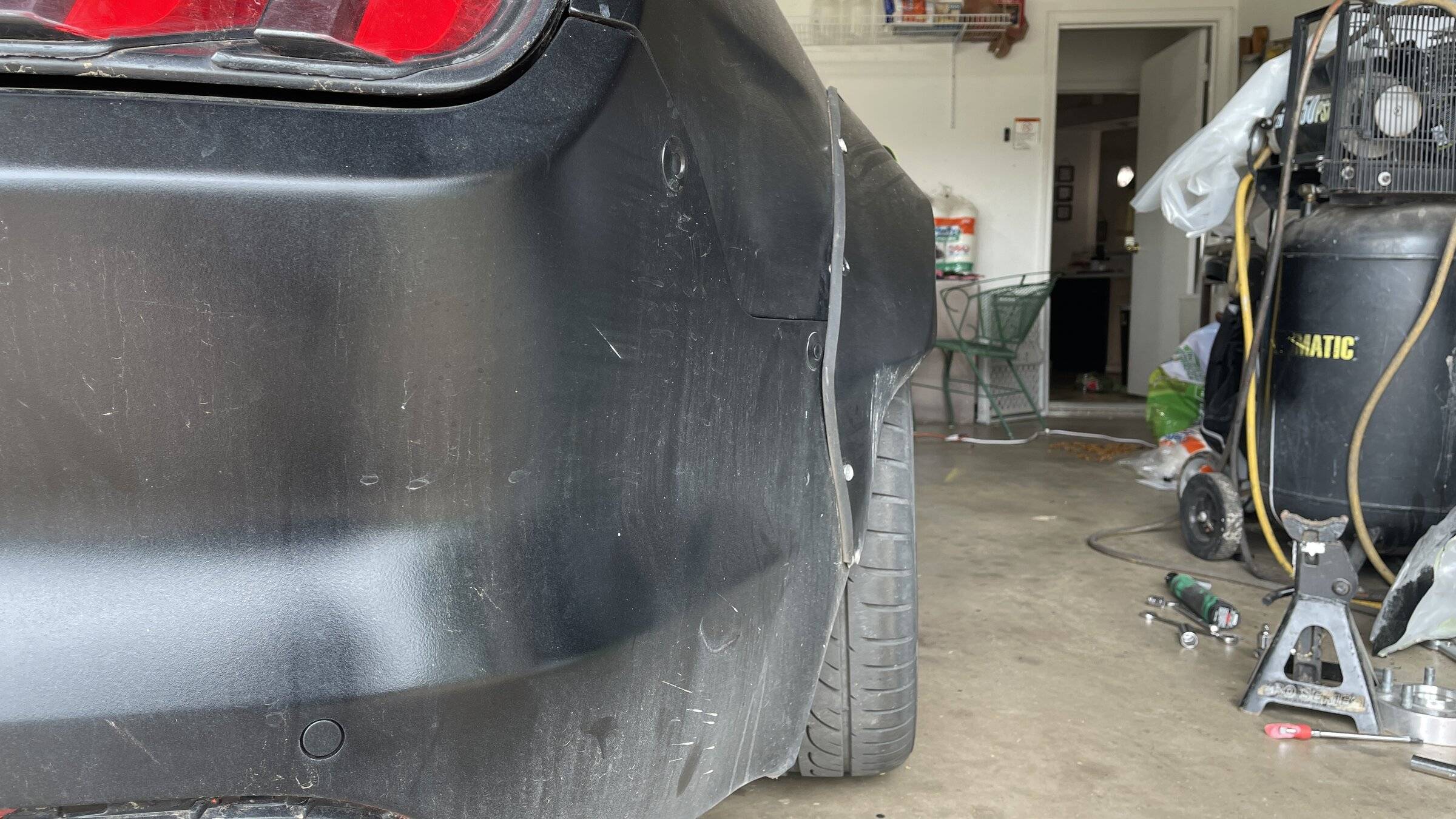

I installed the steed subframe alignment bushings today because I noticed after lowering the car a few months back that the driver side wheel/tire poked out like an inch further from the passenger side. But after installing them today it didn't seem to fix the issue. I haven't gotten an alignment yet as I wanted to check here to see if I did something wrong. I've attached some pictures as well as a video, any help is appreciated.

From the photos, it seems like your wide body add-ons are not same size. The one on the right side is larger than the left side
definitely looks like it, I agree!!

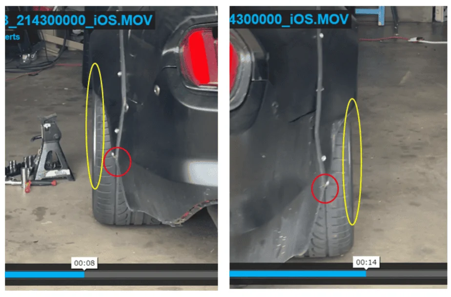

I also agree.
Freezing your video and snapping a screenshot from the same angle (silver lip of rim just appearing - yellow oval) shows that the original bumper cover line points to exactly the same place on the tyres (the first groove - red circle) :
I know that's not an exact science / measurement method, but I think it shows that its not 1" out as measuring from your wide body kit seems to suggest :like:

Thank's for all the replies, after taking the flares off and remeasuring everything's good. I also looked at the flares and it seems like the passenger side somehow bowed out.
