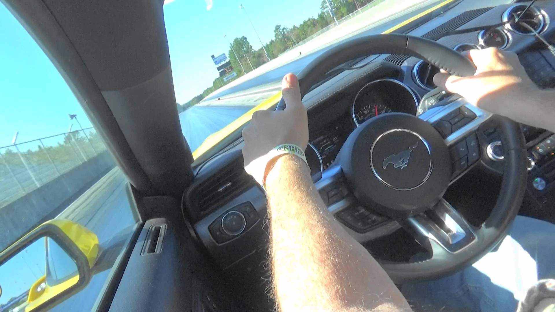

I've got a few in car video shots of the vacumm gauge from my 2018 Gen3, Not sure how accurate it was but it read approx, 5in vac WOT in every vid I looked at.
