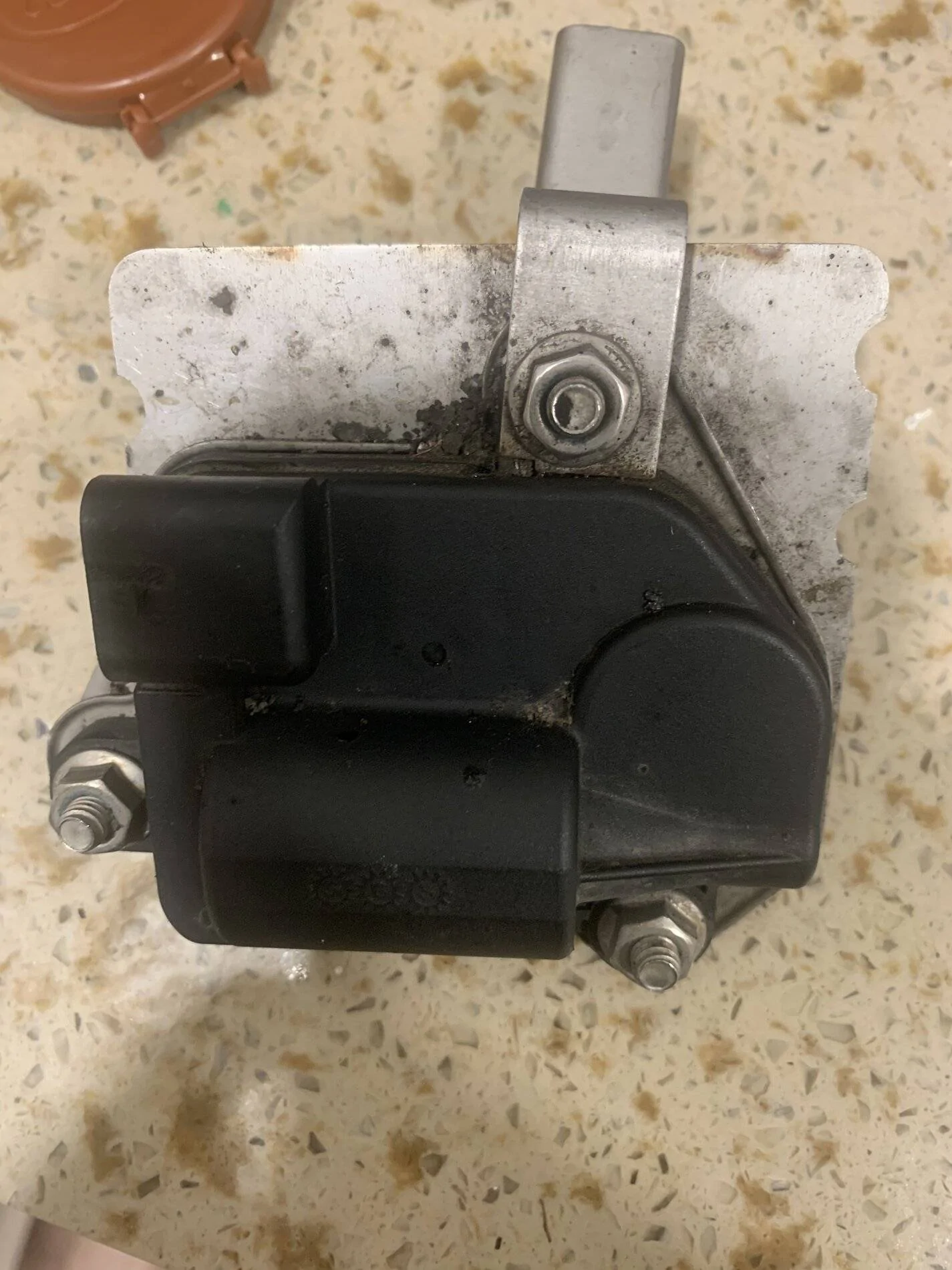

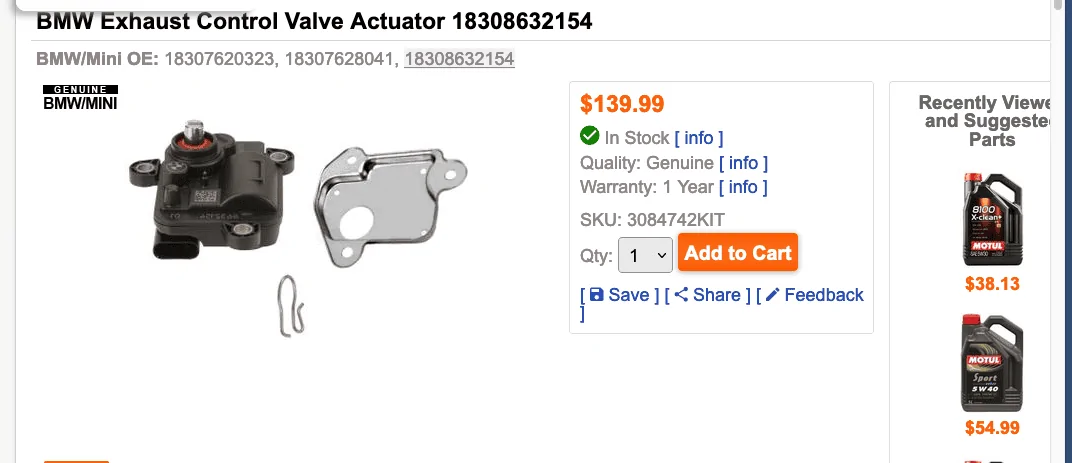

Hi Geosh,
Reviving an old thread....Did these actuators work on your active exhaust?
Unfortunately, @Geosh hasn't logged in in about a year and a half. Bumping the thread though, that could bring some new feedback and additional options.

Hi Geosh,
I didn’t use them in a normal way but I got them to fit and work as needed. I wired them up to a manual switch as I didn’t want to try to interface with an active system my car didn’t come with.
