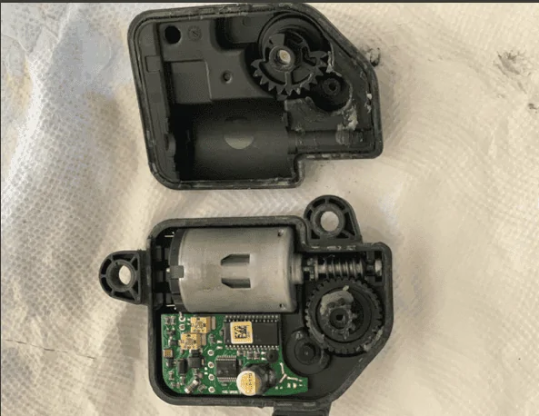

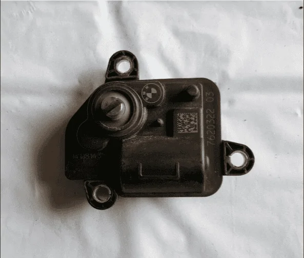

Rapid Red
Nov 4, 2019
5,049
4,096
Woodstock GA
Greg
Does anyone have the part number for the actuator? I’m in the same situation - habe everything apart, Remote started and the actuator is clearly sticking. Before I try looping it up since I’m still under warranty, I’d like to know how much it cost to just buy on my own if I screw this one up. But I don’t have the part number and I can’t seem to find it. The part number on the actuator brings up nothing on Google.

Rapid Red
Nov 4, 2019
5,049
4,096
Woodstock GA
Greg
Those are the BMW ones I used. Not the Ford ones. Same basic thing though
Same basic thing though exactly....cheap not very durable looking. Too much plastic, that might be subject to change with the heat cycles.
