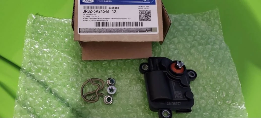

Thanks for the pics and replies - sill would like to see a pic of the actuator with the metal twisty thing in place.
You can see a pic here. It’s kinda small on my phone though.
https://www.mustang6g.com/forums/threads/2018-active-exhaust-install-guide.101913/
The side up in the pic with the green background would be the side that mates with the valve part on the exhaust. That curvy section in the middle fits right in the center of the circular valve piece, and the wire on each side will sit in the 2 opposing grooves.

Thanks - that helps

Or JR3Z-5K245-B. I’ve seen them in the $145 range when I was looking for them.
That's the old part number and is no longer stocked in any warehouse. There's 5 dealers in the entire country that have 1 left each.
