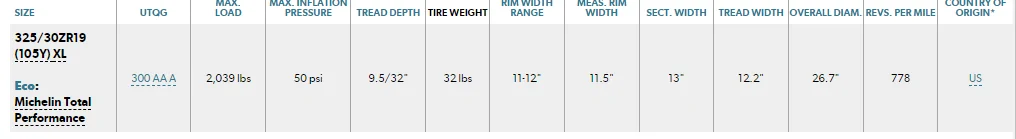

If memory serves, that particular Cup2 is the 350R-spec tire, right? I ask because it’s also not always considered that there are compound and even construction differences within a particular tire model. They’re rarely publicized and often go unnoticed by consumers.

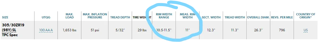

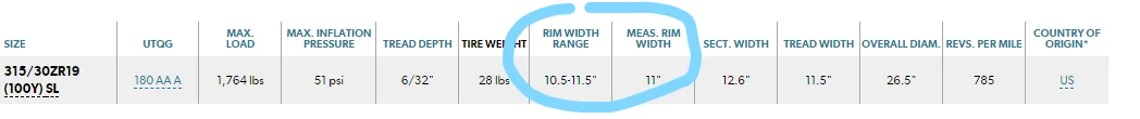

I know exactly what you are talking about. At least from what I can also tell DT and Tire Rack no longer carries the FP spec of the Pilot Cup 2 tires at least in 30s.
The screenshot above is now the general Pilot Cup 2 tires for any platform. You are correct tho and the screenshot above already shows it starts with 6/32s while the NO spec which are bespoke to a few Porsche models is what I actually run which starts out at 7/32s. In terms of grip, I'm not Billy J or Montoya so the NO spec has worked fine for me on track.

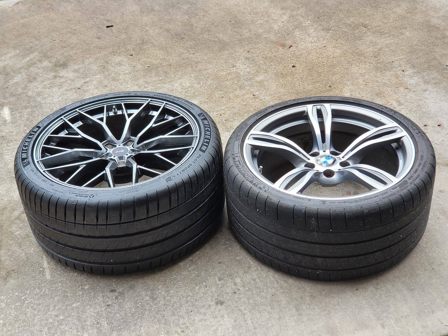

The tire on the left is a 315/30/20 Michelin Pilot Sport 4S on an 11" rim.

The tire on the left is the optimal size in that offering. 11.2” tread width on an 11” wheel.

Yep, the tire on the right is a 295/30/20 on a 20x10. Also optimal.
The FP was a 35 profile for the 19/20 base 350's. The R tire was a 30 profile.
