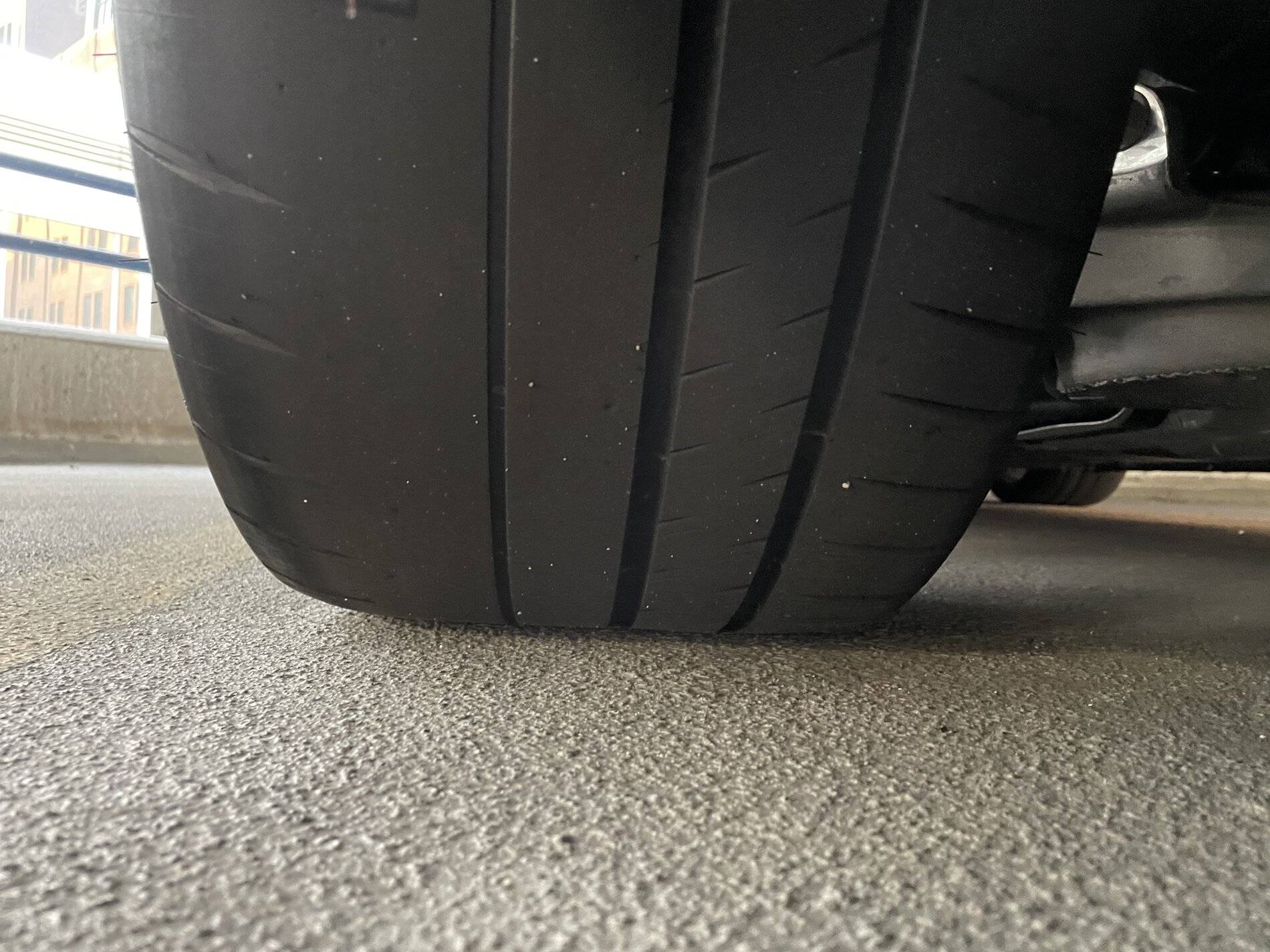

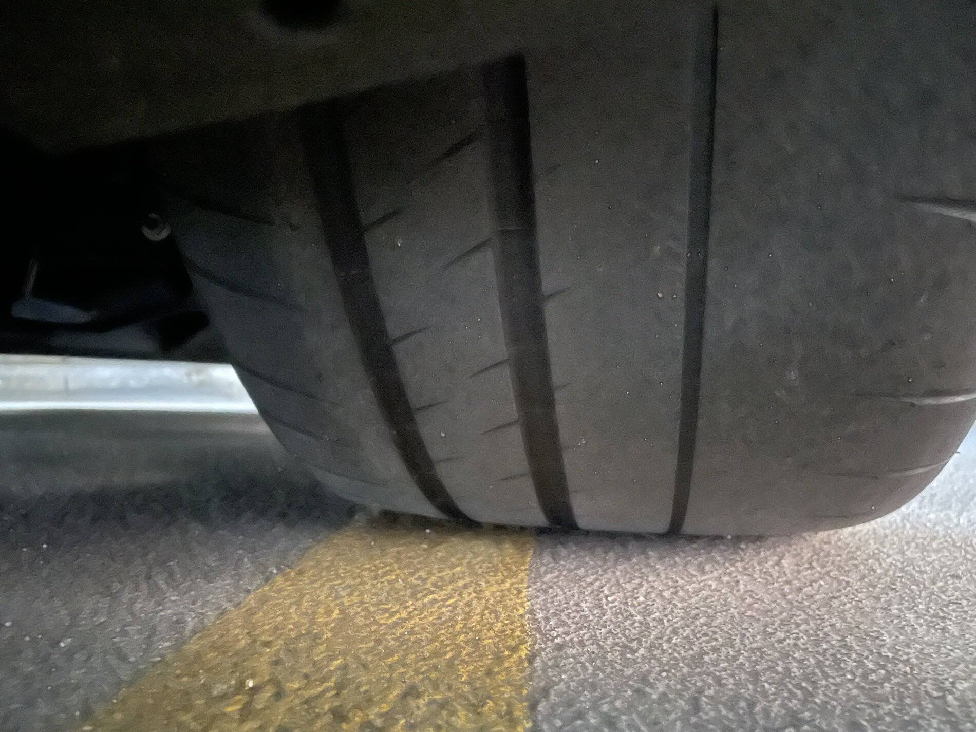

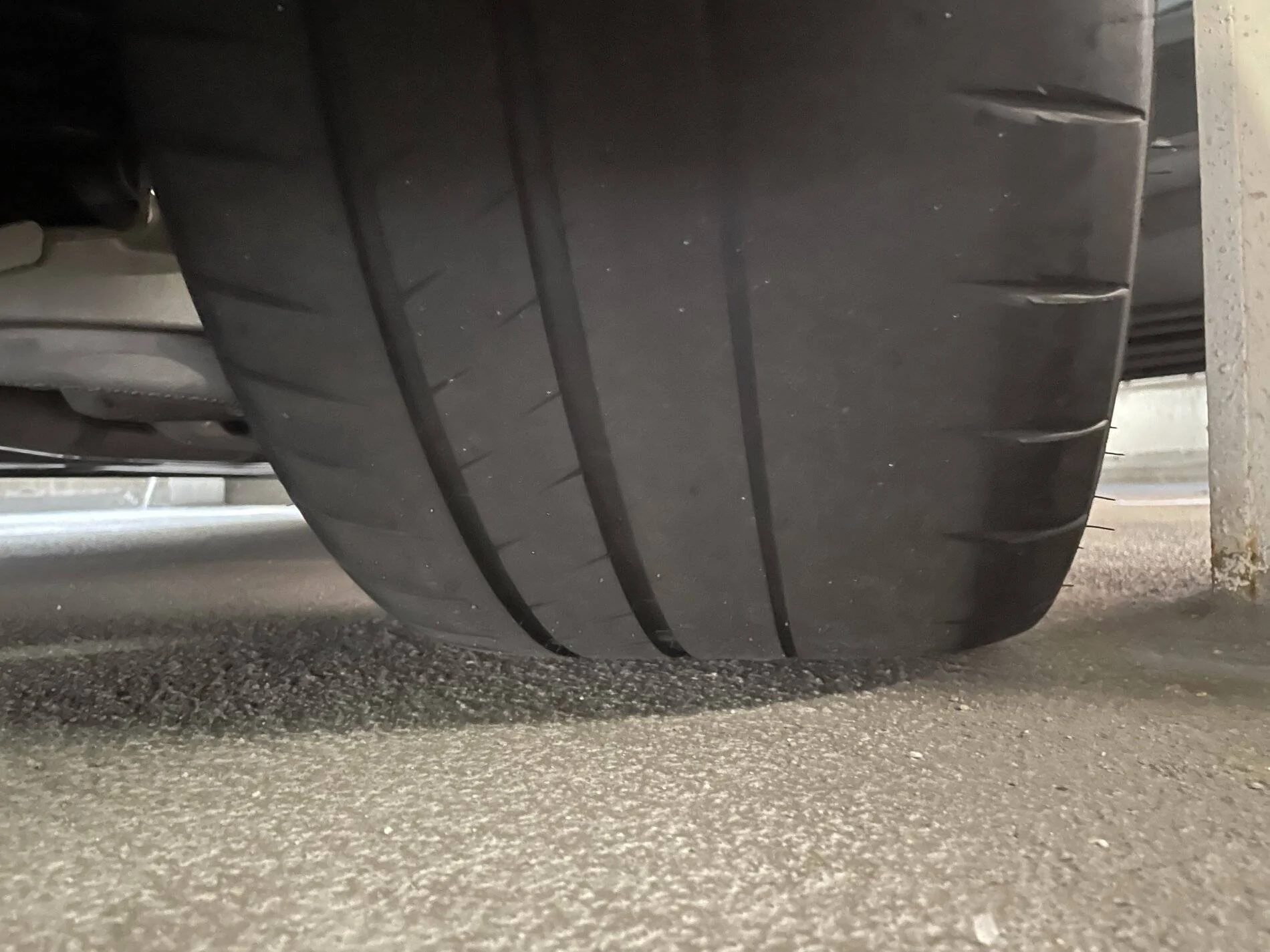

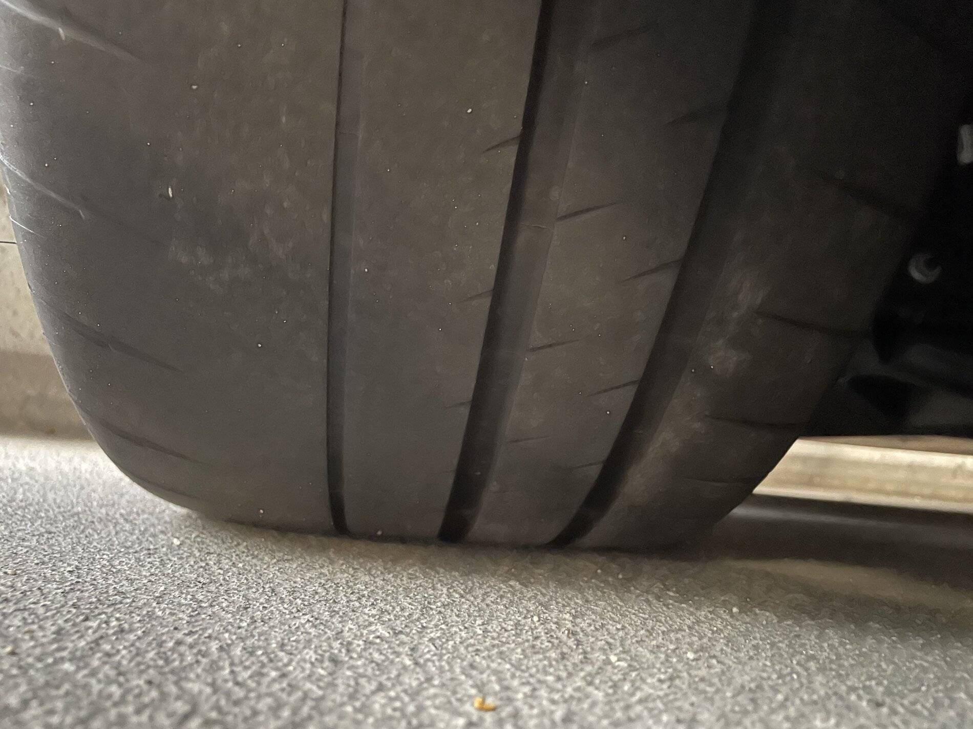

Finally had a chance to take some pictures of the tire treads. Tread depths seem to be even between each side of the car. I’m not noticing or feeling any uneven wear patterns on the tread.
I’m now at around 3300 miles on these cup 2’s. Letting go of the steering wheel on the highway the car seems to track straight but the steering wheel is always tilted slightly to the right. At the rate these tires wear, I’m probably just going to wait until these tires are toast and get an alignment when i put on the next set
front driver
Front passenger
rear driver
rear passenger
