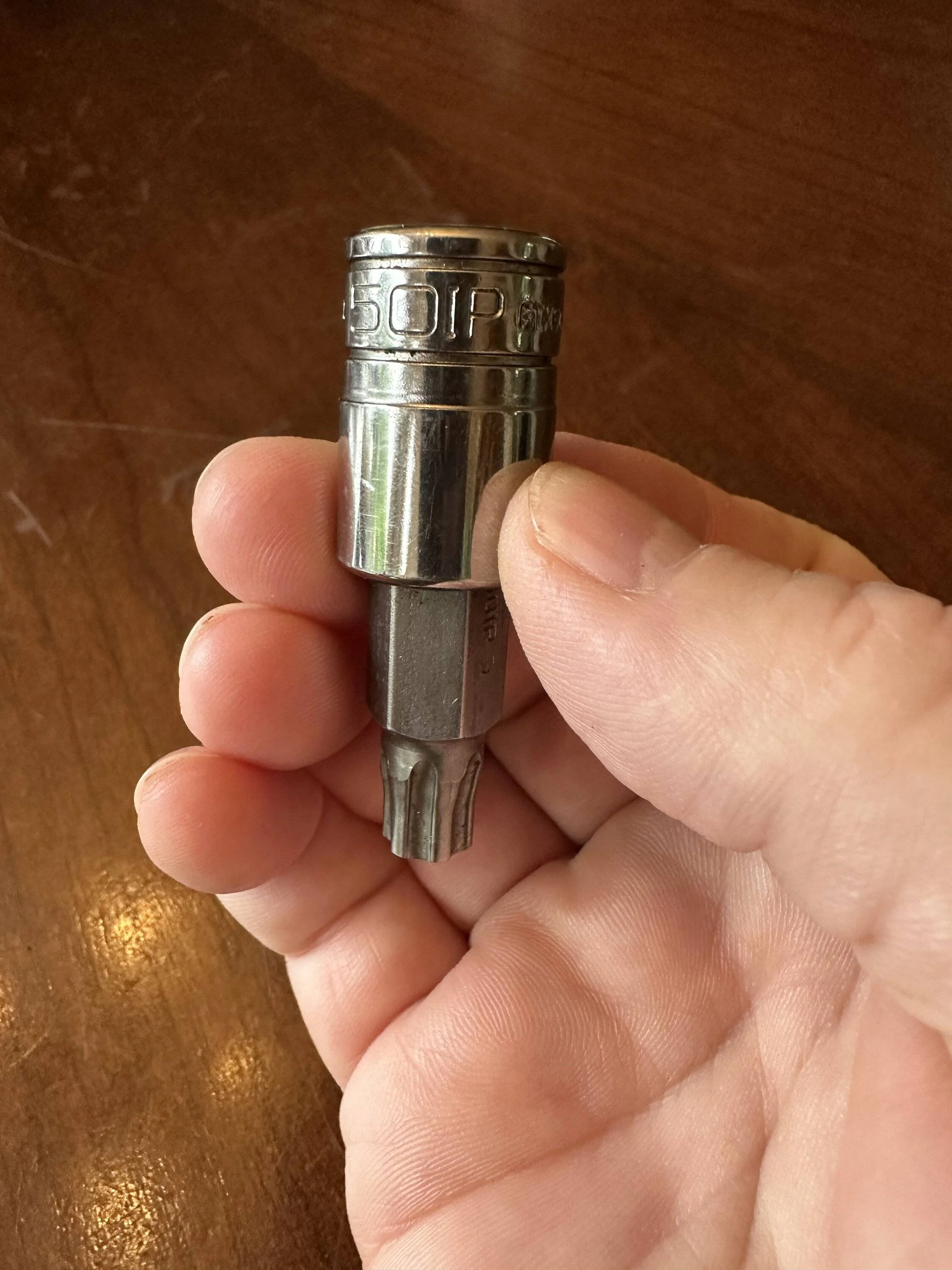

Look closely at the picture that OP posted of the bolt head, and you will see that the slots are kind of squared vs. the sharper teeth of a standard torx.

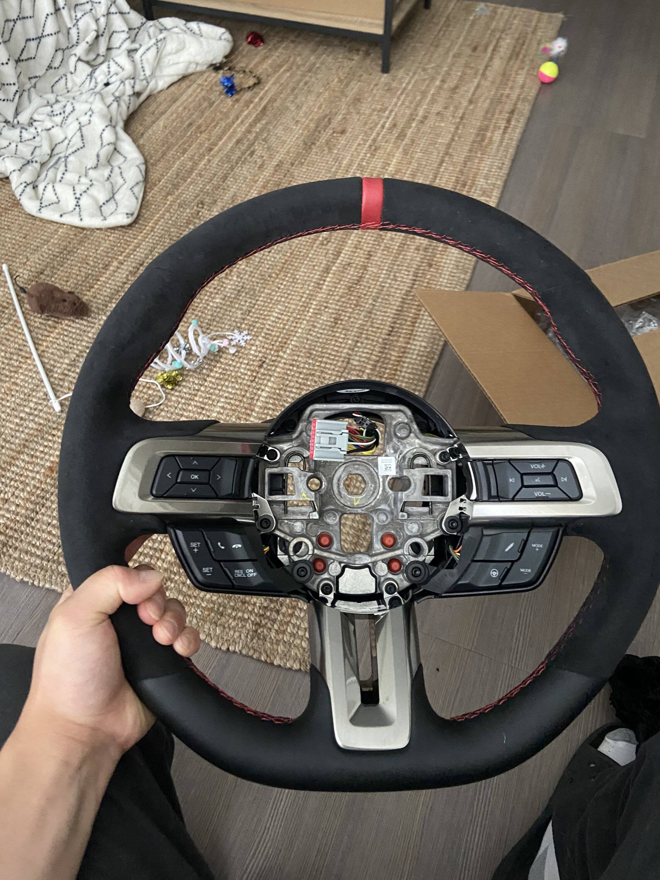

I didn't get any instructions with this gt350r steering wheel from steeda, do I just switch all the buttons over from my old steering wheel even though some are different?

Correct. Everything should be a direct replacement. What buttons are different?

Yeah you will want to swap in your buttons. Nice that the GT350 had the heated wheel function and suspension adjustments right there, On my MACH 1 those options are buried in the infotainment menus

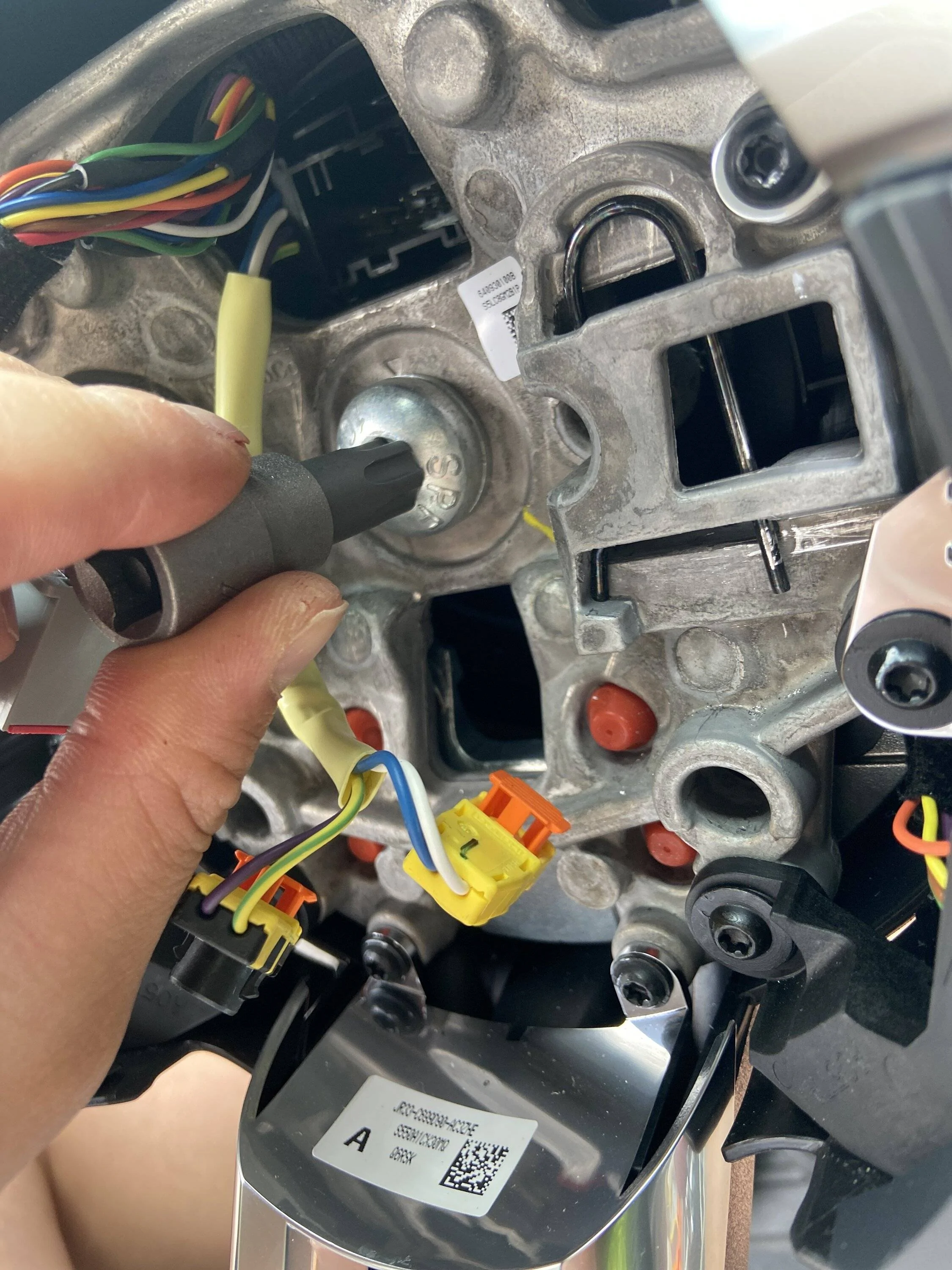

oh that's for suspension, I was wondering what that would do on a gt350 lol. I read 35 ft/lbs + blue loctite for that center bolt, the bit arrives tomorrow so probably will get this done sunday :fingerscrossed:

Yeah it looks like that steering wheel button may be for adjusting the steering feel, not the heated function.

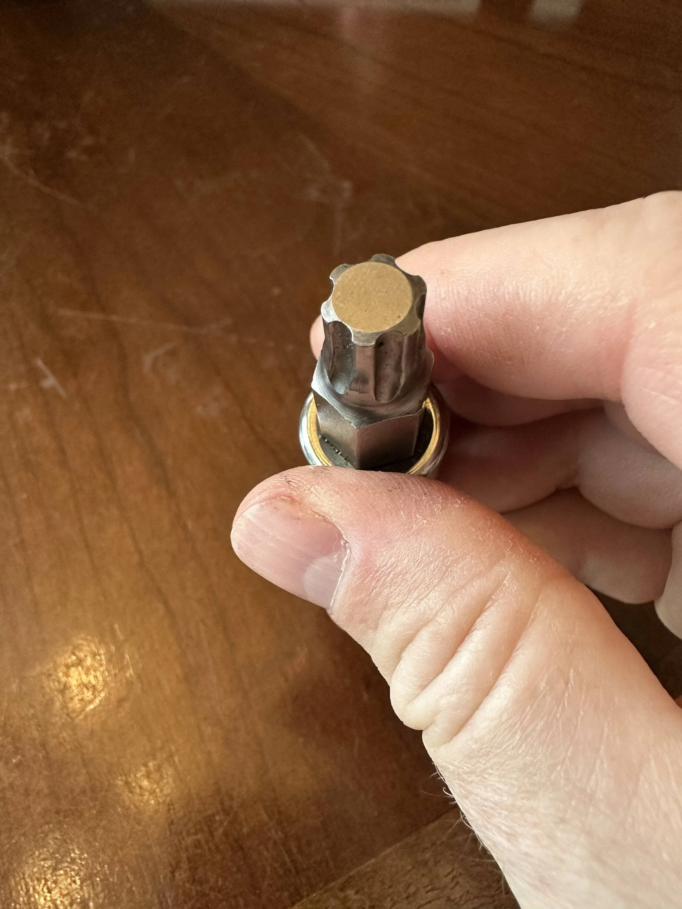

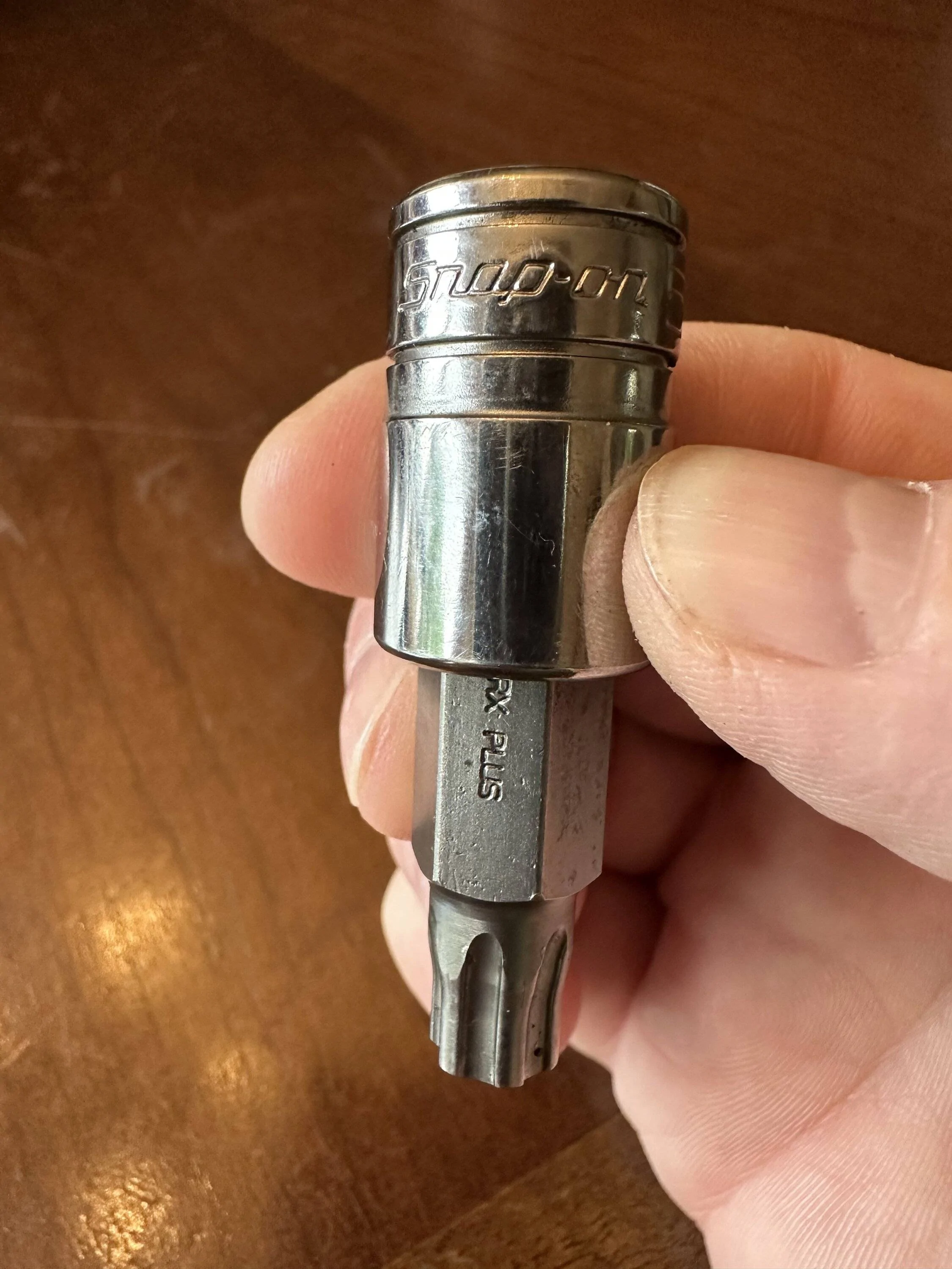

weird... mine isn't a t55 plus. it doesn't fit is it a t50 plus?
OOPS I'm an idiot and bought a t55 plus instead of t50 plus DOH
