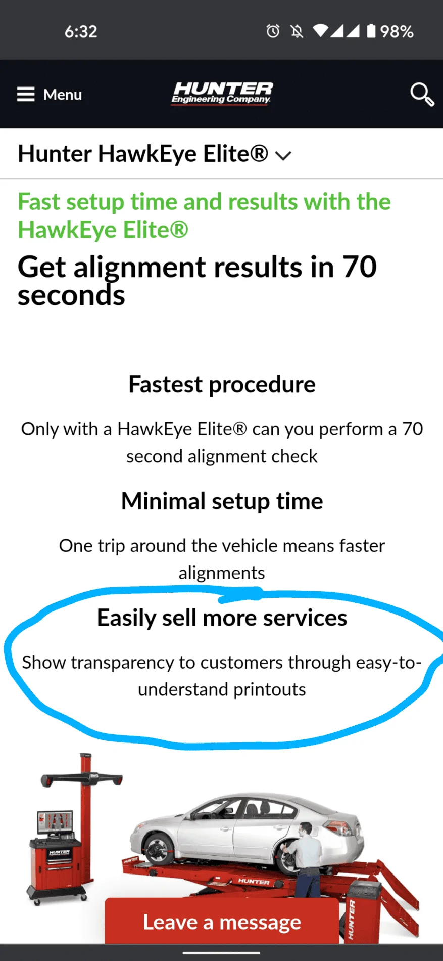

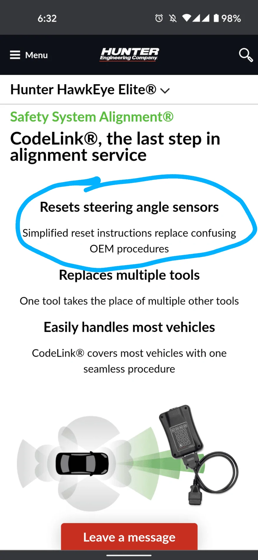

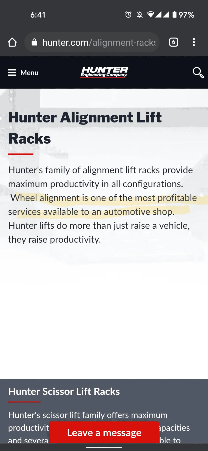

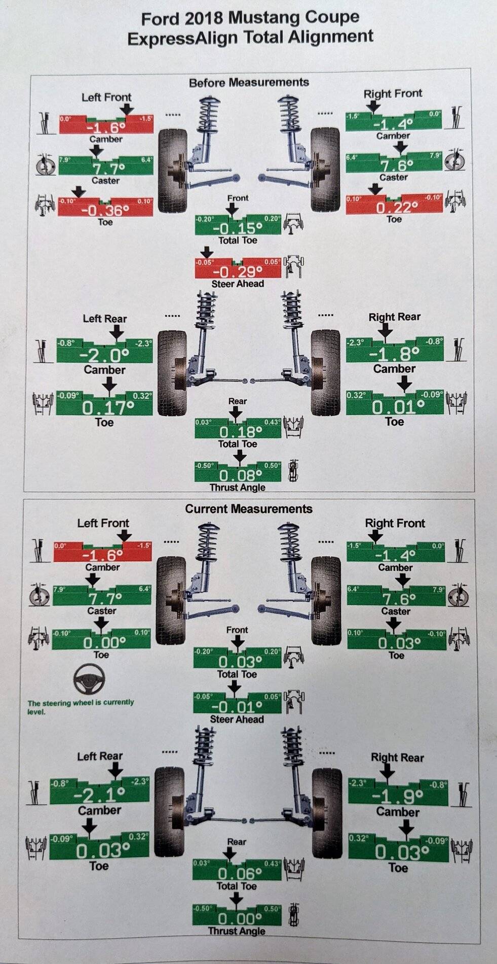

Fyi, I do have adaptive cruise control and lane keep. What can you tell from this printout? Btw, I asked if there was a printout related to the SAS reset, but they were unable to pull it back up, citing a software problem.

I'll address the alignment sheet first. Everything that was adjustable was actually already in spec when they pulled it in. The steering wheel wasn't straight when they initially rolled it which is why the front toe is off. The steer ahead gives that away. They did actually bring it in a little though. For the rear toe they brought the left rear in to meet the right rear, but they should have brought both in closer to center. My guess is that centering the rear toe would have pushed rear camber out requiring them to make that adjustment. Rear camber is adjustable, but it is a total PITA. We charge $89.95 for an alignment, and for that I would have left the rear camber alone. If I charged $199 and didn't adjust that rear camber I wouldn't have slept well that night. All in all, they did 10 minutes worth of work for $199, At that price I would expect everything that is adjustable (front and rear toe and rear camber) to be as centered on the graph as possible. I'm not one to go back and complain, but if you are you have every right to based on what you are showing me.
As for the LKA calibration, the Hunter machine initiates the procedure and the tech just needs to drive around for about 10 minutes. Hardly $125 worth.... If they didn't go on a roughly 10 minute test drive, they didn't calibrate the LKA. FWIW, the calibrations seem to be not as critical as the manufacturers elude to. I always end up driving my vehicles around for a few days before running the calibrations and have never had any issues with lane keep. I wasn't aware that there would be any documentation for having run the calibration, but then again I have never checked Hunternet to see.

One more thing I would like to address regarding your Hunter promo screenshots. While alignments are profitable, keep in mind that quality alignment equipment is the single largest equipment investment that a shop will make. This setup is about $50k with annual specification updates costing extra. The usable life of the equipment for most of us is 5-10 years with some maintenance expenses expected throughout.
