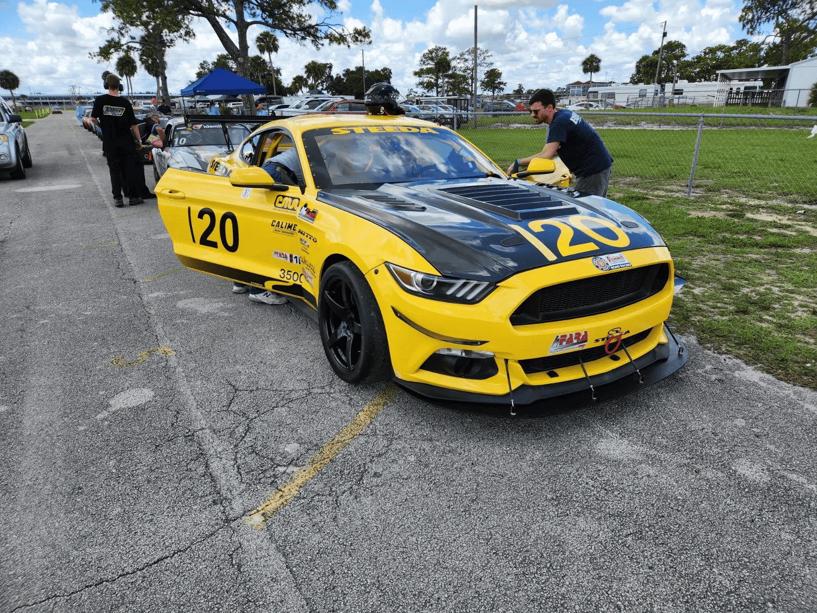

Plenty of data here on the subject: https://www.steeda.com/s550-mustang-k-member-guide
Steeda is & continues to be one of the only companies that has a fleet of test vehicles that compete regularly on the track & on the street to ensure the success of our products:
Took 1st this past weekend while at the track:

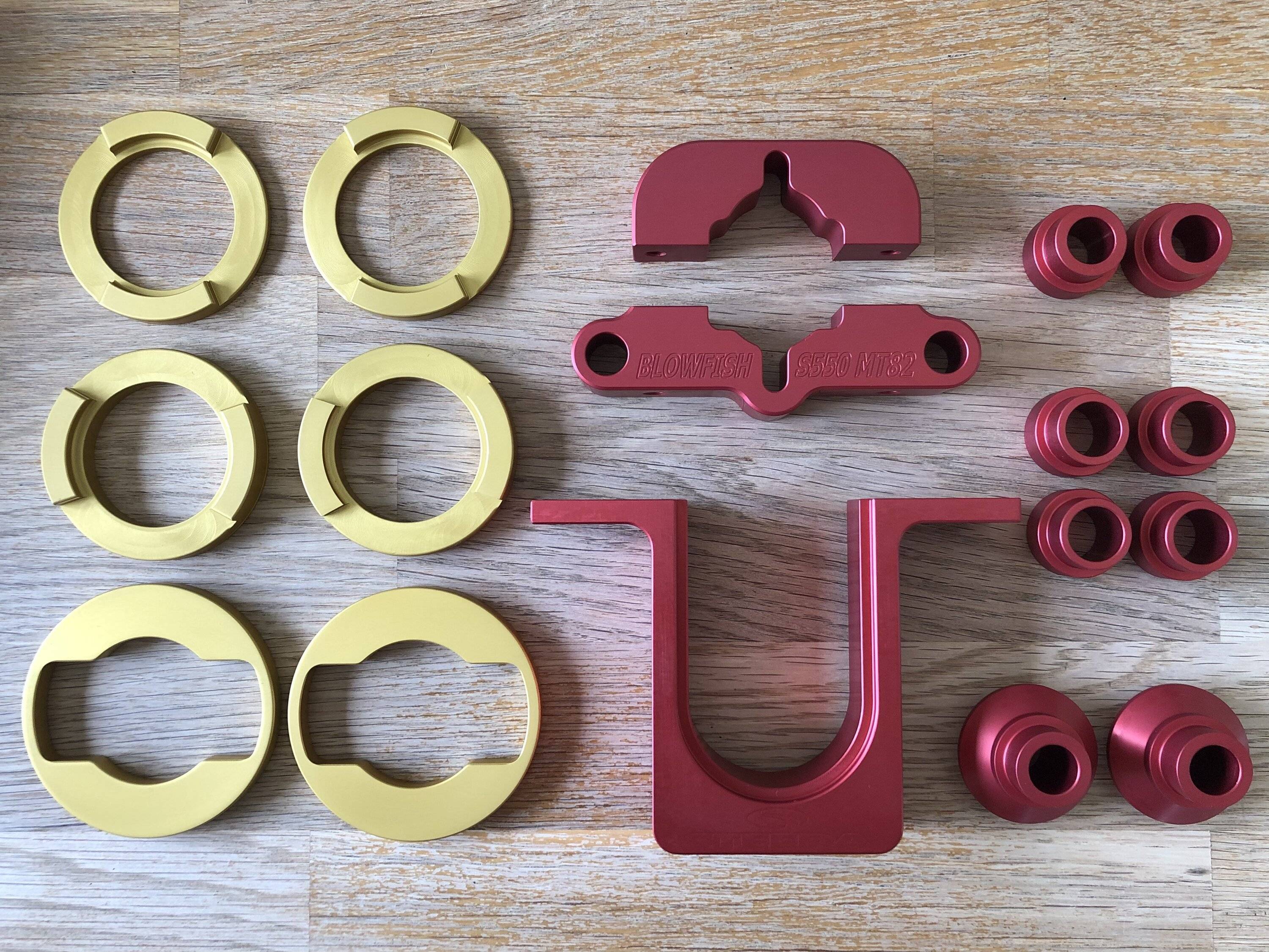

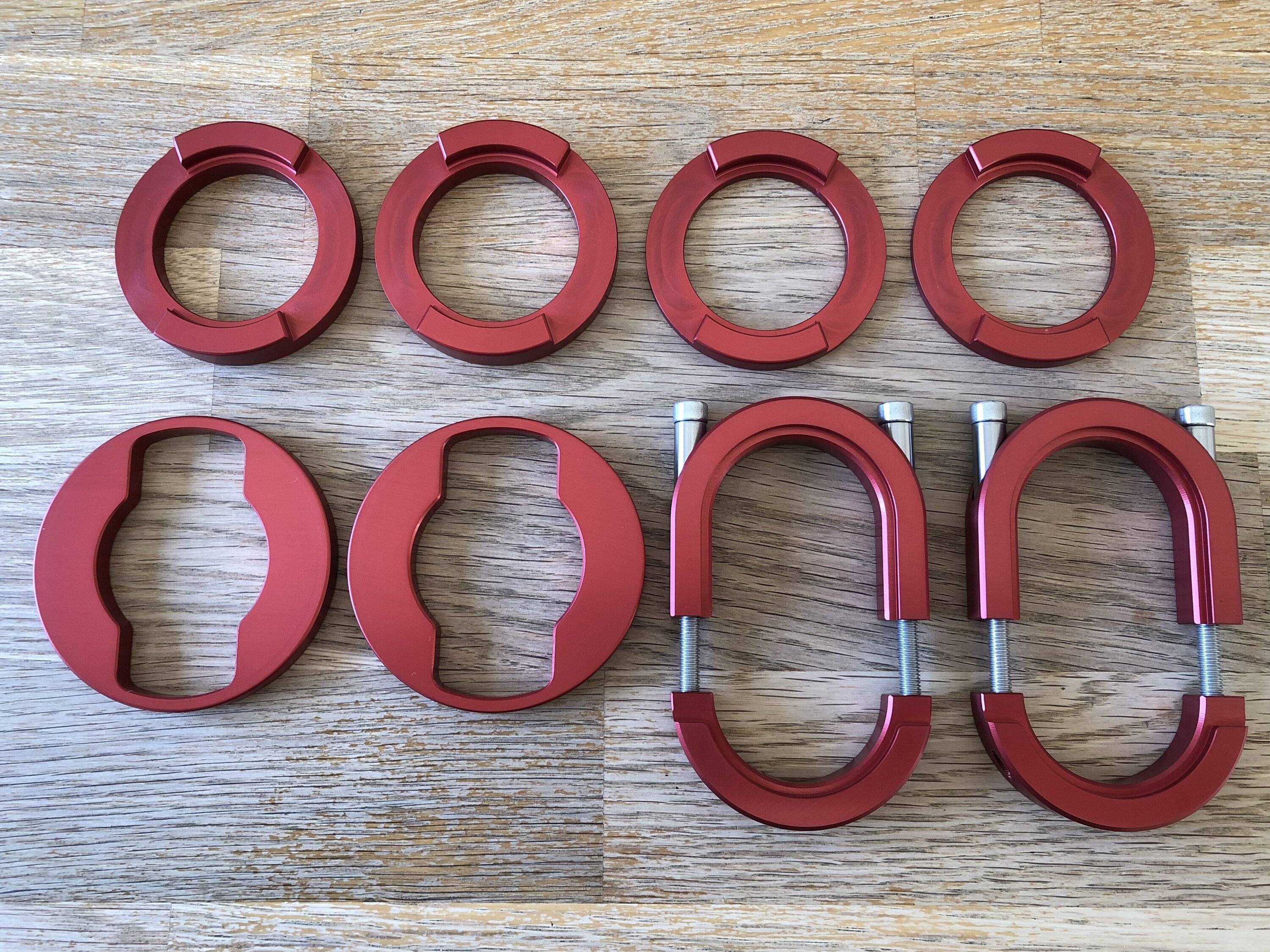

Maybe it’s like the Steeda kit i.e. just discard two of the items ? (On the part of the bush that normally takes the horseshoe clamps).
Red bits GT kit :
Gold bits Mach kit :
WD :like:
For anyone that happens to read this thread. Steeda has the subframe alignment kit 555-4450 that can probably work on an M1, but they recommend buying 555-4449 and 555-4438 separately, as it won't contain those horseshoe clamps, plus it is cheaper that way.
