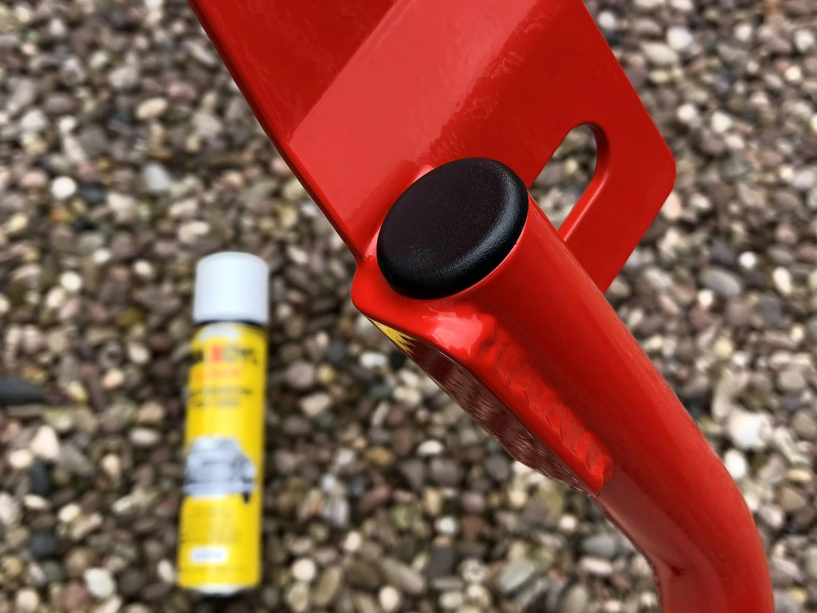

Now I got to find a powder coat shop... doh!
High heat rustoleum no good?
I was planning on Rustoleum for mine as well as my G Trac brace. They make a light blue that is close to Grabber Blue. I figure a few coats should be good enough
Powercoating is substantially harder than spray paint. The enamel version may be slightly better but it is still not very hard. Road debris will eventually chip it.
