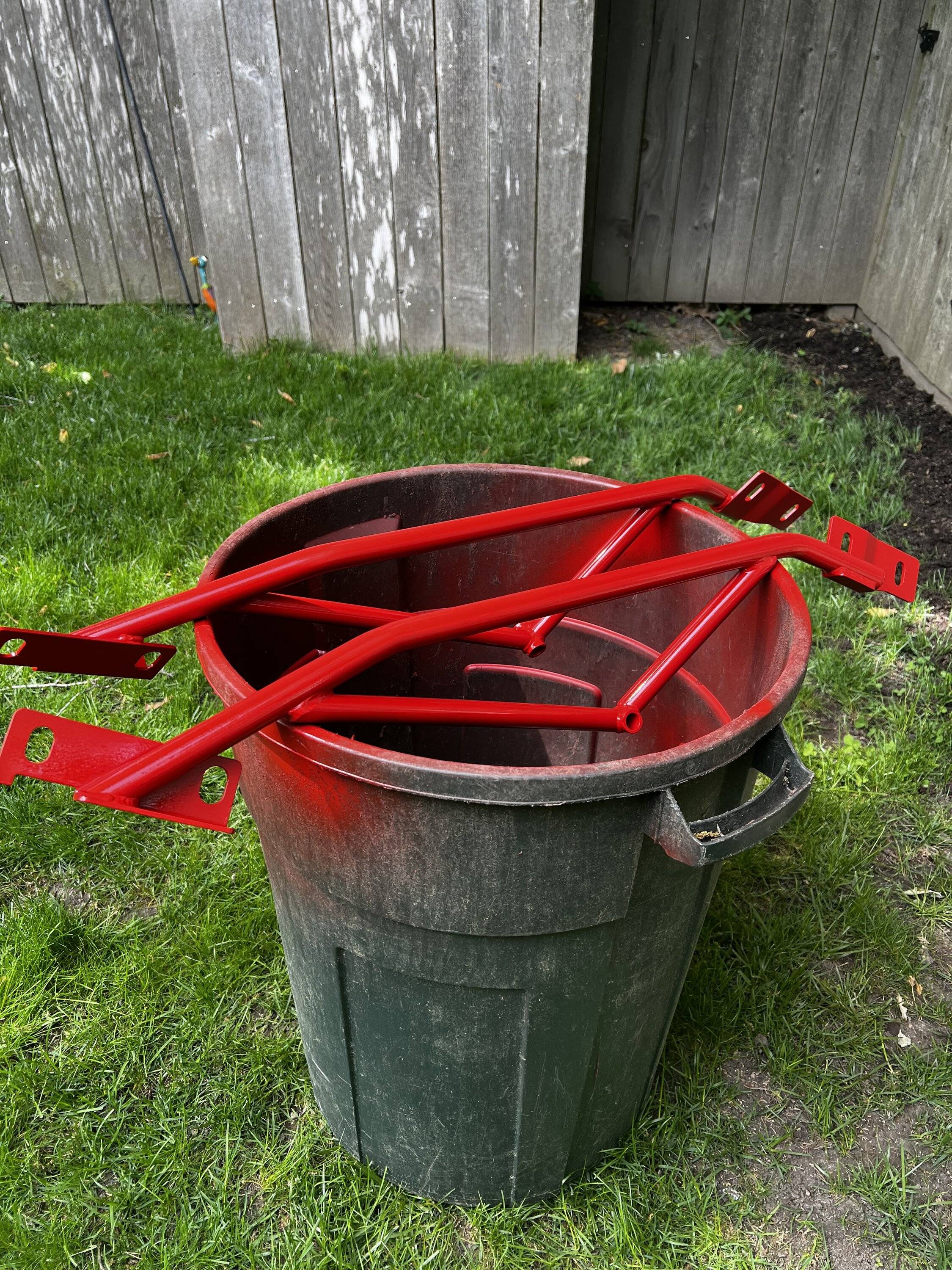

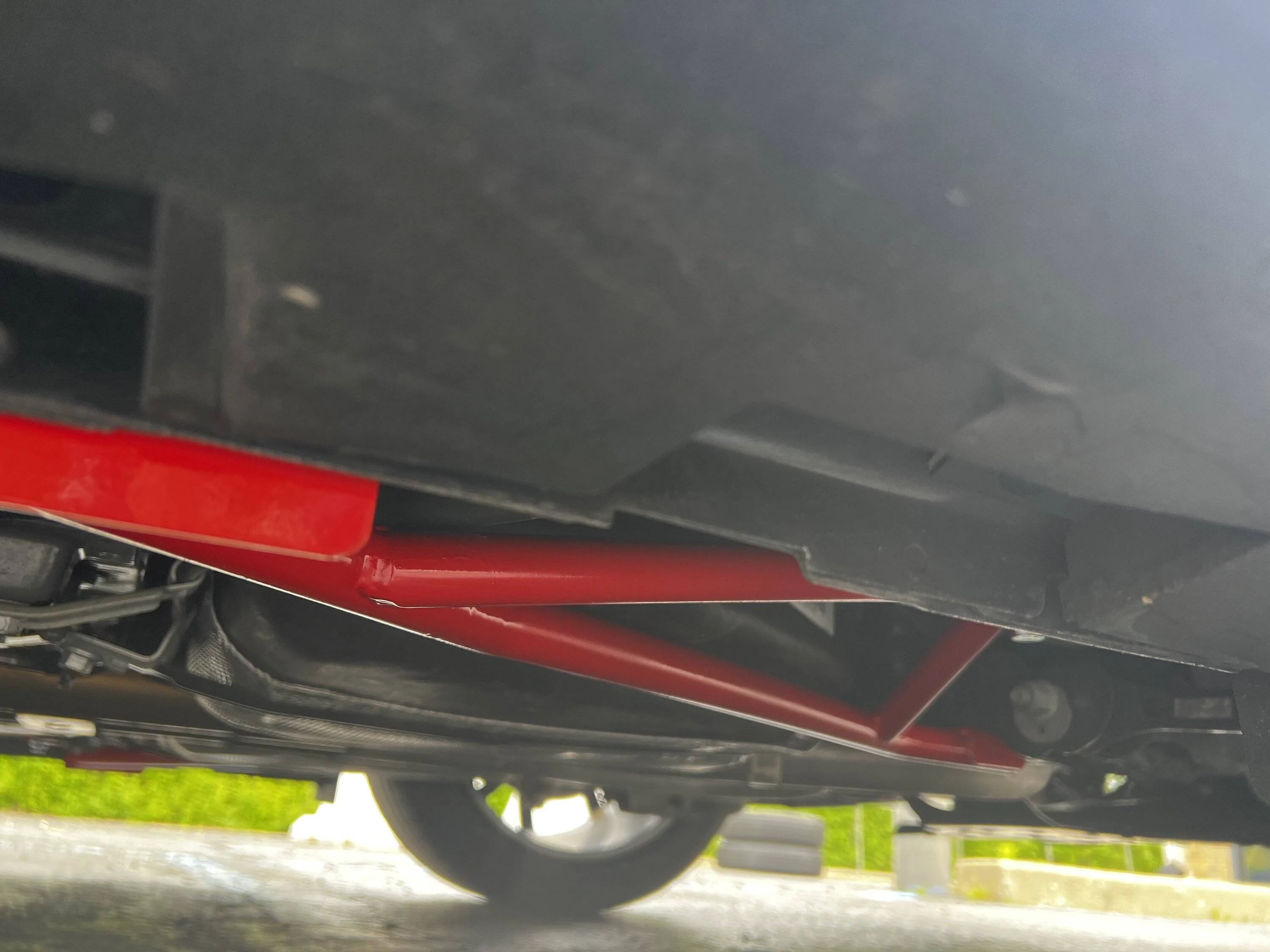

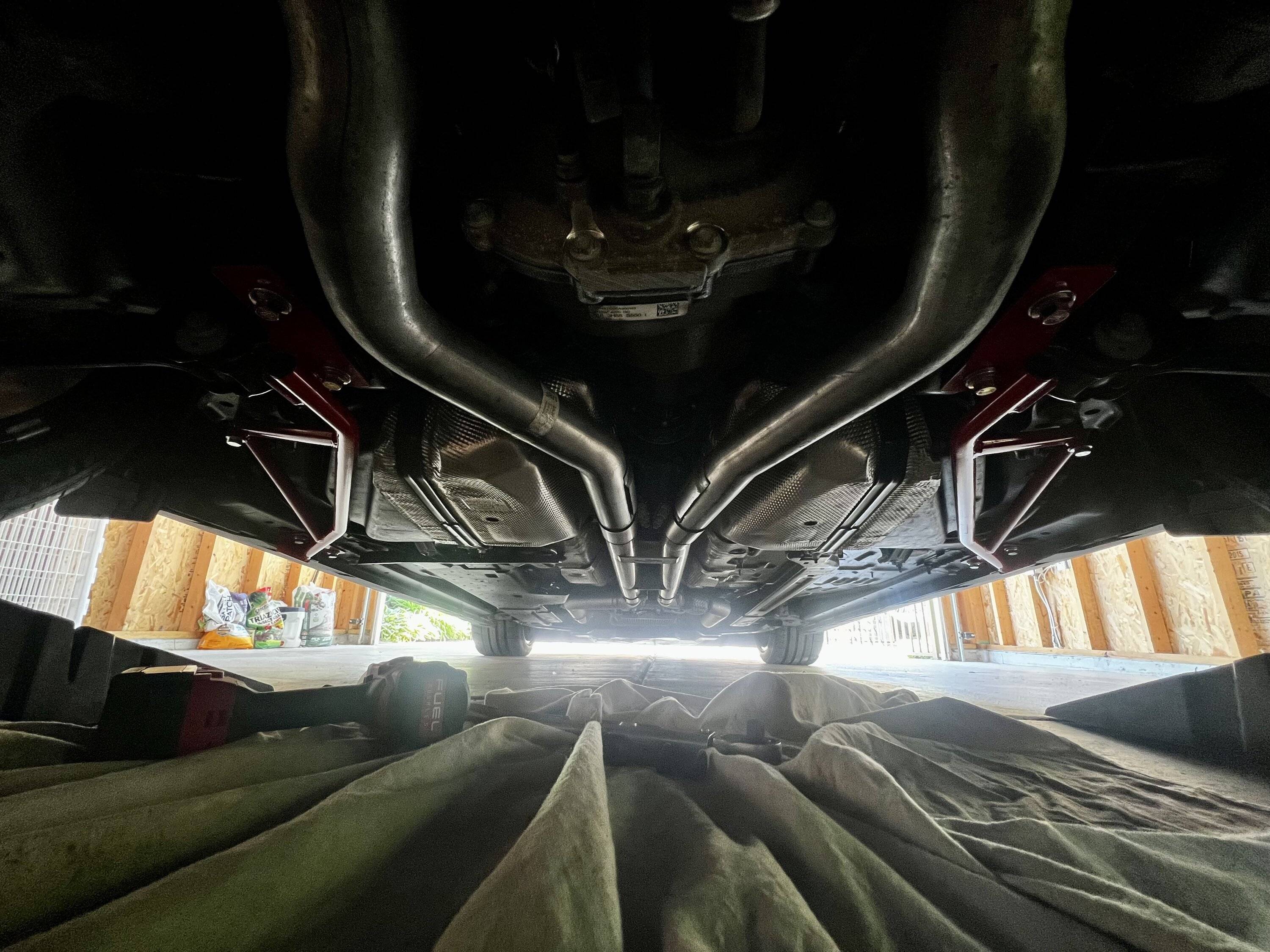

Hey all, I’d like to report that my painted Ford Red Subframe braces were installed Memorial Day morning.
Easy install, backed up on ramps, done in just over an hour.
I’ve tested them out, and I can honestly say I feel the same difference I felt in my 15gt. On/off ramps at high speeds, the car just turns so differently, feels like the rear is turning the car if that makes sense.
Also did some hard accelerations around turns to get the rearend to brake loose and it is now way more composed and easier to predict.
Hard to say if it’s improved traction from a dig as the temps are now warmer here so the tires bite better but the couple I did do sure hooked better than before I installed them!

Thank you for the feedback & glad to see Chris's feedback was on point!
They turned out nice too ... thank you for sharing!
