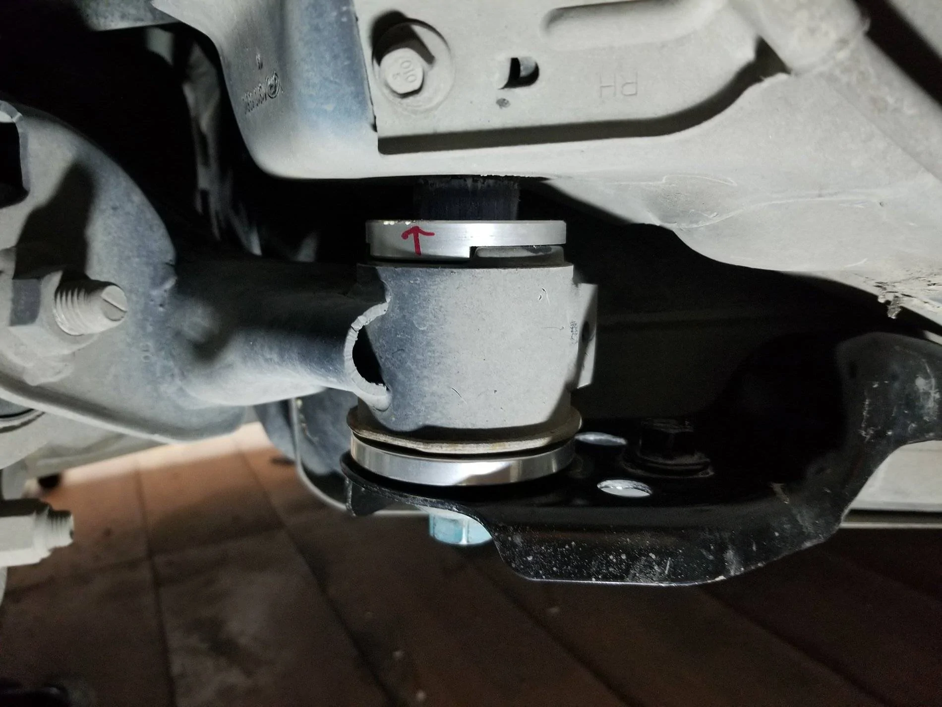

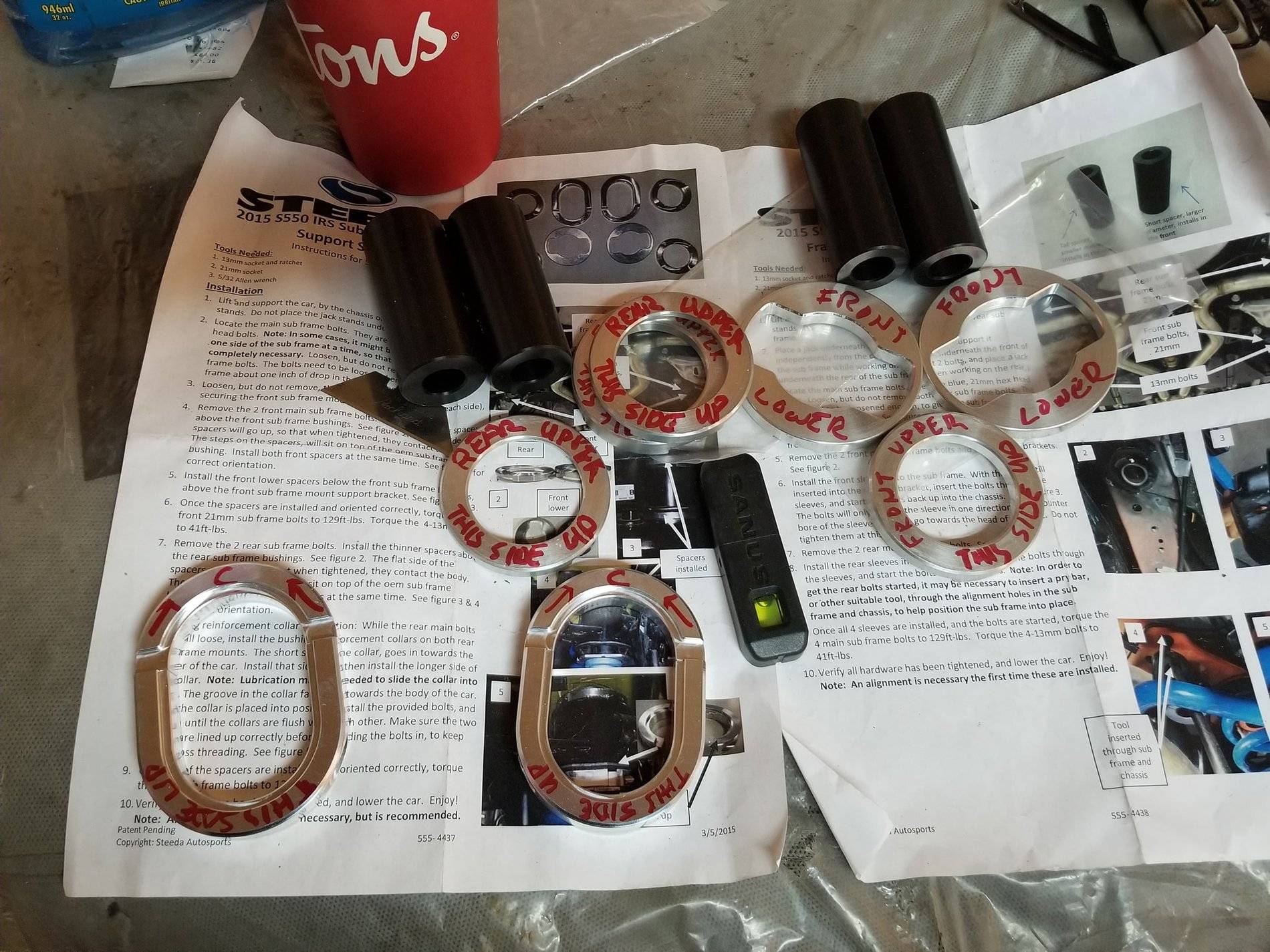

Here I marked everything so no chance of me fucking it up haha.

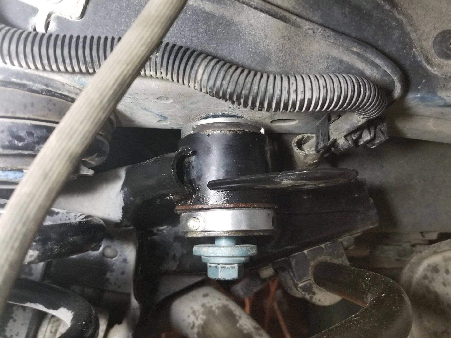

Here just making sure everything is aligned right before buttoning it up
The subframe bolts went back in no problem, and torqued to specs. Alignment booked for Thursday, but my initial measurements looks to be bang on. Kudos to @SteedaTech for a GREAT product!

I’m totally going to sharpy my pieces as well. good call.
Yeah remember too the alignment pins are different sizes as well. Front to back or vica versa won't interchange. Skinny front, fat back.
