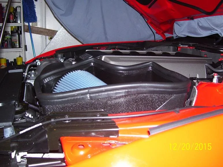

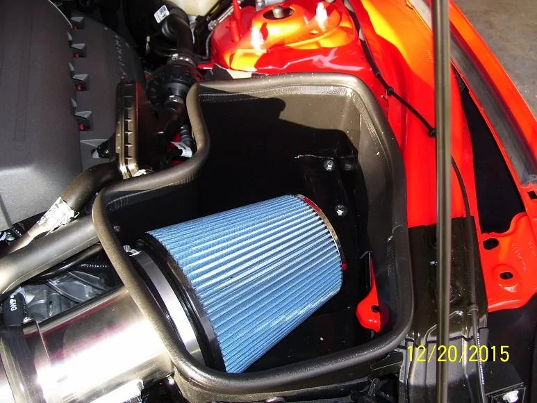

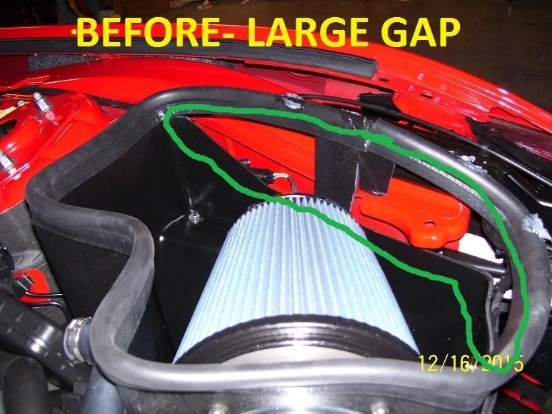

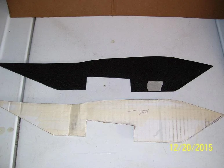

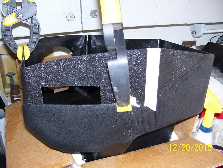

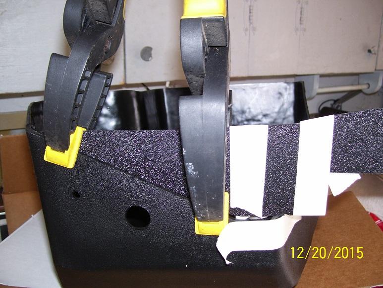

Closing large air cap

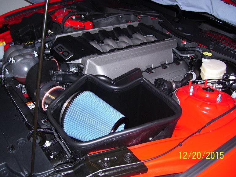

Finished sealing front and drivers side up to hood.. Great for Drag Racers:thumbsup: First pic before adding to air box, Last 3 pics after making ABS piece to fit the hood.

Looks great. Any way you could make some templates or even sell prefabricated ones [emoji16]
Nice. that's how the box should be from the beginning. :thumbsup:

how does the hood close much less not get pushed up... my box was 3mm too tall on one corner and pushed my hood up and had to be replaced
Thanks but it is a DIY project each air box is a little different for perfect fit;)
It takes some time to get the fitment just right! A lot of mods a little at a time for perfect fit :doh: Addressing a few other issues next before Drag Strip:thumbsup:

What plastic do you use?
Like I said in the other thread, there's a huge gap along the front and drivers side as you can see in his fab work. Same thing with JLT. Yours was a tiny bit higher in the back corner, closest to the passenger firewall. Based on how thick the hood liner is and the gap between it and the hood I suspect had you given it some time yours would have been fine. The tolerances of just the rubber gasket is more than 3mm.
