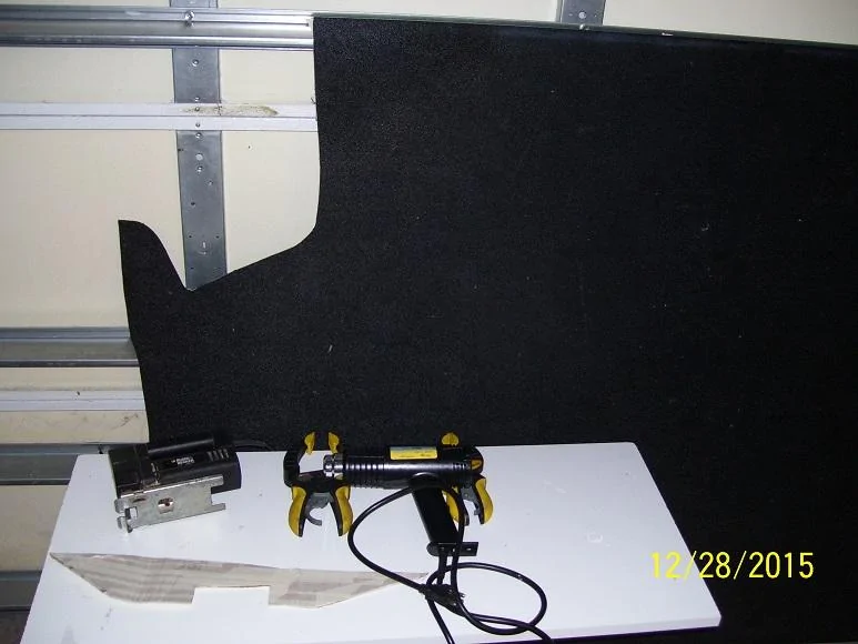

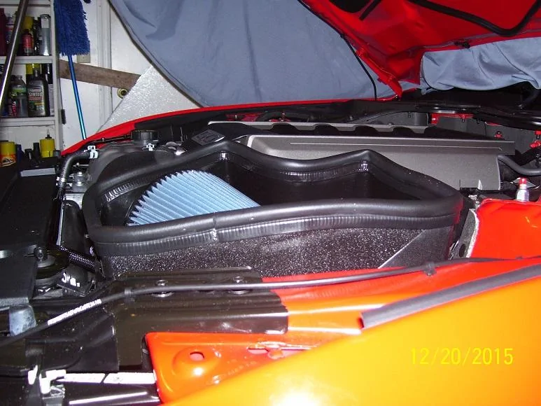

What plastic do you use?
ABS textured on one side 1/8 inch thick have used thicker before for other projects but 1/8 is easier to work with. HF heat gun jigsaw with wood blade thick cardboard masking tape to make template and a lot of time and patience. I buy the ABS at a local sign store`s scrap pieces.I will say it took a lot of time taking it in & out shaving a little in the right places to get the hood sealed :frusty:

[MENTION=18602]Stang Racer[/MENTION] great job, really looks good, almost factory-like. Interested in your IATs now, both while moving and sitting in traffic.

Nice job, that thing should have looked exactly like that from Steeda!

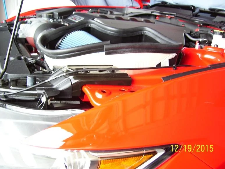

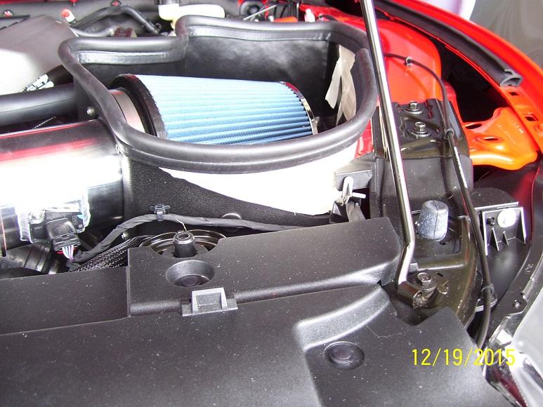

Finished sealing front and drivers side up to hood.. Great for Drag Racers:thumbsup: First pic before adding to air box, Last 3 pics after making ABS piece to fit the hood.
Did you do any comparison tests after your modification to see if the intake temps are lower when the car is standing still?
