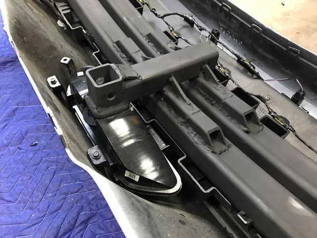

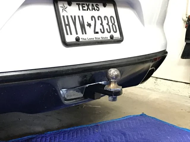

I have the custom hitch that comes out of the back up light. Looks great and worked well.

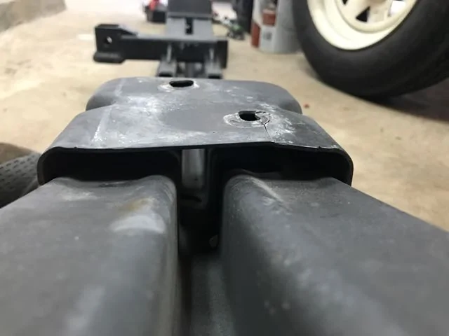

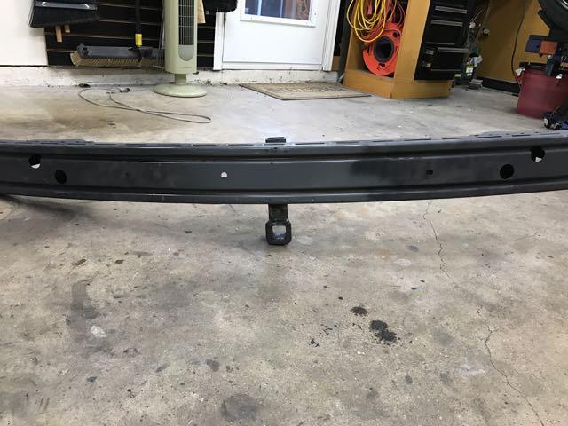

But there is a issue. The bumper beam itself is crazy strong so no issues with it. The bracket that mounts the beam to the car is the weak link. There is just enough flexing in the bracket that mine started to bend and stress crack.
The mounting holes on the car was the initially concern but they seem to hold up ok. My trailer was about 400lbs loaded with a 65lb tongue weight.
So it works but needs some improvement. right now I am back to a curt hitch until I decide if I want to build it again. I made the hitch myself. I don't know of any other options other than the curt style frame hitches for sale.

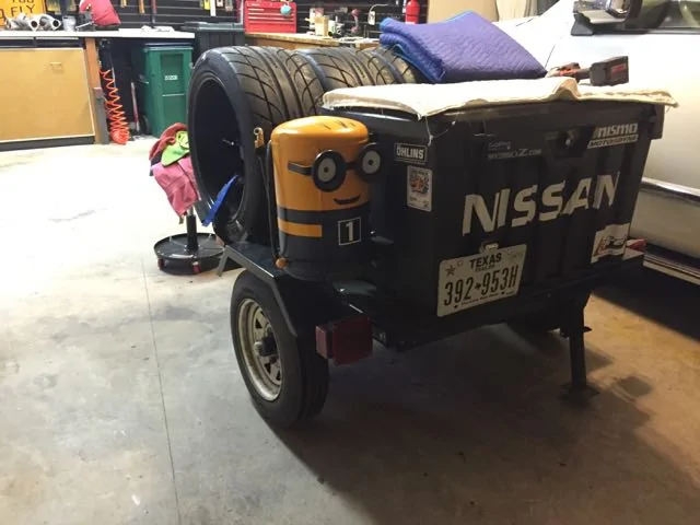

Little trailer for track tires and tools.
That's great info, thanks a ton for the pictures.
That bracket as a weak link is probably going to affect tow hooks which attach to the bumper. Something to keep in mind.
I chose the FP tow hook because it bolts to the bumper which means alllllll of the bolts that hold that crash bar on are in play when pulled on. Hopefully it’s good.
Steid6G, that's not surprising since the bumper bar & associated brackets are meant for a different kind of load. They are only designed to absorb and dissipate force in an impact, not have something hung from them. That drop bar gives your 400# trailer some nice leverage on all those brackets every time you accelerate or stop.
I'm guessing they tow hook is ok because it's really intended for rare use in pulling the car from a ditch or something or strapping it to a trailer/flat bed.
What would be cool is a hybrid of the Stealth hitch and your solution.

I agree that the bumper should be good for a tow hook as long as your not stuck to deep in it!
I think my metal fatigue came more from the up and down motion while driving than actual start and stops. I tried to keep both the vertical and horizontal lever arms as small as possible. Try, live and learn!
The stealth hitch looks nice, it will be interesting to see what they come up with. Its a tight fit with mufflers, spare tire well and evap stuff.
My main reason for this solution was to keep weight to a minimum. The whole thing was under 4 lbs. I guess the next one will have to have some bracing added to it.
Yes, pay attention factory engineers. Give us a point for a hitch that doubles as a point for a tow hook.
Maybe a new standard for only a 1000lb rating so it can be downsized so it is as clean as possible. Like a 1x 1/2" receiver vs a 1.25" square for a Class I hitch.
