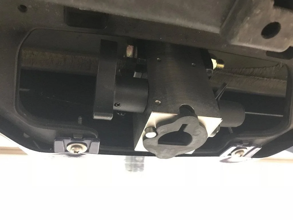

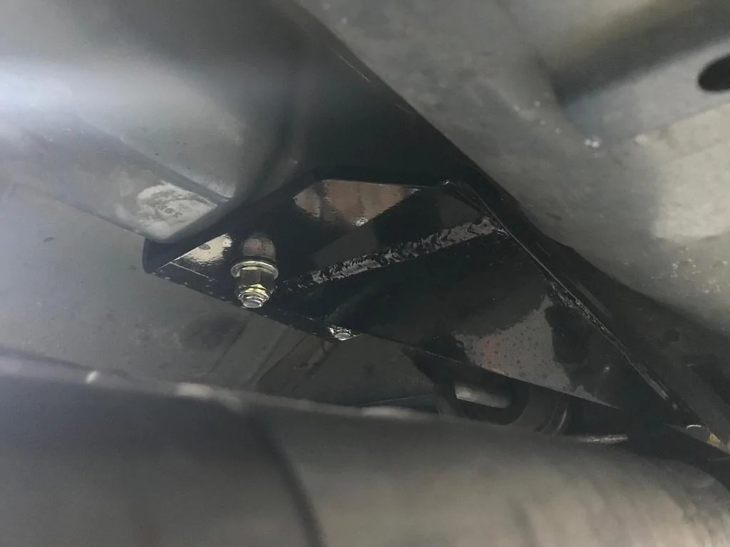

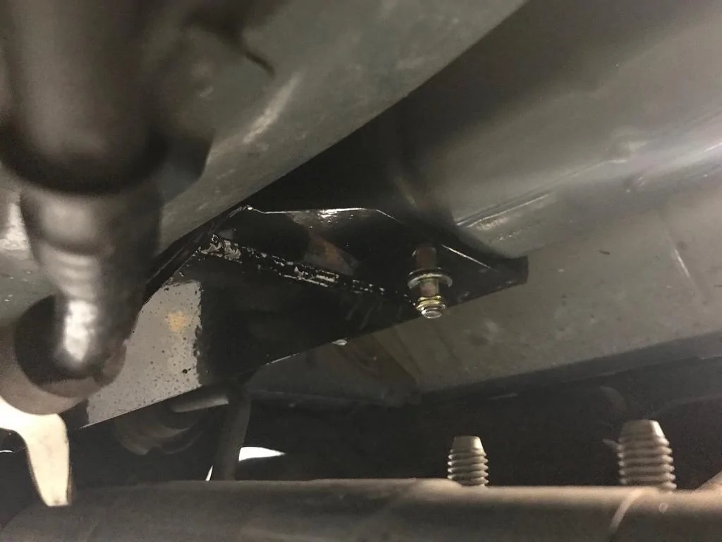

I did my best with these pictures, y'all. Sorry.
Stealth Hitch needs someone with a stock exhaust to verify fitment with actual mufflers. I suspect some minor gusset modification is needed. That is the only holdup before they go on sale. I am trying to find someone in my local area that is willing to let there car be a mockup and Stealth Hitch will give them free installation and a discount (not free). They're located in Sugar Hill, GA.
As you can see, it mounts to the strongest point in the immediate area with 4 bolts per side. They did strength testing and it can out tongue weight the available competition, so I'm told, by a good margin (although the suspension may not be suited for much more). When I was there, I told him that it needs to be able to tow a tire trailer (for which I estimated up to 500 lbs), be able to have a tow hook attached to it and survive a car being pulled out of the kitty litter at a track, and hold bikes on a bike rack.
I didn't have lighting available for any other pictures.
