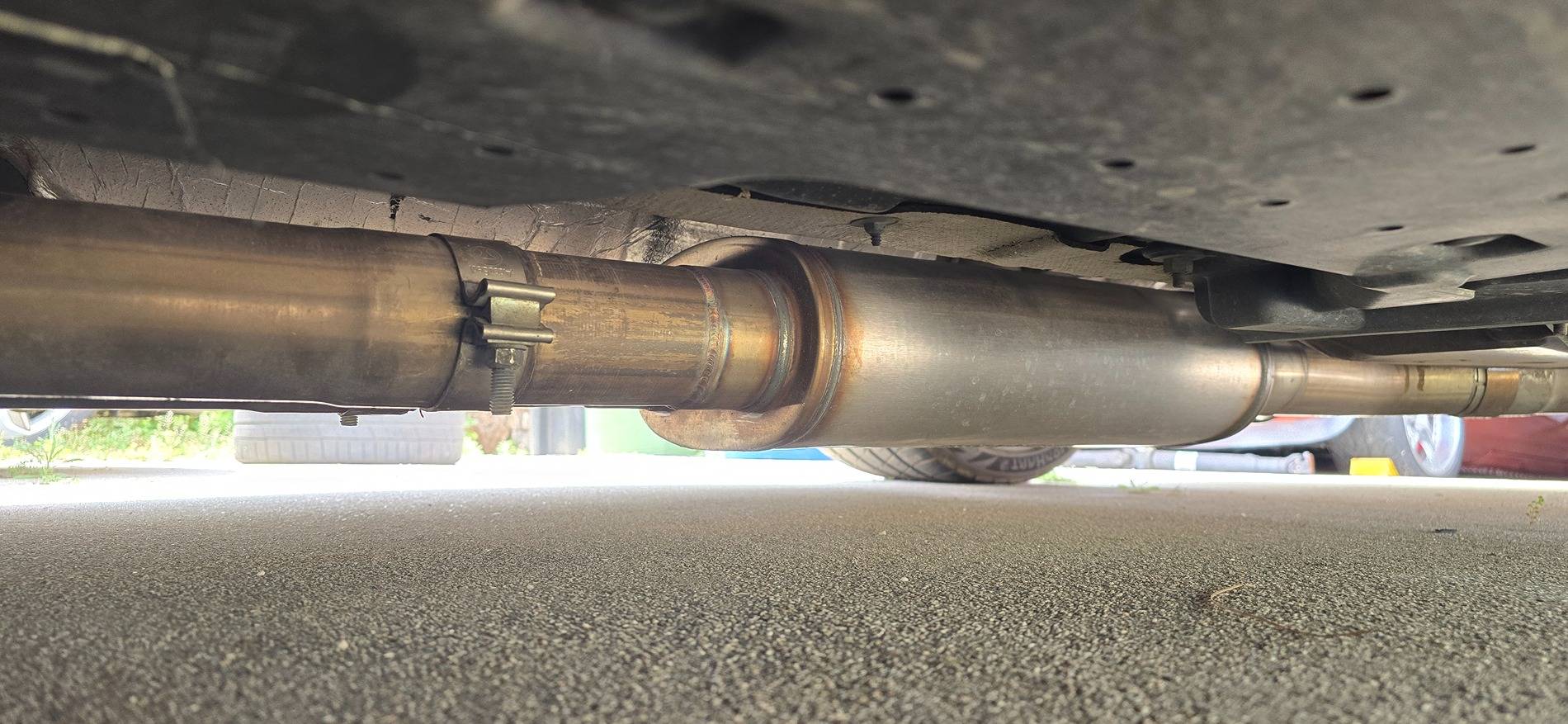

It sits about 1.25" lower than the hpipe, but not that bad. It barely scrapes over taller speed bumps.
My car is lowered about an inch, 275/35/20 and 315/30/20 MBRP lth, i cut up my mbrp hpipe to put the Magnaflow 12469 abd I MBRP street catback and hi flow cats.
The car is great to drive now. The chewbacca taking a shit sound is gone, the rasp is gone. I can actually cold start my car at 4am and my neighbors don't hate me.

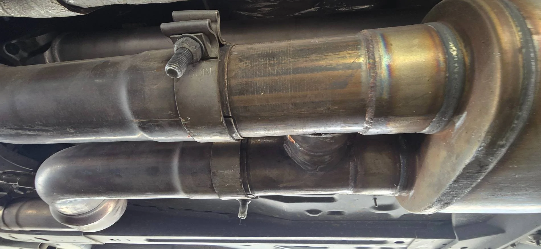

Ok thats exactly what i was curious about because i have the ford performance lowering springs that i will be putting on which i think is a 1 inch drop. I was planning on doing the same thing by cutting up the mbrp h pipe to put this on.
When i talked to the muffler shop about coming in today he didnt bother telling me he would not be working today so now i cant make it there until next week. Im going to order the 12469. Did more driving today in the city its not so bad under 3k. It seems like whatever frequency this exhaust is now that on back roads with trees on both sides it really amplifies the rasp.
Edit: do you happen to have any pics of how the 12469 is welded to your h pipe? I was thinking i could show the muffler guy here.

I might be under it today to do some maintenance. if I get the motivation, I'll send some pics.
The shop kept the hpipe portion and installed the 12469 right after it. It almost only fits in 1 spot. But the sound is the best I have heard out of my car. No rasp. The blowoff valve for my Vortech is louder than the exhaust

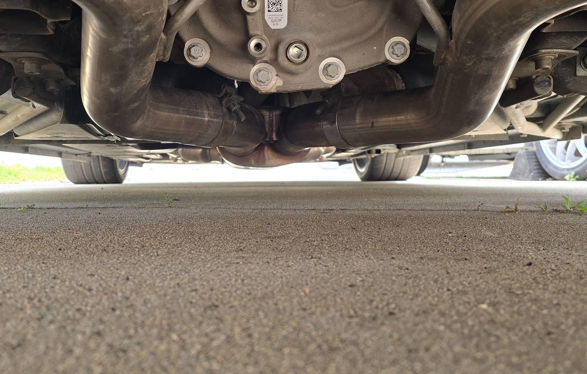

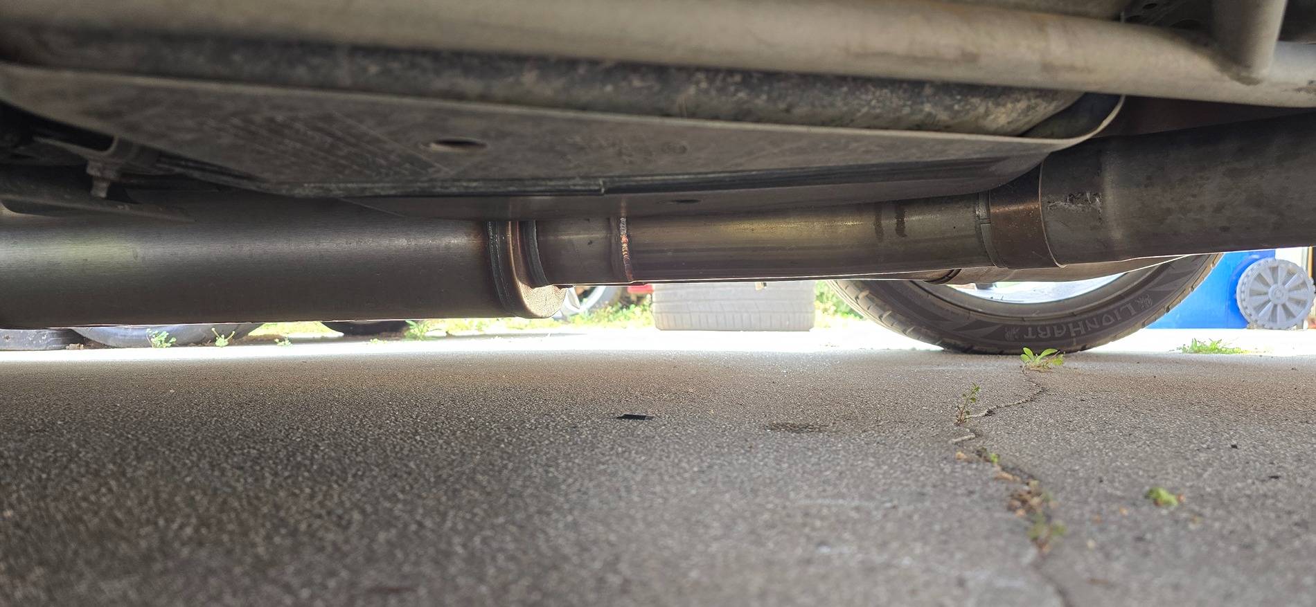

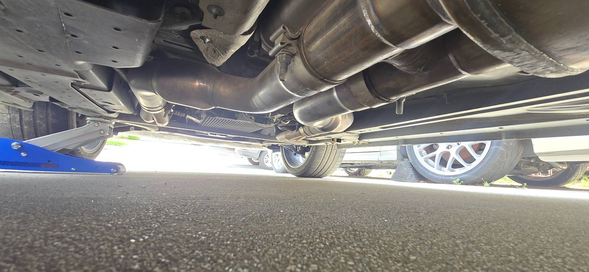

I took the shot from the back so you could compared to the rear pumpkin.
We probably could have gone up about 1/2" more, but it would have taken a lot of time and money I didnt have to modify the exhaust. Next time I have it in the air, I will loosen the clamps on the catalytic transition pipes and see if I can rotate it up slightly without hitting the tunnel.
Thanks. Looks good. I cant think of too many places i would be driving my mustang that has speed bumps so i think i will be ok once i lower it.
