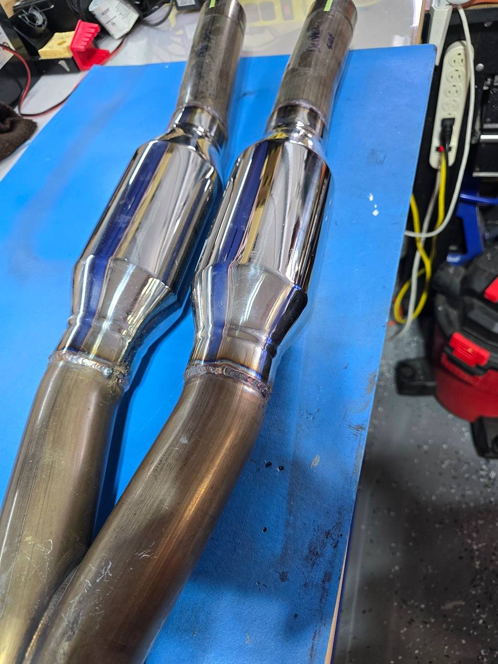

1 old racer
Feb 20, 2018
89
1,723
2,375
Fontana CA
Will
2018 Royal Crimson GT PP1 prem., and others
I did this myself
to my x-pipe without any issues and they are 12" long.
