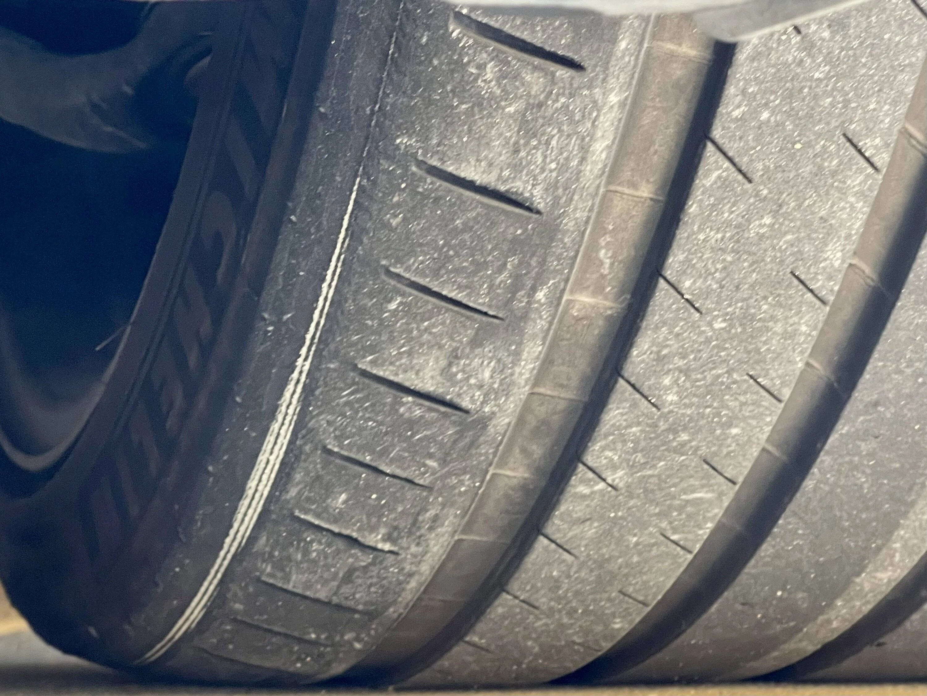

This is the typical failure pattern on GT350's and GT500's. You can see there is still tons of tire left on the outer edges. If you evenly distribute this wear across the front and rear you'll absolutely extend tire life of the "front" tires. Will this also transfer additional wear to the "rear tires", yes probably so, but at least now you're likely replacing all 4 at the same time as opposed to having mis-matched tires when you only replace the fronts.
So is this wear from too much camber on the street? It seems like from what I've read lots of camber on the track is what you want so you don't wear out the outside of the fronts. Does a person need to adjust the camber and toe if your running on both the track and street?
I think it has more to do with the toe settings and caster curves of the GT350 and GT500 front suspension. Additional camber only makes those issues worse.
