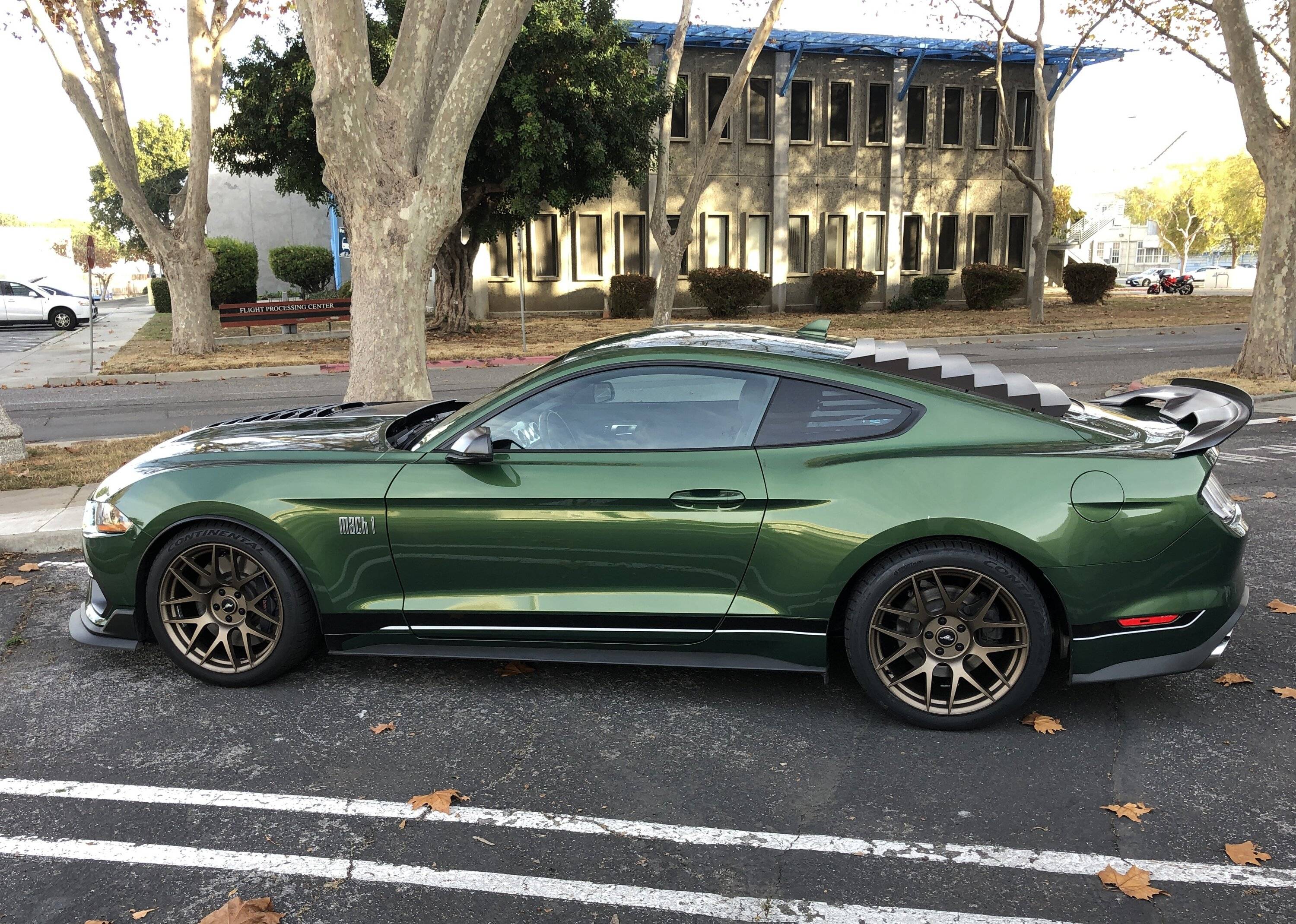

I just went with my winter square setup, 285/35R19 Continental Extreme Contact DWS06 Plus on 10x19 SVE R357 wheels. Loving it, especially in the rain.

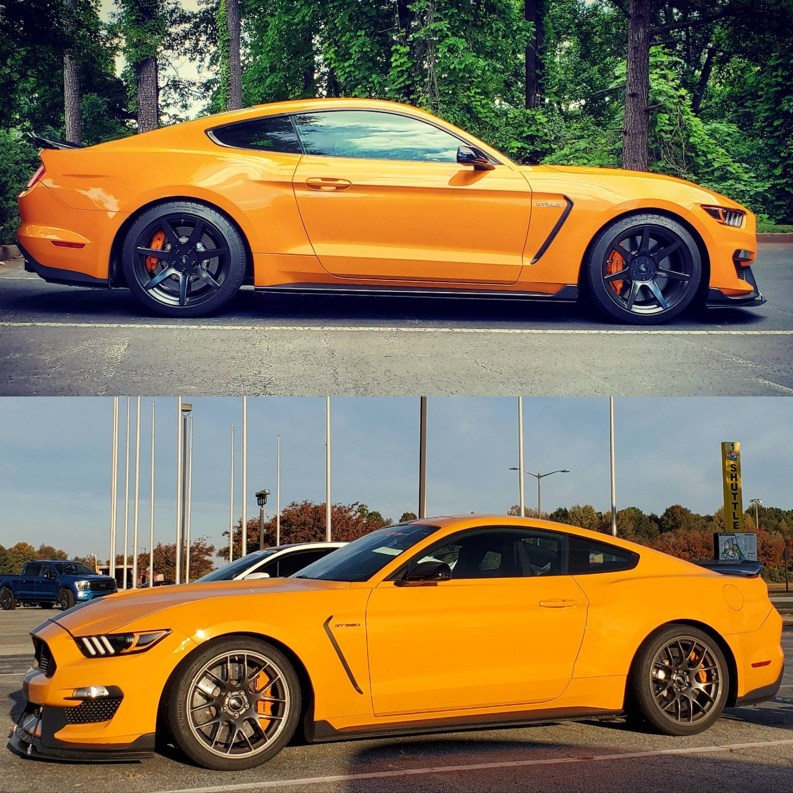

Hey this is Junior from Project 6GR, on the GT350 we normally do 305/30/19, 325/30/19. We think that looks best on the shelbys. With the 295/35 up front you might get a reverse rake on how the vehicle sits.
