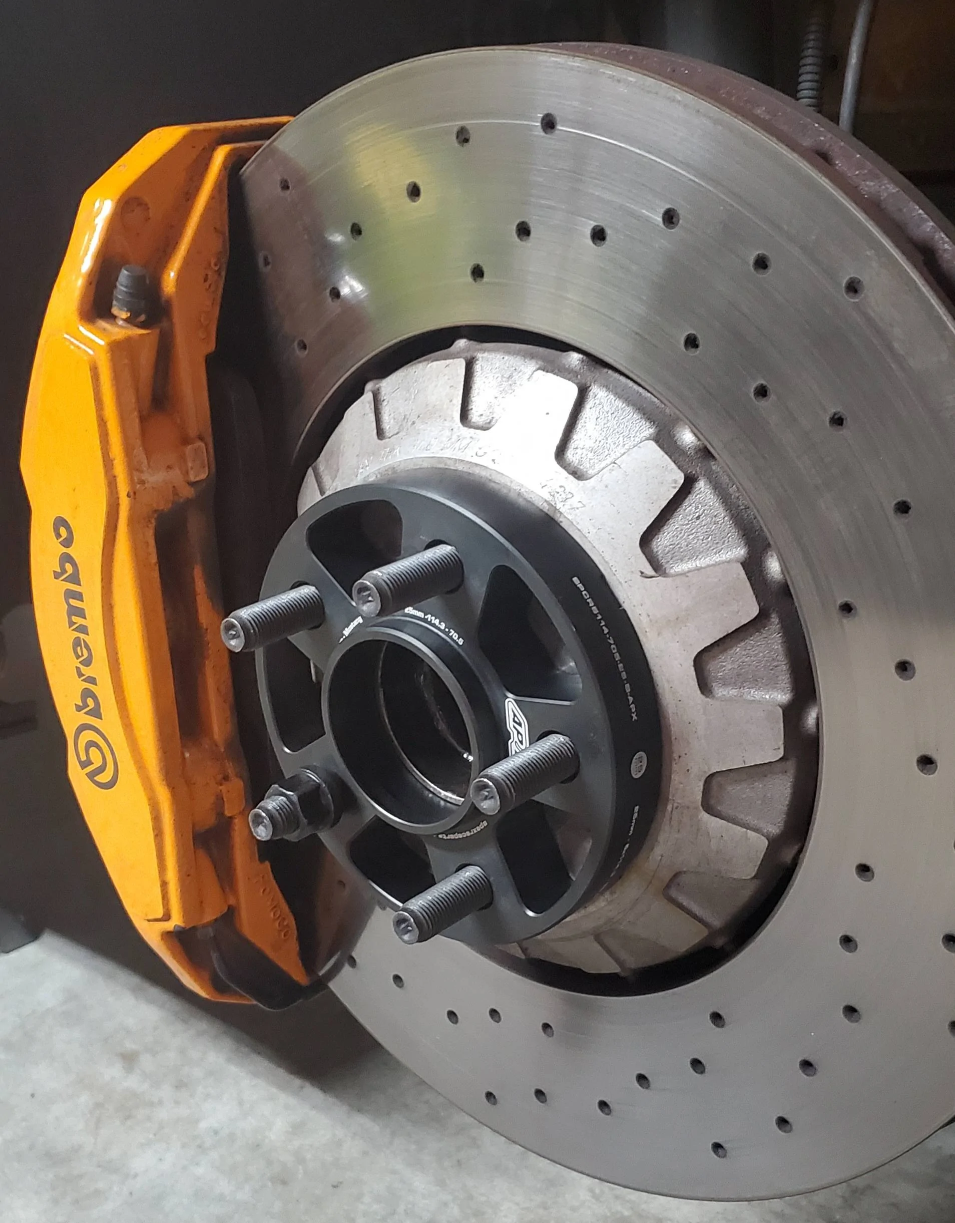

Anyone have an issue with the studs sticking out too far through the spacer and contacting the wheel? My APEX are +52 with 25mm spacer and when I just tried them, the wheel still needed about another 3-4mm to still flush. They're SM-10s.

Are you using bolt on spacers? We are all using extended studs with 25mm hubcentric spacers. I would not trust bolt on spacers for anything more than casual street driving.

Ah ha! Ok well that makes sense. My project for this week. Thanks!

Awesome. And the studs to use are the ARP 100-7732.
There are a couple of options. I'm actually running Ford studs from like an F250 or something. Can't remember exactly what the part number crosses over to.

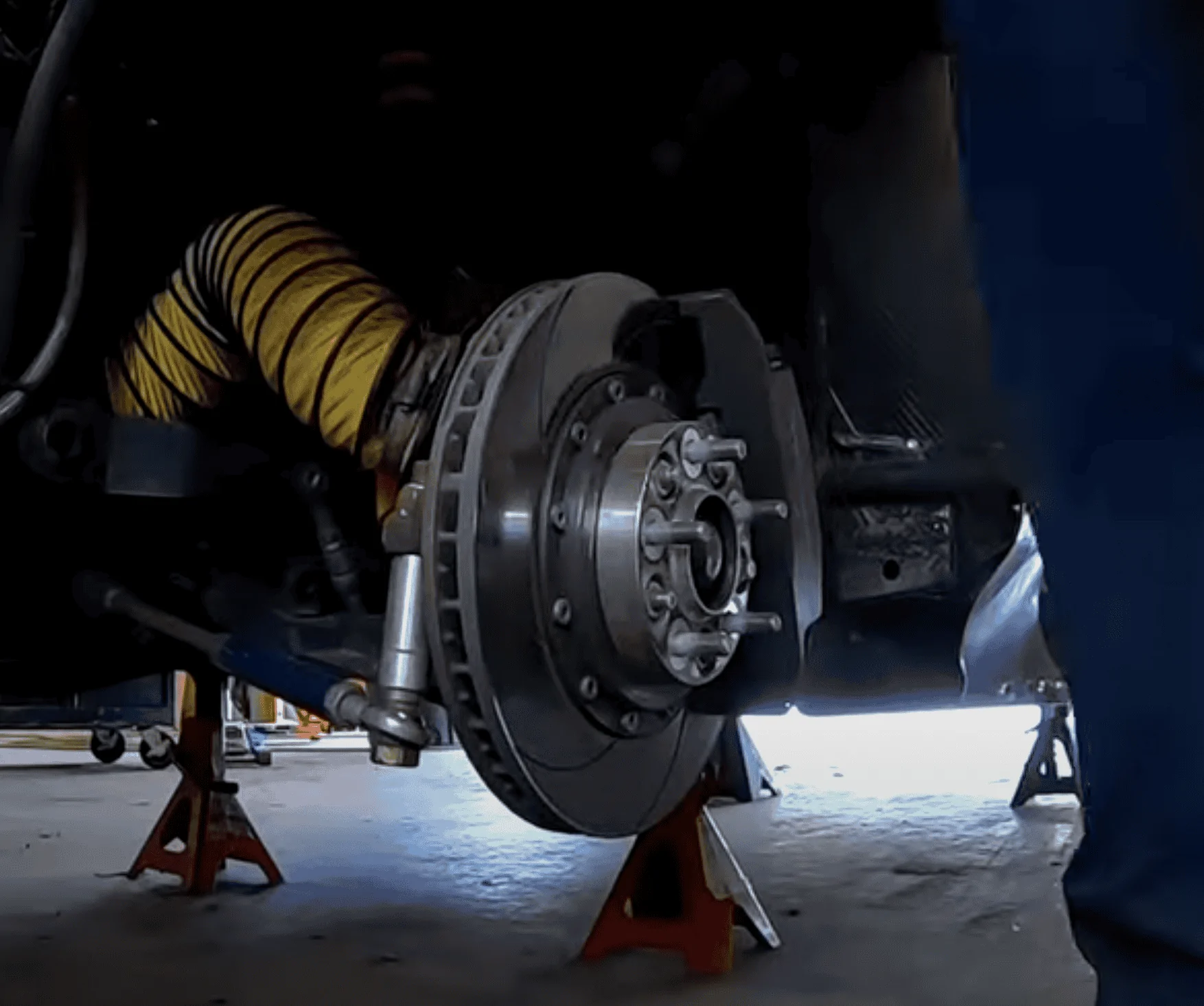

I understand the logic and I don't use them myself, but if you go to 16:48 in this video of AJ Hartman putting a splitter on his race car:, you'll see that bolt-on spacers don't seem to concern him:
They're pretty hard to miss:
There are always outliers, but in general, the preference is always for slip on vs bolt-on.
