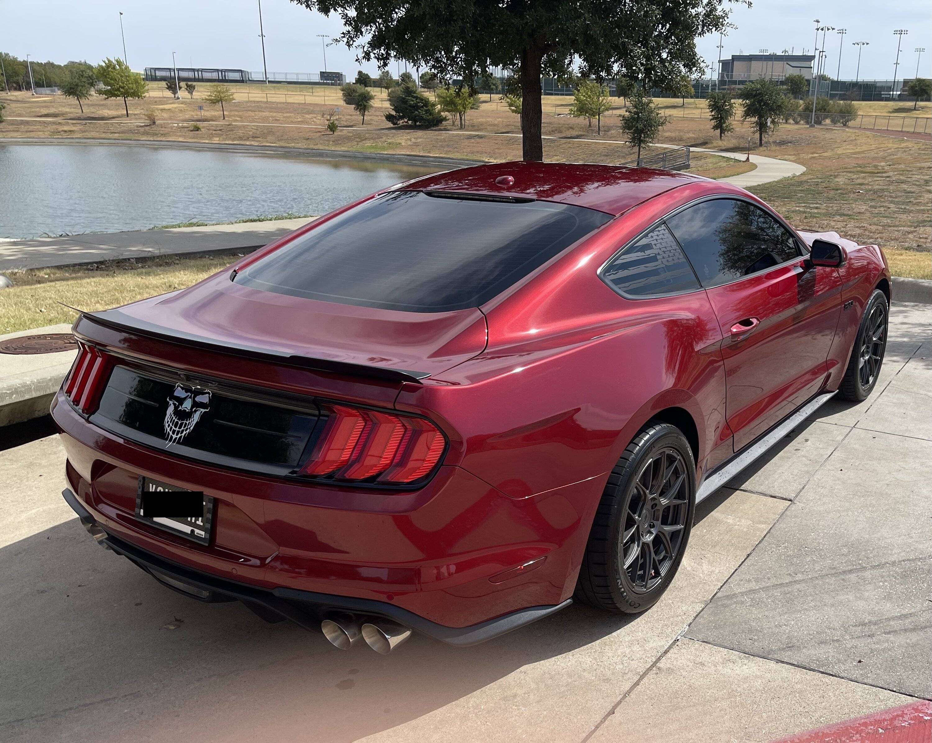

The reality is just about any car can be made to understeer depending on how its driven or not driven. It goes the same for bikes. There are benefits to having a wider setup in the rear, and it doesn’t have to be a rear engine car to benefit from that. If you’ve had an r or a 500 on a track it becomes very obvious with the type of corner where the wider rears come in to play. You can absolutely feel that in your arse in the seat. That was very prevelent on the car in the picture when it was boosted. Not as much in the stock configuration but it was still there. I get why the straight setup is pushed and preferred by some and thats fine. Wether its been two wheels on a track or a car the one area out of all that I’ve never chosen to try and save a few bucks is tires. The caveat to that being trying to put it on the limit. Now this is completely different for a daily driver and even more so for those that want to enjoy there cars in inclement weather. We can all have our preferences based on our own experiences and thats fine to. The one thing in all this I will say is I feel bad for those that have these cars and dont atleast once put them in a road course. They are absolutely amazing and theres no way to truly experience that without it. Best of luck to the OP, the conti’s are a very good tire If he choses to go that direction regardless of setup.
