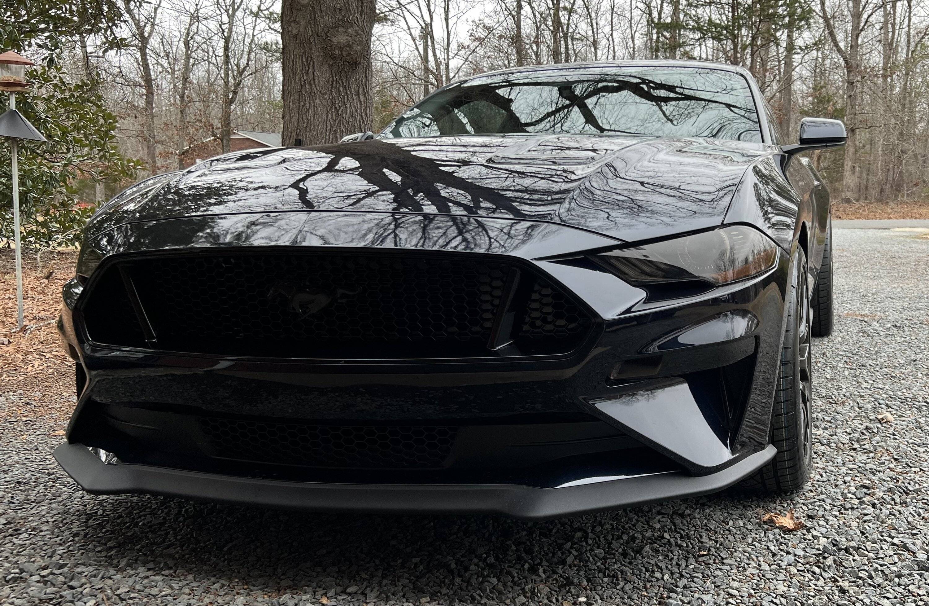

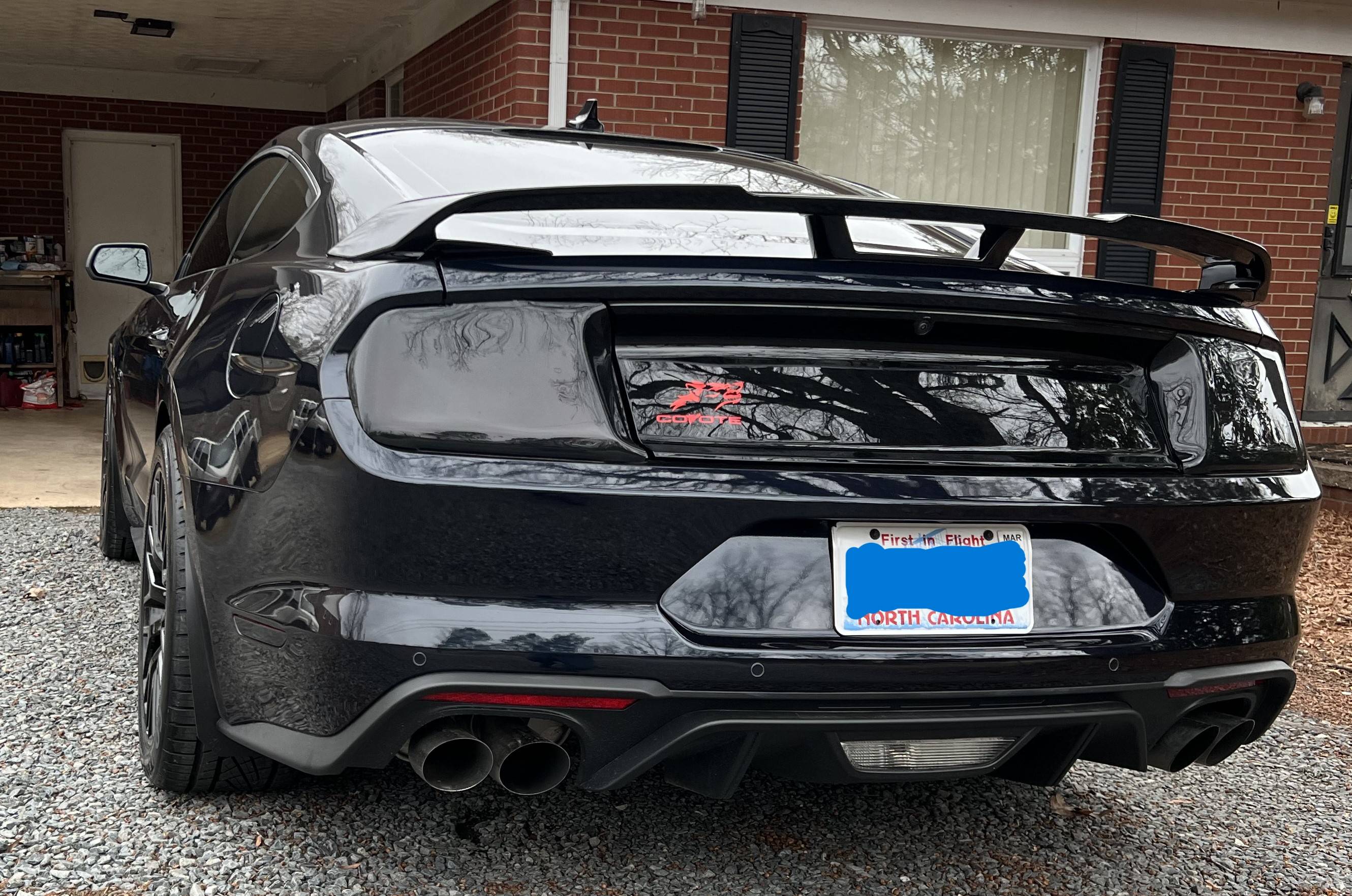

For anyone curious, this is what 1" spacers do for front and rear views.
PS. Antimatter Blue is pretty much black unless in bright light.
