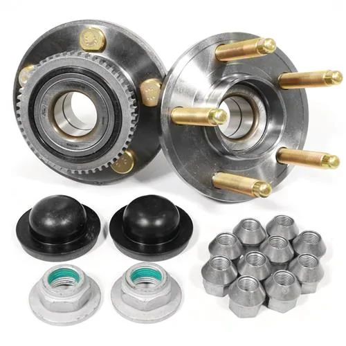

What hub conversion?

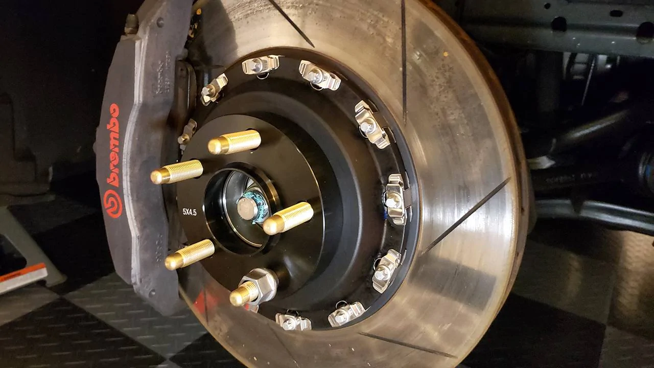

I put these on yesterday as well as a 25mm spacer to accommodate a 19x11 +52 offset wheel. Now I can swap wheels front to rear.

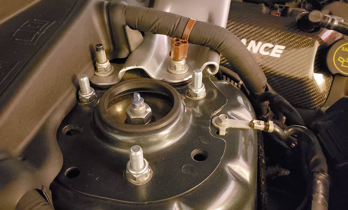

I ran a -2.7° last season and I was still cooking the outer edges too. I drilled out my shock towers to gain a little more. Thinking about doing 3° this season.
If you want to see how I did it. I've done several car in my area. I have to upgrade my bracket now though.
