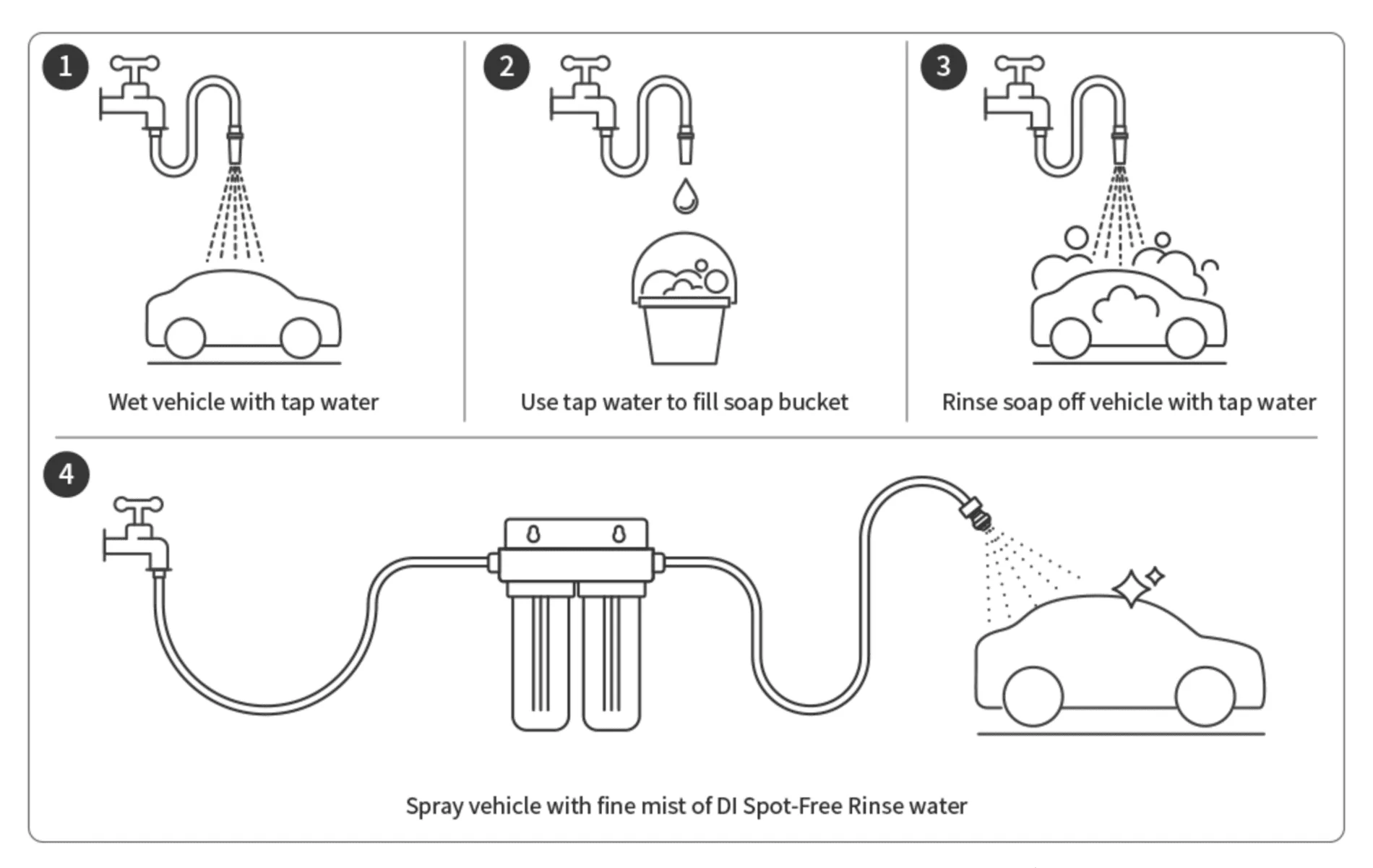

I just spent some time reading up on this unit. It is supplied with a pressure regulated tip fo rinsing. It gives you 0.75 gpm for rinsing.
I think this is perfect for someone like me who isn't massively invested in a top of the line system. It should work just fine for what I need it to do. I'll plumb this inside my garage with a diverter valve that I just turn when I want to rinse. I'll get a coiled small diameter water hose to stretch out to the driveway when I rinse the car.
I also should have read the description first, as it's clearly listed to use this for rinses only. I have zero experience with any type of water filter, but this seems easy enough.
That's input pressure, not output. Even at .75 GPM that would be quite weak to rinse off a car with.
You are right, I stand erected.

IIR, CR Spotless says their unit will use up to 3gpm. But, I crank the output pressure of my PW way down to 600psi which is less than half full pressure so I figure I'm rinsing only with with about 1.5 gpm. All you need to do is replace the last rinse water with the DI water to remove any remnants of non-DI water. You don't want to use DI to rinse the soap off, is what I mean. That's wasteful with regard to the resin in the carts. Takes me I'd guess five minutes to do the final DI rinse.
That is approximately 7.5 gallons of resin life used out of the three hundred they advertise. Figure thirty-five rinses at least before having to replace the resin.

Not to talk down to anyone but the reduction in flow is to allow the resin to do its job. Increase the flow and the less time it has to remove ions. And you don’t need a lot of flow to rinse a car. I prefer a full flow without a spray pattern as it allows me to sheet the water off the surface.
