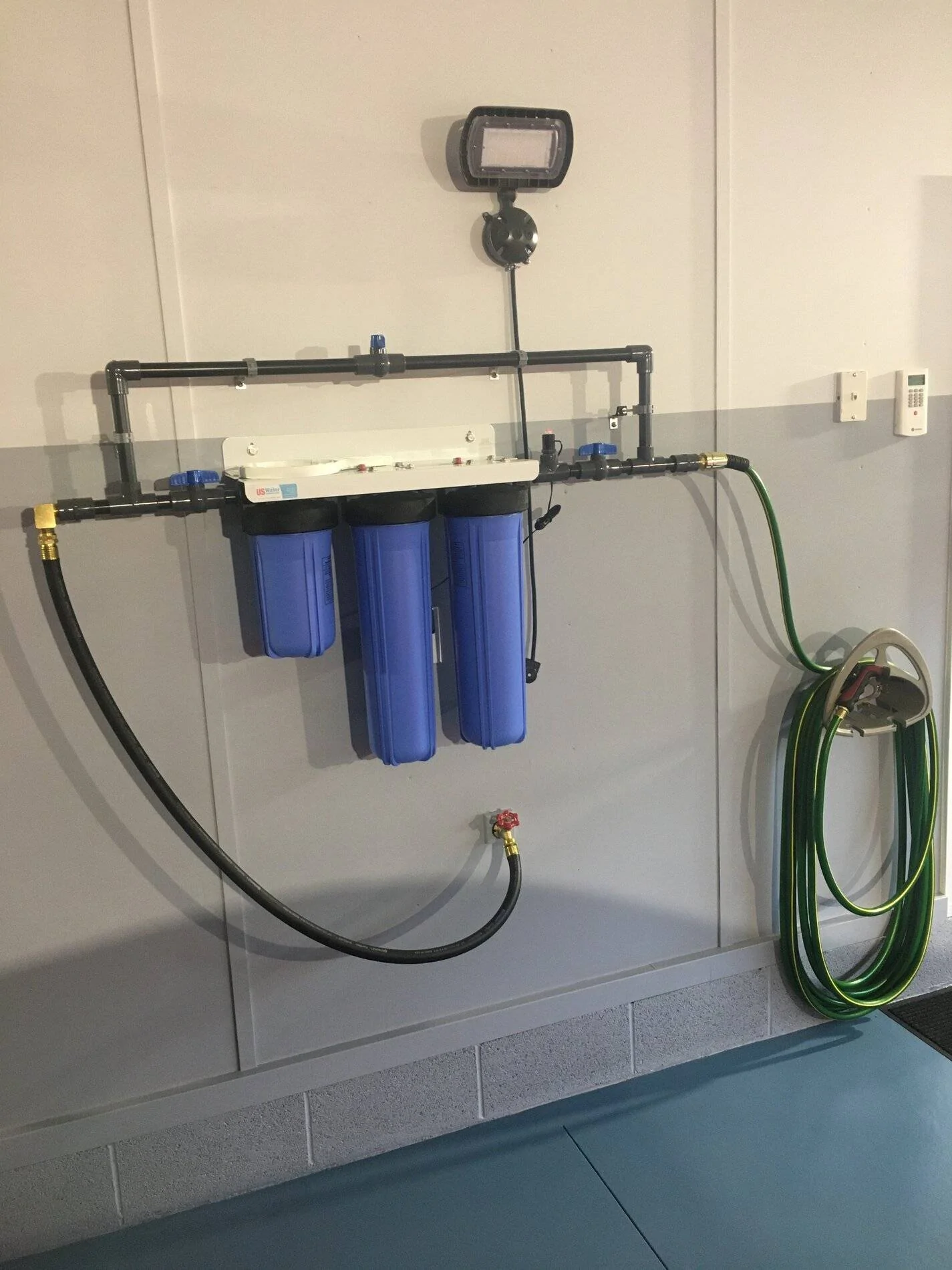

I'm no plumber, even though I may resemble one when bent over sometimes.......
I tapped into the spigot CPVC pipe that runs down the wall of my garage. I put a shut-off pre and post filter and bought a dedicated 75' soft flexible hose for rinsing. I wanted a soft hose just incase it hits the car as I rinse it. Whole kit and kabootle cost me $200.
I am just giving the glue a good couple of hours to completely dry before I turn the water back on, thats why I have not filled the canisters with the media yet. Well that and why let it sit there when I am a month away from using it.

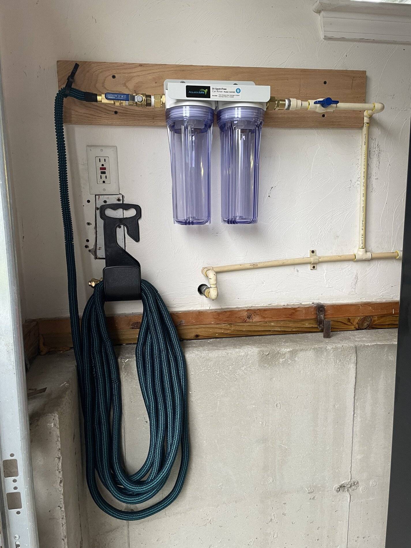

I just got my cr set up and the left canister is leaking like crazy, right one is fine. For the life of my can’t get it any tighter, could there be another reason for the leak?
Did you put the centering rings around the canister? Just spit-balling

I installed a US Water Systems unit with a bypass that I have been satisfied with.
What’s the smaller canister for? That’s a nice setup, all these cool thing I see are going into my “will have when I build my own house” book.

Thanks. The first one is a Carbon Pre-Filter and then it has two Mixed Bed DI Cartridges.
