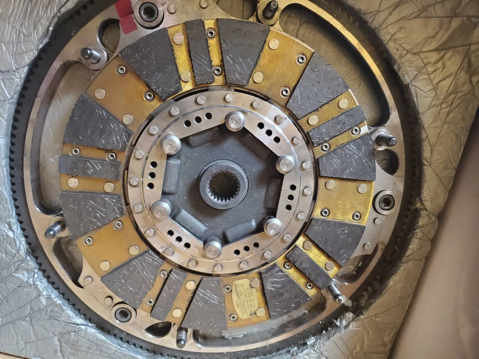

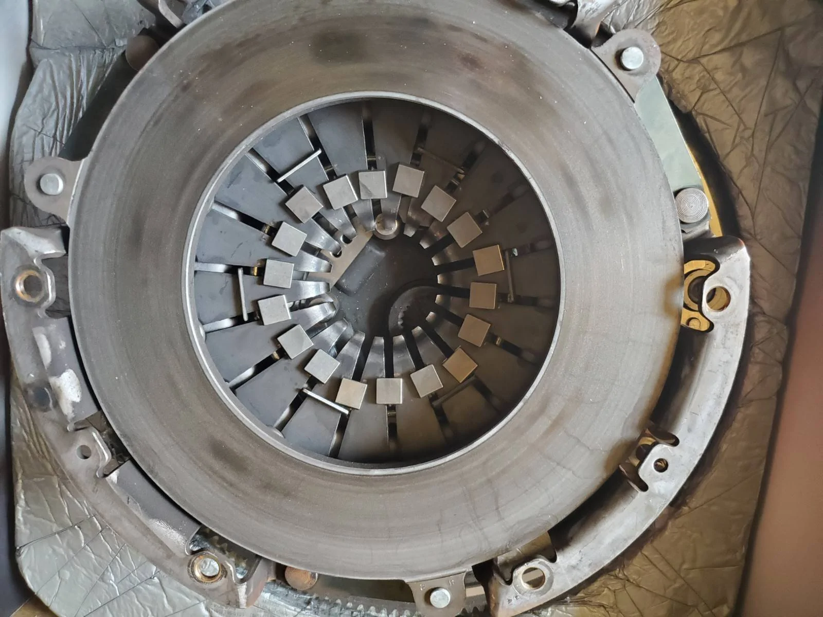

hi there, ok so I found a good deal on a used clutch... I know as soon as I say that everyone is gonna chime in about how that’s like finding a good deal on a used condom... I digress lol
I’m not sure how to know ifthe clutch is in good condition or not... I know there can be hot spots on the pressure plate and glazing on the clutch disc but there aren’t a lot of clear examples of these things online.

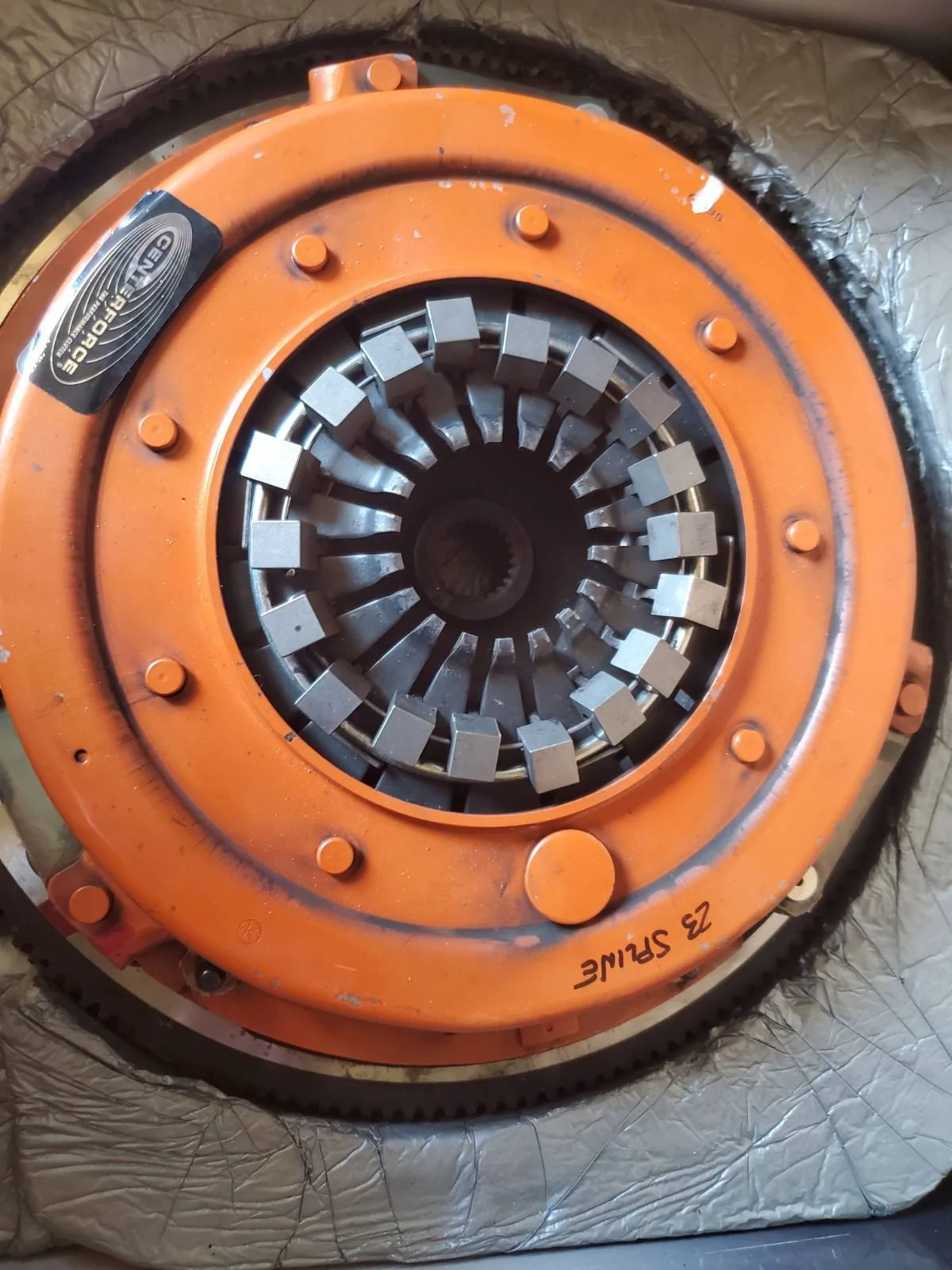

I attached a couple pictures of the clutch...anyone with any experience I would greatly appreciate your input!!
it looks to me like there might be a couple hot spots on the PP. it’s hard to tell from the angle of the picture but the clutch plate has a relative shine to it. Again, I don’t have enough experience to know how bad it really is.
thanks for your help!

I should add... it supposedly only has 500-600 miles on it.

If it only has 500 miles It should still be in the break in period, I wouldn't expect it to have hot spots already. Also need to see flywheel condition.

OK so those are hotspots that I’m seeing on the pressure plate then??
unfortunately I don’t have any pictures of the fly wheel… What should I be looking out for?

There should be no glazing of the clutch disk and no hot spots on the pp or flywheel at 500 miles. If there are signs of either, which there are, I personally wouldn't buy it because it means it wasn't broke in properly. It won't hold rated torque and will fail prematurely. At the price new Mcleod RST's are going for I would go that route. I would install an oem before that used centerforce even if it was free.

Thank you that is so helpful... looks like I’m gonna pass. Thanks!!

If it only has 500 mikes then if they followed the breakin procedure you should see very even wear on all friction pads, pressure plate and flywheel. From the pictures it appears to be uneven.
Questions I would ask are if this clutch was paired with a new flywheel or resurfaced?
I would also ask a trick question such as how did it hold on hard launches? If they answer with anything other than I do not know because i never finished breakin then i would walk away.
If you plan to install this yourself then have at it. Only loss in your time. If you are paying someone to install then figure in the potential of paying twice if it is indeed shot which more than covers saving up for a new one.
