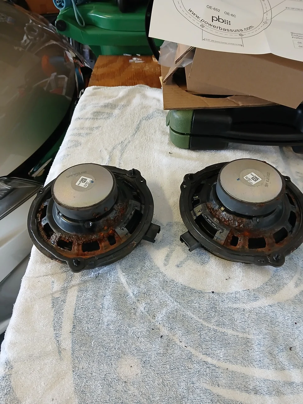

I replaced the door speakers last year after one of them died along with the sub in the trunk. I have the B&O system. Works great and was improvement over the stock speakers. Sourced everything from Crutchfield.

I put baffles on my door 6.5s...helps keep them dry.

How did they rust out so badly? Did you leave the windows down during a rain storm? How are the inner doors, do they show rust?
Never have the windows down. Trapped moisture is my guess. Car is kept outside under cover. More valuable cars are inside. If you ever look at your door sills after rain you can see moisture gets in

Yeah good to know. I'll keep an eye on mine. I had them out last year when I upgraded the 3.5" speakers and I pulled out the 6.5" to have a look and they were fine. I was planning on swapping them at a later date, but now I may move the time line up. I did notice that my car cover has lost some of it's water repellency. I may need to spray it with some silicone spray.

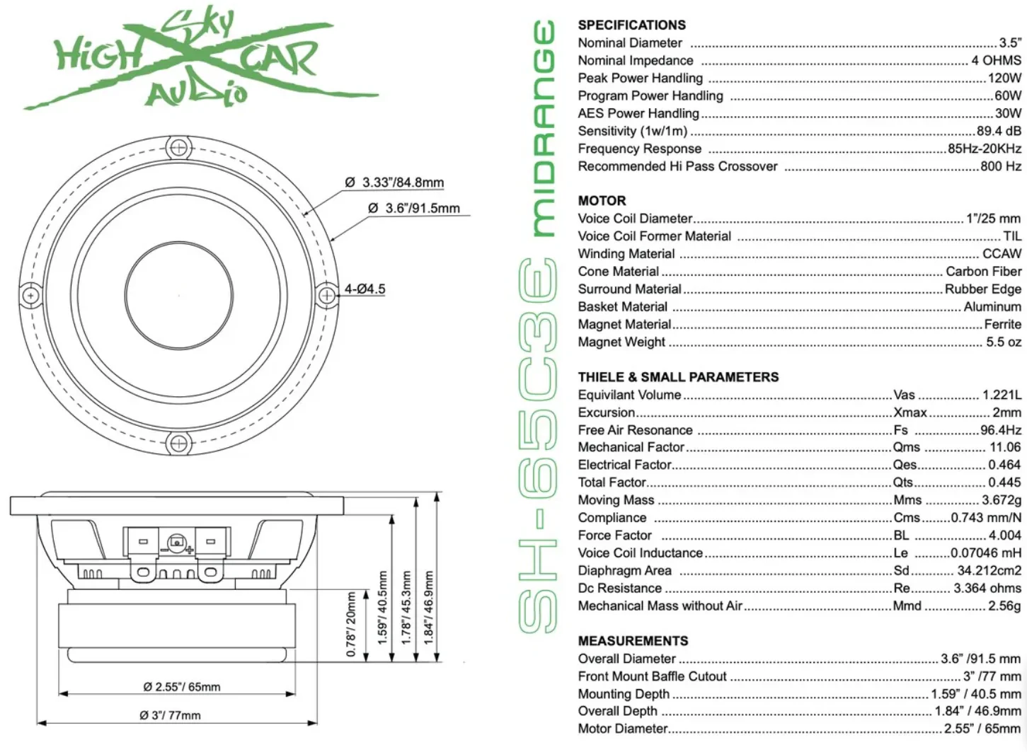

What did you replace the 3.5" ones with? I did the 6.5" power base from crutchfield. But didn't see any good 3.5" options.

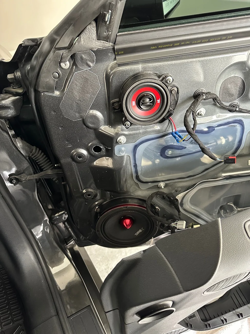

I did a write up on using these. But the jest is to reuse the factory mounting ring. I got it to fit rather nicely. I reused the factor speaker connector as well. Don't overheat the pins the plastic is real soft. Crossover at 800hz use a 47uF capacitor. The vocals are nice and clear and guitars sound awesome.
https://skyhighcaraudio.com/sky-high-car-audio-sh-35fe-3-5-loudspeaker-with-carbon-fiber-cone-pair/

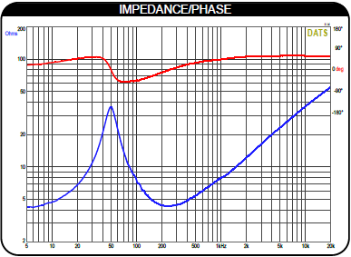

Don't get hung up on the ohms. You have to know how to read the speaker's dB rating. The dB rating tells you how loud it will play for a input voltage of 2.83V at a distance of 1 meter, the accepted specification. So if you do some Ohms law you will see that the 2 ohm speaker will need twice the amount of power to achieve the same dB level as a 4 ohm. Also, and this is a biggie, the ohms of a speaker is not constant with frequency. See blue line in the graph below. It's only 4 ohms in 2 spots, one of which the speaker will never reach.

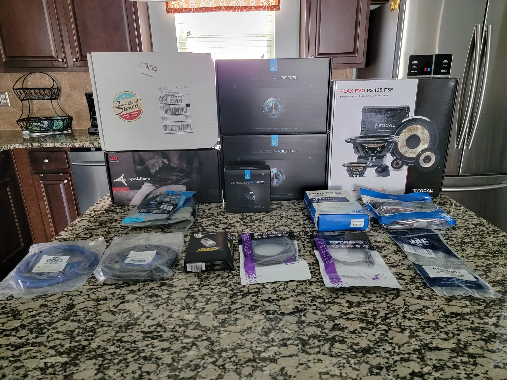

The box labeled Sounds Good Stereo contains adapters that are made for a simple install of the Focal Mids (any aftermarket mids). No other adapters were needed.
Did you do the install yet? Any issues with fitting rhe Focals?
